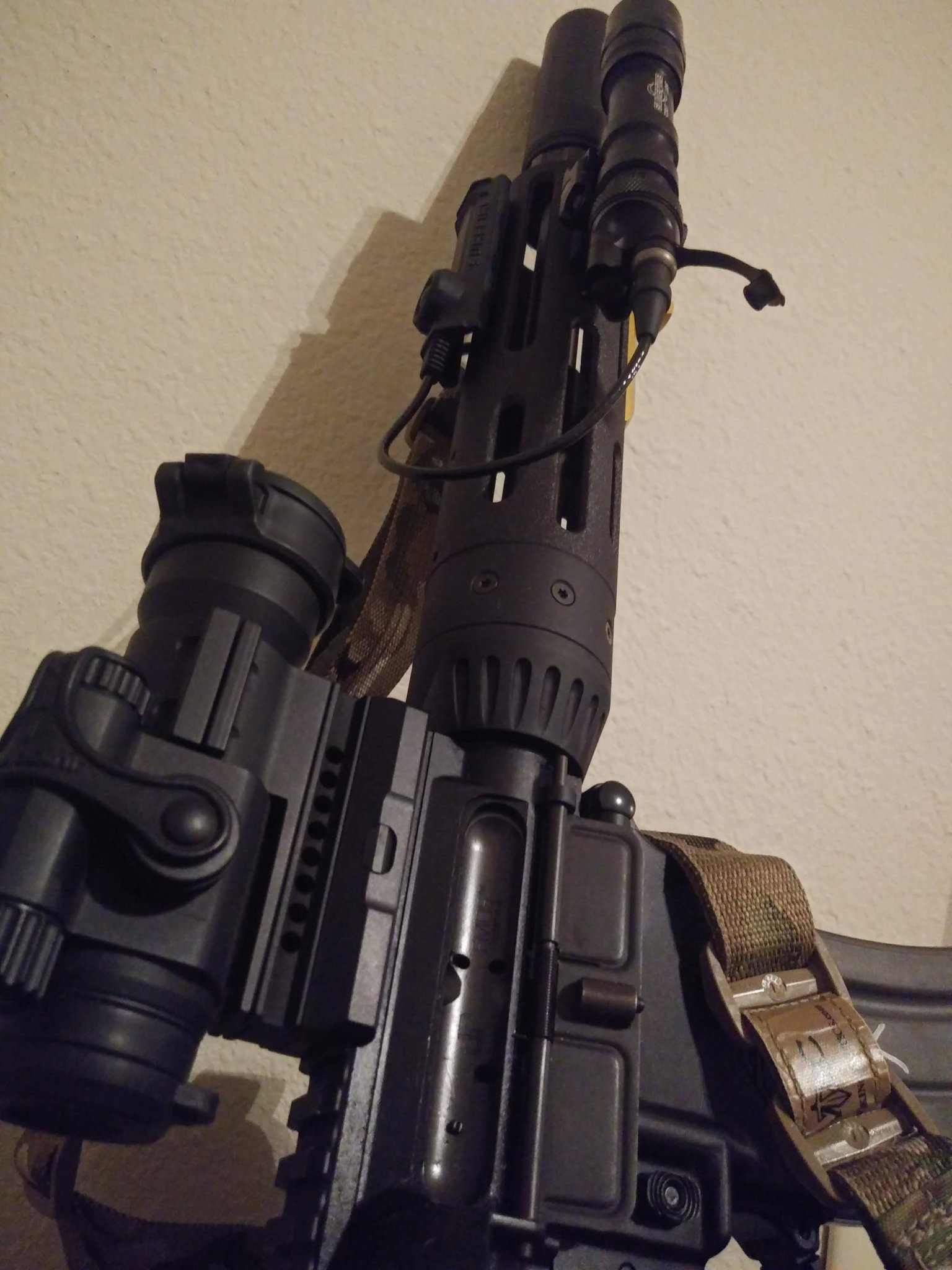

My build uses a JP FMOS carrier and standard SCS with a 10.5" pistol gas barrel. Cycles supers and subs both unsuppressed and with a Dead Air Sandman K suppressor. Definitely one of my favorites!
