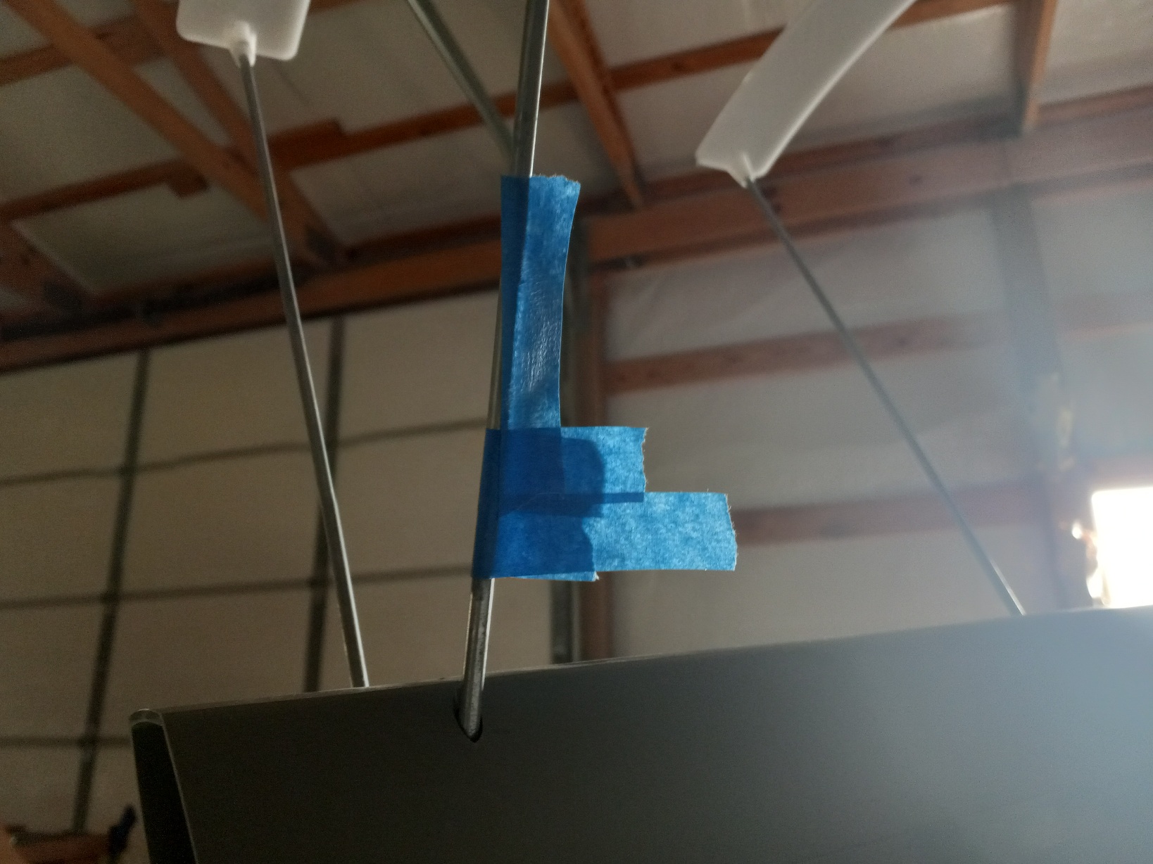

I have a ProChrono LTD. It might be just old enough to be outside the two year warranty.
Ran great. I am more concerned with ES and SD for load development, and the readings were very consistent. True accuracy wasn't off by by much when I plugged the velocity in and shot at distance. I don't ever remember being off by more than .1 mil.
Direct sunlight is your enemy. I found that running masking tape on the rods that hold the diffusers to block direct sunlight prevented error or wild readings.
Changed the battery not long ago, it lasted a while.
Last two times out though, I can't get it to take a frigging reading at all. Maybe the 9V I put in it was a POS? Going to have to go out and buy some new ones and give that a try. Right now everything works perfectly...until you put a round over it and it stays at "0".
How exactly did you put the tape?
Reactions: J. W.
Literally stuck it on the outside of the metal rod in a couple layers. Maybe a 3" wide by 3" tall piece...just enough to get a shadow over the window for the sensor. Nothing in the inside of the triangle where the rounds fly. Worked like a charm. Won't last in high winds though.
During the summer months I stuck a 'high speed internet' advertisement road sign (similar to a political candidate sign) that some a-hole stuck in my property over the top of the diffusers. The shadow was enough to cover the sensor windows, and it too worked like a charm. The sun's position in the winter though is too far south for that to work.
Keeping direct sunlight off of the sensors, I might get an error or wild (400 FPS off) reading once every 25-30 shots. Put my ProChrono in direct sunlight though and it would happen about every 5th shot.
Sorry for the shit photo, trying not to show what's in the shop. I realized my explanation earlier might not be as clear to others as it is to me.
This is how I make my ghetto-ass sun shade...unfortunately a piece of tape has fallen off. I am just trying to provide shade for the window/sensor without putting anything where it might compromise a reading. It works for me.
