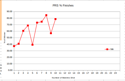

I'm a data wonk, so here is some proof that -practice- matters a bunch more than the gun initially.
Clearly you can get to be a 80% shooter with an RPR, if you're not there yet, practice more. A couple more matches this year, hopefully I'll continue improving.
This is my % finish versus open winner at 2 day national matches since I started.
Its basically up and to the right aside from 2 matches, both of which I had scope mechanical problems.
I've since "fixed the problem" permanently ;)
