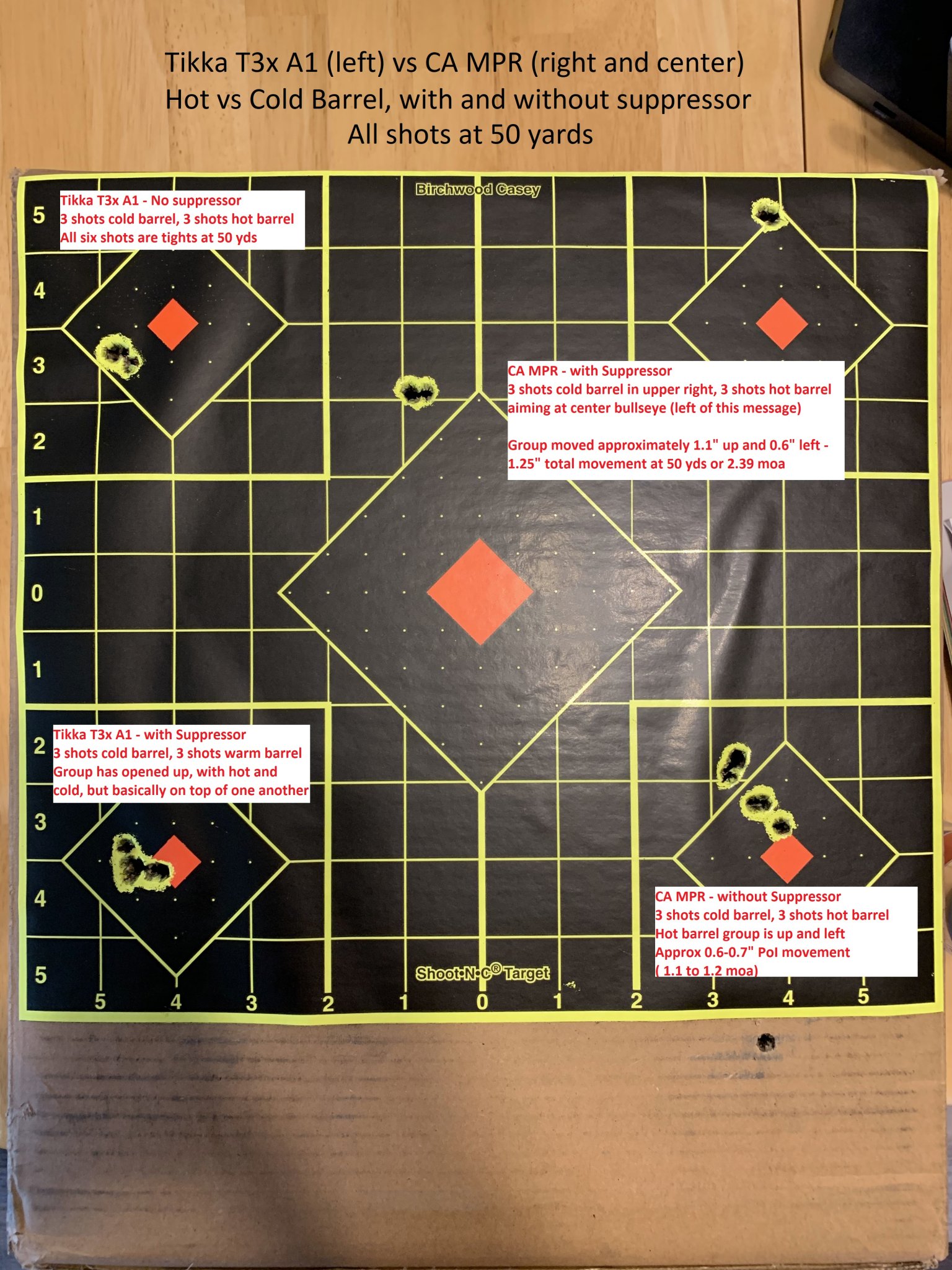

Just ran the test again with a Tikka T3x A1 (24" x 13/16" diameter steel barrel), also in 6.5 CM, to compare to the Christensen Arms MPR. The Tikka maintained PoI hot or cold, with the only observation being that the groups opened up with the suppressor.
Interestingly enough, the CA MPR PoI moved significantly from cold to hot barrel, with and without a suppressor. However, the suppressor did seem to magnify the PoI movement of the hot barrel. The CA MPR with suppressor moved 2.39 moa from cold barrel to hot barrel
Interestingly enough, for reasons I cannot explain the CA MPR "cold to hot" PoI drift was up and left during this test, rather than down and left that was observed while testing last weekend.
Graphic of test below:
