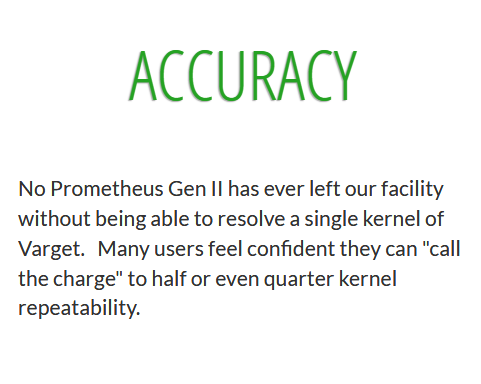

So I’ve watched a few videos of folks using these guys and I’ve always wondered how they worked / operated. I read a bit about them on the website too but my ultimate question is given the advent of much more sophisticated systems what’s the upside of these if any… they also don’t seem to be massed produced in anyway and only for lease which feels like a pretty poor business model. Anyway, does anyone still use them and if so what are your thoughts how they stack up?
Believe it's still the best powder measure. Could be wrong! I know there are other items out there that are good. Maybe someone that has one. Will chime in, and elaborate on it.
Believe accuracy. Don't have have one. I know a few people, that if they had the chance to get one they wouldn't hesitate.
Ok so im not trying to be mean but I hate it when people say shit like that. What does that even mean, “believe accuracy?” The accuracy of the balance would need to be verified w a known weight and certified to a certain level of tolerance. That tolerance and resolution / sensitivity of the balance is what I want to know. And ultimately how does it stand up to a more modern lab grade balances. In a lab we use the same balances as the reloading community not physical beam balances like the one used in the Prometheus.

Accuracy it is! Like I said I don't have one. Thanks @Haney for that.

It’s a gram balance scale, so it doesn’t do, say, “+/- .02 grains.” That said, you can absolutely, positively differentiate one kernel of varget. If it happens to stop trickling before reaching your desired charge, you push a button and it trickles one kernel. The reason it stopped short was because the charge it weighed was the weight equivalent of less than one kernel (weight of varget at least) from the weight you set it for, if it trickled one more it would be over the weight.
