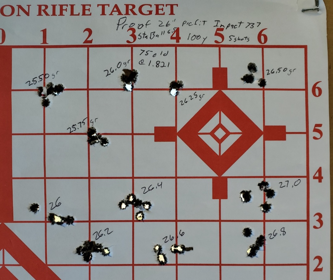

sweet was thinking about those eld rounds for a trainer and double duty for coyotes. What size groups were you getting with the 75 grain rounds

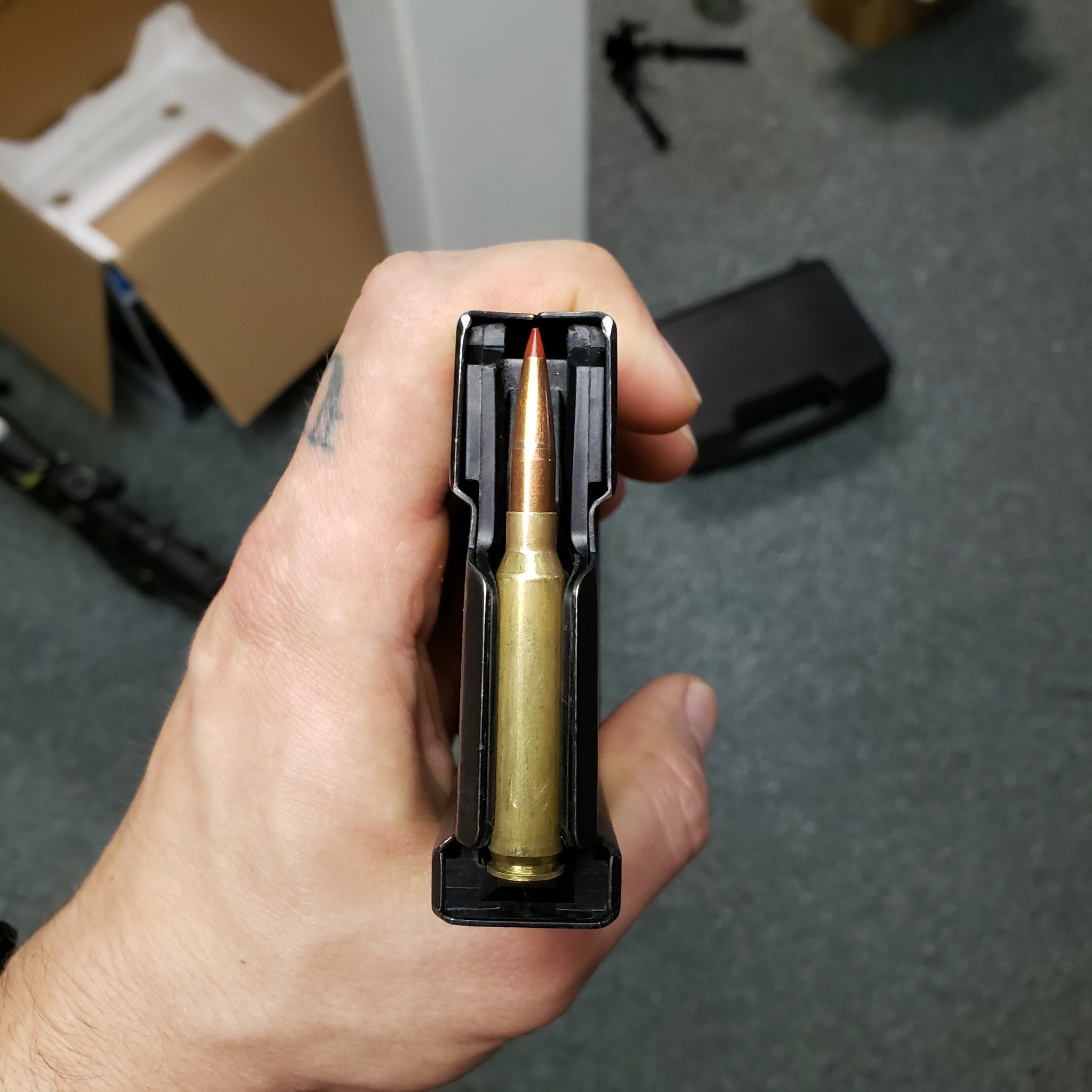

my proof has seen a diet of 55fmj for break in and then a light load of 62 bthp's for 100 yard barricade practice and 75 ELD's loaded to jump .035" for long range practice. zero issues feeding... that said I have had issues with snap caps feeding with polymer mdt's, the live rounds have been fine though.
Hey so what mags are you running with the 75 ELD's. Did you have a problem with MAX COAL. What did you net out of COAL
