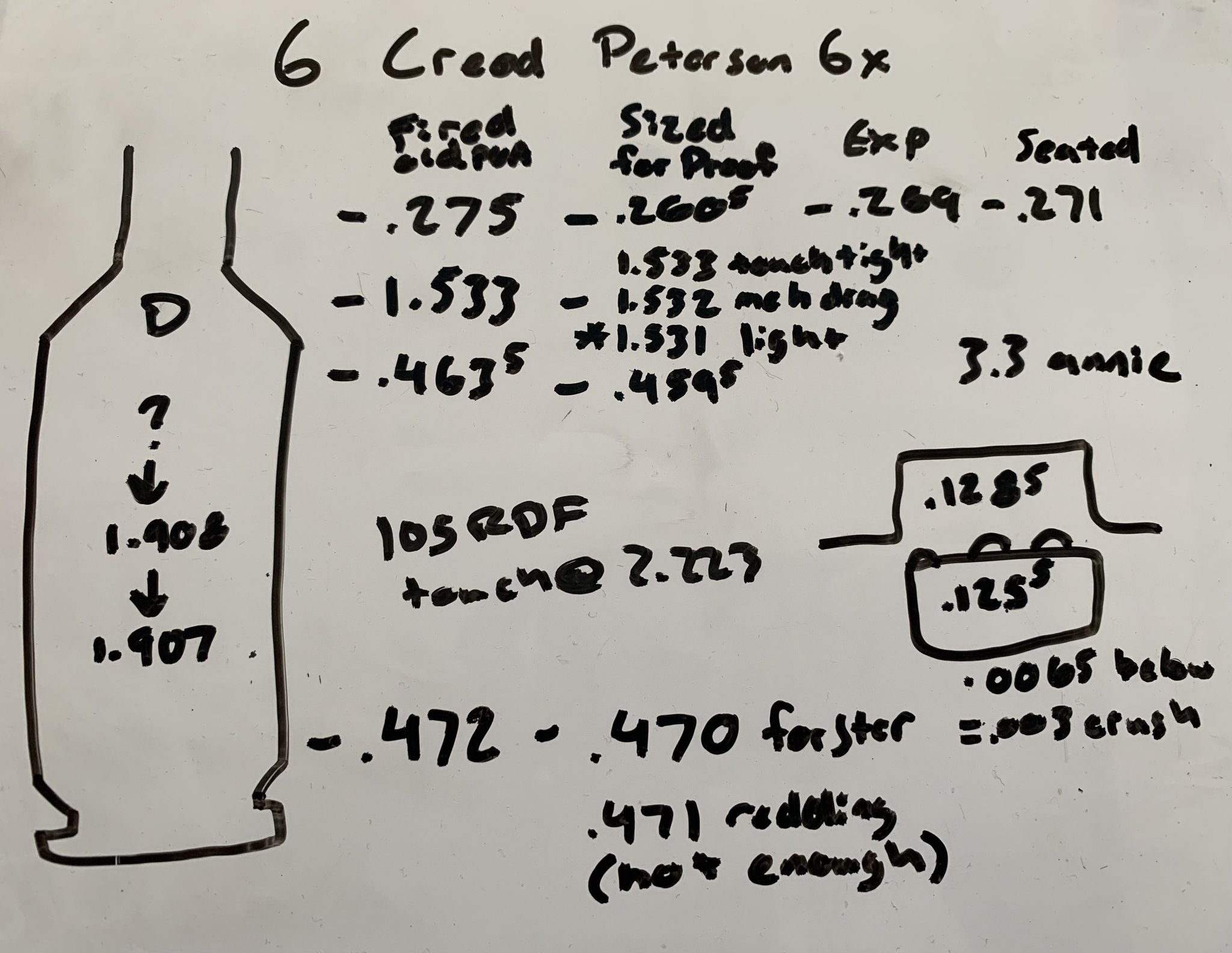

Had the issue using old 6 creed brass that was sized with a Redding bushing die in a proof barrel, a forester die sized the base an extra thou and it works fine now.
