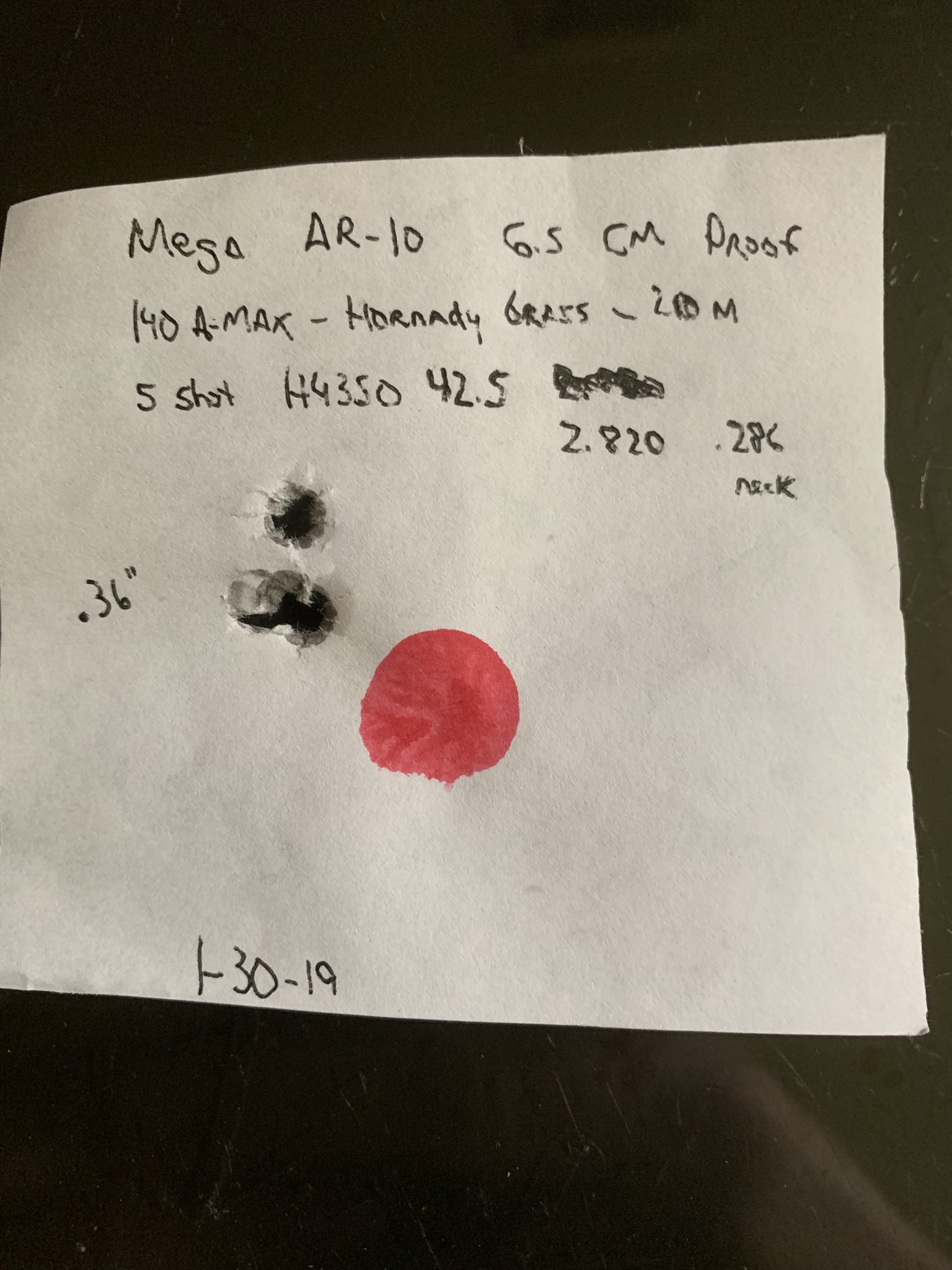

I have owned over 15 large frame precision AR’s and closer to 30 small frame precision AR platforms in the past 15 years.
I have had three Proof barrels on AR platforms and they all were outstanding. I’ve owned two in 6.5 CM and one in 6.5 Grendel and they all hold amazing accuracy out to 600m+. I have one new Proof 5.56 Wylde 1/8 barrel that I will try to shoot in the next few weeks and I’m excited to see what it does.
Both Proof barrels like the cheap Hornady American Gunner 140 Match Ammo and shoots it around 3/4 MOA or better!
I also hand load for my Mega AR10 6.5 CM and it’s a hammer out to 800m and have seriously out shot guys that are running 6.5 CM bolt guns.
I don’t really shoot paper but I generally like to start my LR shooting on paper to confirm my zero.
Here is a group I shot a few months ago although this is a cherry picked group I really feel I could do a 5x5 and it not shoot over 3/4 and hopefully average 1/2 to 5/8.
What most guys don’t realize is that shooting a large frame gas gun is like trying to get on a wild Mustang and riding off into the sunset. They will challenge some of the best shooters and they all seem to need to be held a little different.
I’ve seen guys cuss their $6k KAC stating they don’t shoot under 1.5 MOA and then a experienced shooter gets behind it and shrink it down to 3/4.
