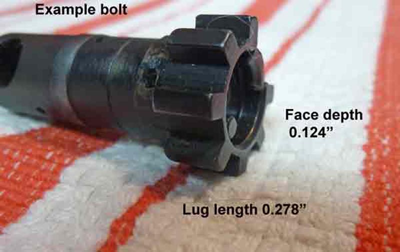

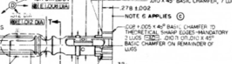

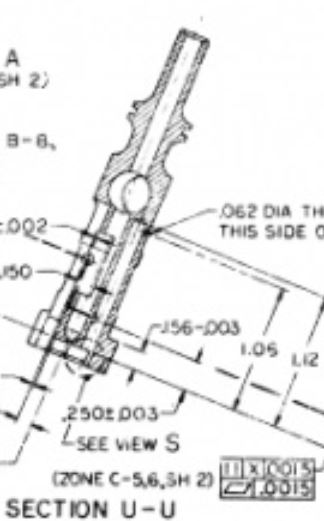

I guess I've been lucky. All my AR-15 bolts (5.56 and 6.8 types) meet drawing.
Typical of my bolts.
What are the measurements on the JP bolt? or a Rubber City bolt?
Are my bolts OK @ 0.278 - 0.124 ?

The Mil-Spec allows 0.156" down to 0.153" from the rear of the lug (contact with extension) to the bolt face.
0.156" gives a tighter headspace than the other end of the tolerance 0.153".
An in spec bolt would give a range of 0.003". I imagine that high quality bolts will be held to a much tighter tolerance.
Would that be 0.156" to 0.155" or 0.155" to 0.154" or maybe 0.154" to 0.153"?
How about 0.154" +/- a half thou? (Tighter than Mil-Spec).
