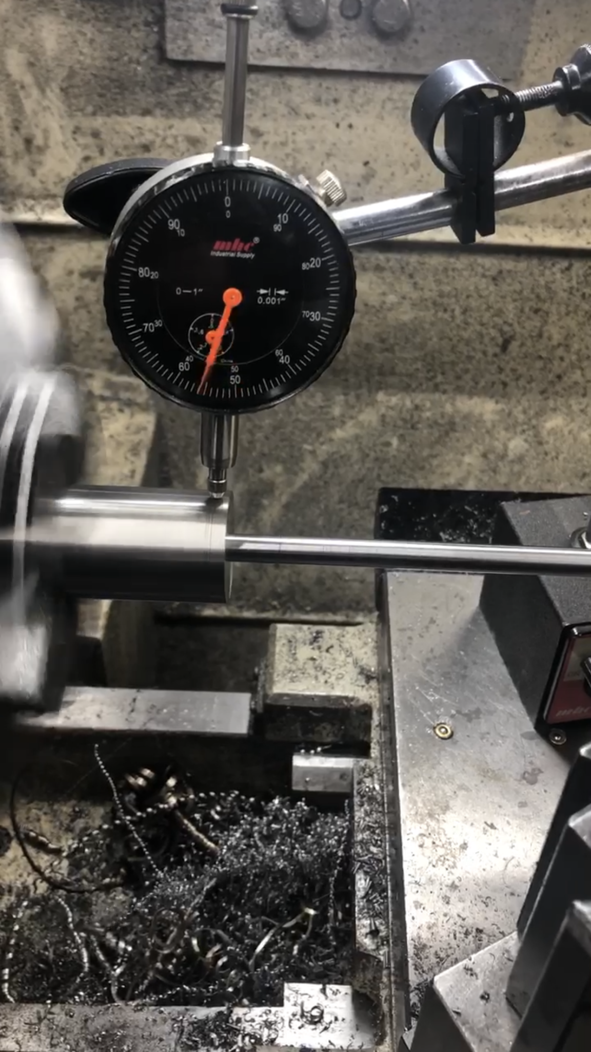

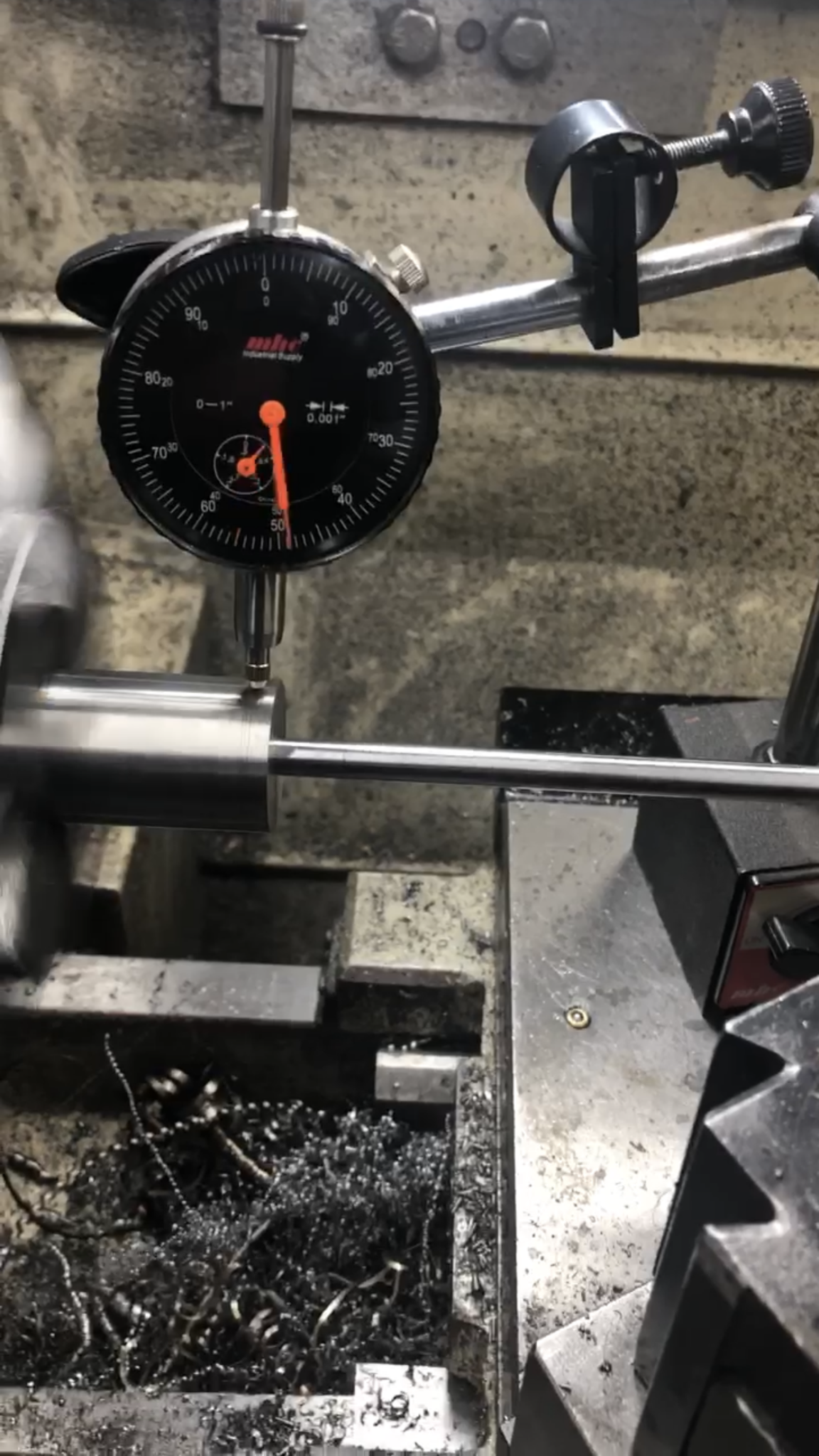

My smith just sent me a video of the proof barrel I’m using on my 300 wm build. He was spinning it in his lathe and it appears it is bored around .008 off on the dial indicator. He said its the second Proof in a row from stockys to be bored off center. He didn’t seem very concerned abt it but is that pretty common?

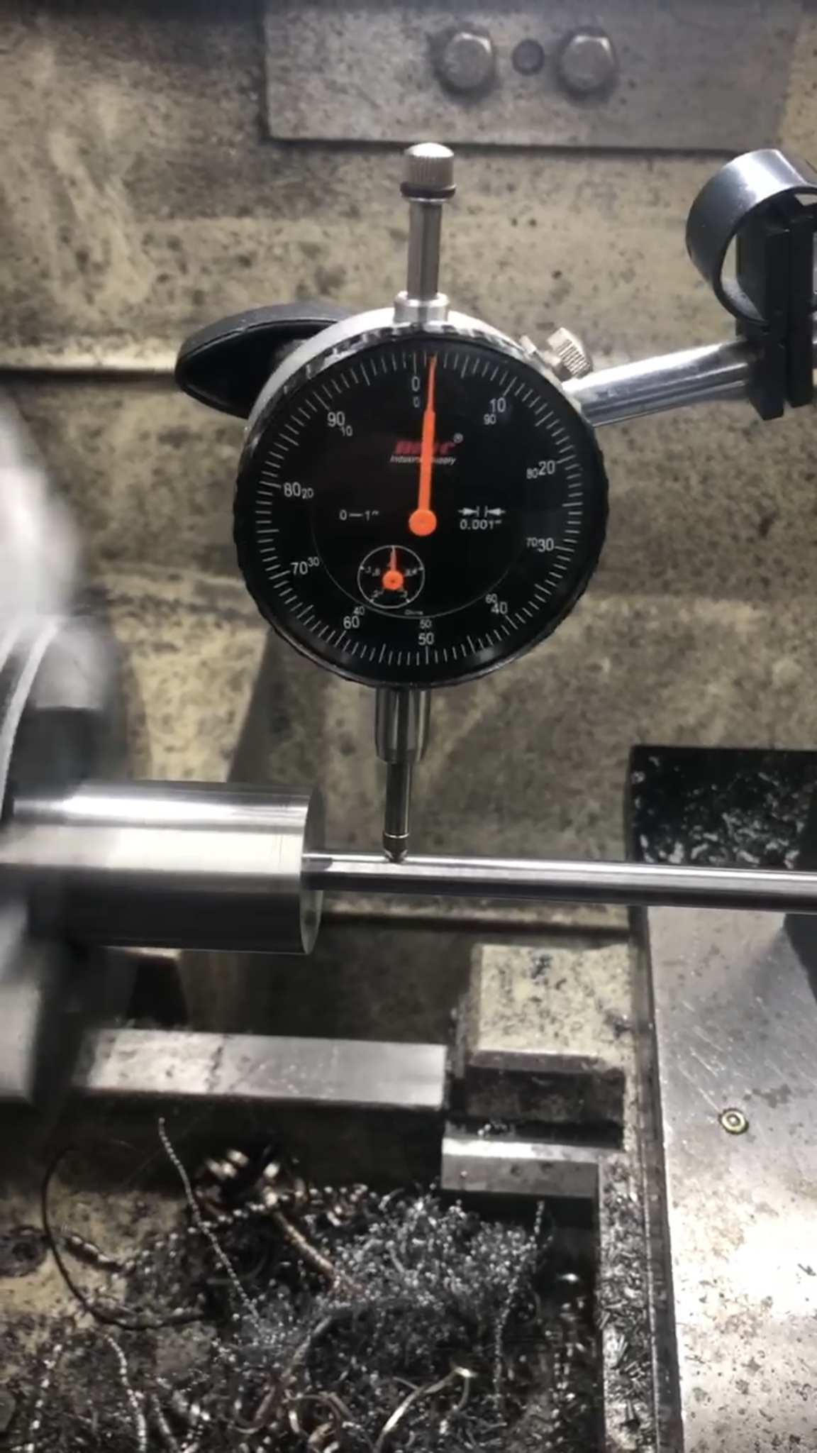

The other two are on the barrel. There was little to no deflection on the dial indicator on the range rod. It is taking so long to upload pics today. I just uploaded the one on the range rod.
I think what he's getting at is that the bore starts off-center of the blank. I'm guessing what he's trying to show in the pics is that the range rod is dialed in and when you indicate the outside of the blank it runs out .008". I assume the run out most of you are referring to would be of the bore over the length of the blank. .008" off center at the beginning of the breach is quite a bit. Chambered a few like that and it was not an issue on target.

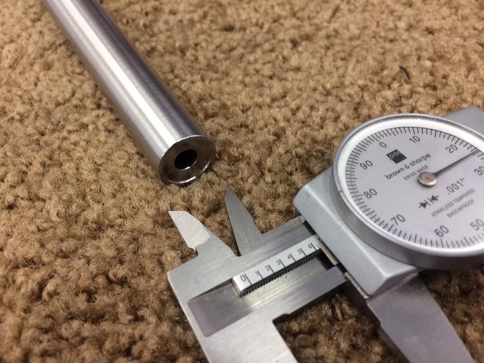

The Smith is pointing out something most can verify at home with cheap calipers.
Measure the thickness of the muzzle in 4 positions ~ 90 degrees apart making sure you are in a groove.
Most would think the profiling process corrects this like it did in the past but today they use blanks closer to the finished diameter.

I believe that when a barrel manufacturer processes a steel/stainles barrel, he will first gundrill a blank (straight cylinder) to the rough bore dimensions. Then he either cut rifles or button rifles the lands/grooves in the bore. After that, he may or may not lap the barrel, but, he does go on to cut the countour of the barrel. When he cuts the contour, it is common to use a dead center on a backing plate with a dog holding the barrel in place, on the dead center/backing plate. This is done at the headstock of the lathe and the tailstock uses a live center, both ends (live center and dead centers) being inserted into the bore. After cutting the contour with a cutting bit in the lathe, the contour is also belt sanded to remove the tooling marks. It is very possible that the sanding of the exterior of the contoured blank introduces the diametrical errors that the OP's 'Smith observed. With that in mind, I believe it is more correct to say that the contour is not concentric to the bore, not the other way around.
Whenever I thread/chamber a barrel, I always dial in the bore with range rods and .0001" resolution Mitutoyo dial indicators, one on each end. I fix the barrel through the spindle/headstock. I use a 4 jaw chuck in the headstock and a 4 point spider in the outboard (left) side of the headstock/spindle. It takes time to dial in, but I can get concentricity to .0002" to .0003" TIR. I also locate the "high spot" (thickest part) of the muzzle and index it to the bottom (6 O'Clock) position when I cut the threads for the trunion. In doing so, I have isolated the incosistency to the vertical axis, where I can simply dial in more or less elevation on the finished product to compensate. The last place I want that incosistency is at the 3:00 or 9:00 O'clock position(s). If the error is in the 3:00 or 9:00 O'clock position, the more windage correction is required as the target distance increases.
I think there is a common mis-conception that the barrel blank is contoured first, then is drilled/bored. I tend to think that errors much larger than .008" would be very common if the blank was contoured first, then bored/gundrilled. If you think about it, as long as both ends of the bore were prepped such that the live/dead centers were perfectly aligned in the center of the bore (perfectly concentric), the contour could be cut such that the OD of the countoured blank would be perfectly concentric with the OD of the bore.
Personally, I don't get concerned about .002" or .003" of variation of bore to OD of contour. I just index the thick part of the muzzle to the 6:00 O'clock position. Seems to work just fine. What IS most important to me is that the Bore is Straight (unto itself). I really don't care about the bore's relationship to the contour, unless it's ridiculously out of whack.
That is correct. That’s is what he is showing me. He hasn’t checked the other end yet, or hadn’t earlier when I talked to him. He has built 1000s of guns and several for me. I trust his opinion on it. I was just curious if a lot of you guys had seen the same thing.

.0080" TIR Means it's out .0040" The thickness of a sheet of paper. No big deal as we work on the inside. I did a Boots Obermeyer barrel once that was unturned . It just like it had come from the steel mill. My customer wanted to leave it full size and install a muzzle break. It was out over .070" at the muzzle. I did all the chamber and muzzle work. Then to blend the break in I had to dial in the OD of the blank. That was on a 32" blank. Looked very odd when you took the break off.

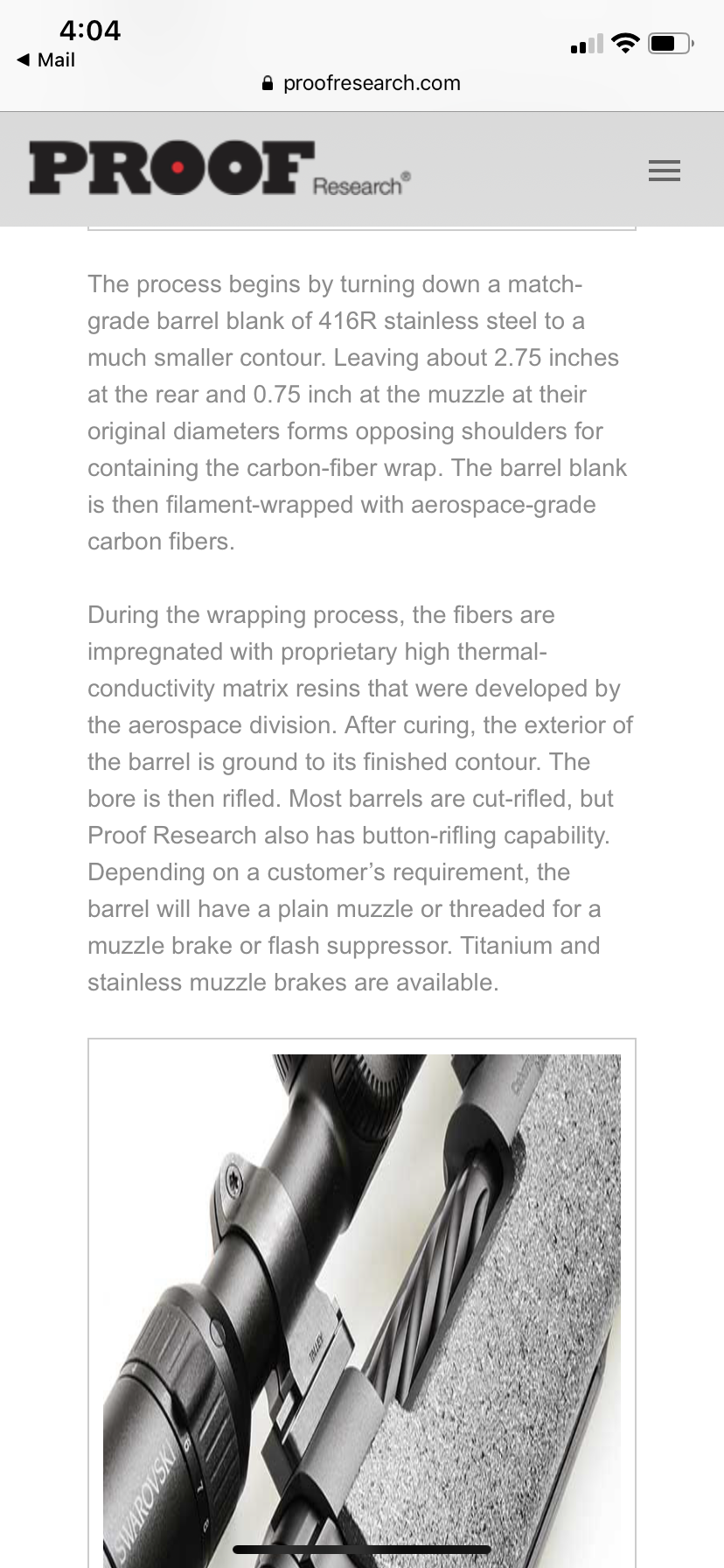

This seems like a good place to ask a question about these CF barrels. Does anybody know the process Proof or Christensen uses for wrapping the barrels. I would assume drill, rifle, contour and then wrap. I've always been told to not flute a button rifled barrel by a button rifle manufacturer himself. Assuming this is true wouldn't cut rifle barrel only be the logical choice and why in the hell would a manufacturer use a button rifled barrel to wrap in CF ?
I have seen many proof barrels spun up and never an issue. It seems odd to me to have 2 in a run, but I guess it is possible. I would say it’s smith error.
"Assuming this is true wouldn't cut rifle barrel only be the logical choice and why in the hell would a manufacturer use a button rifled barrel to wrap in CF ? "
So you wouldn't turn a sporter weight conture on a button rifled blank either??
  • Proof CF barrels are contoured and then wrapped before rifling. It appears it goes drill,contour,wrap,rifle.
  • Correction* rifling before wrapping.
  • They are cut rifled
  • Even cut rifles manufacturers (Krieger) say not to flute their cut rifled barrels.
Reactions: t_brooks
I will watch the video, may even call proof. My information was from this.
Re-edit
Ok, watched the video... says they rifle before wrapping and after contour. Interesting
