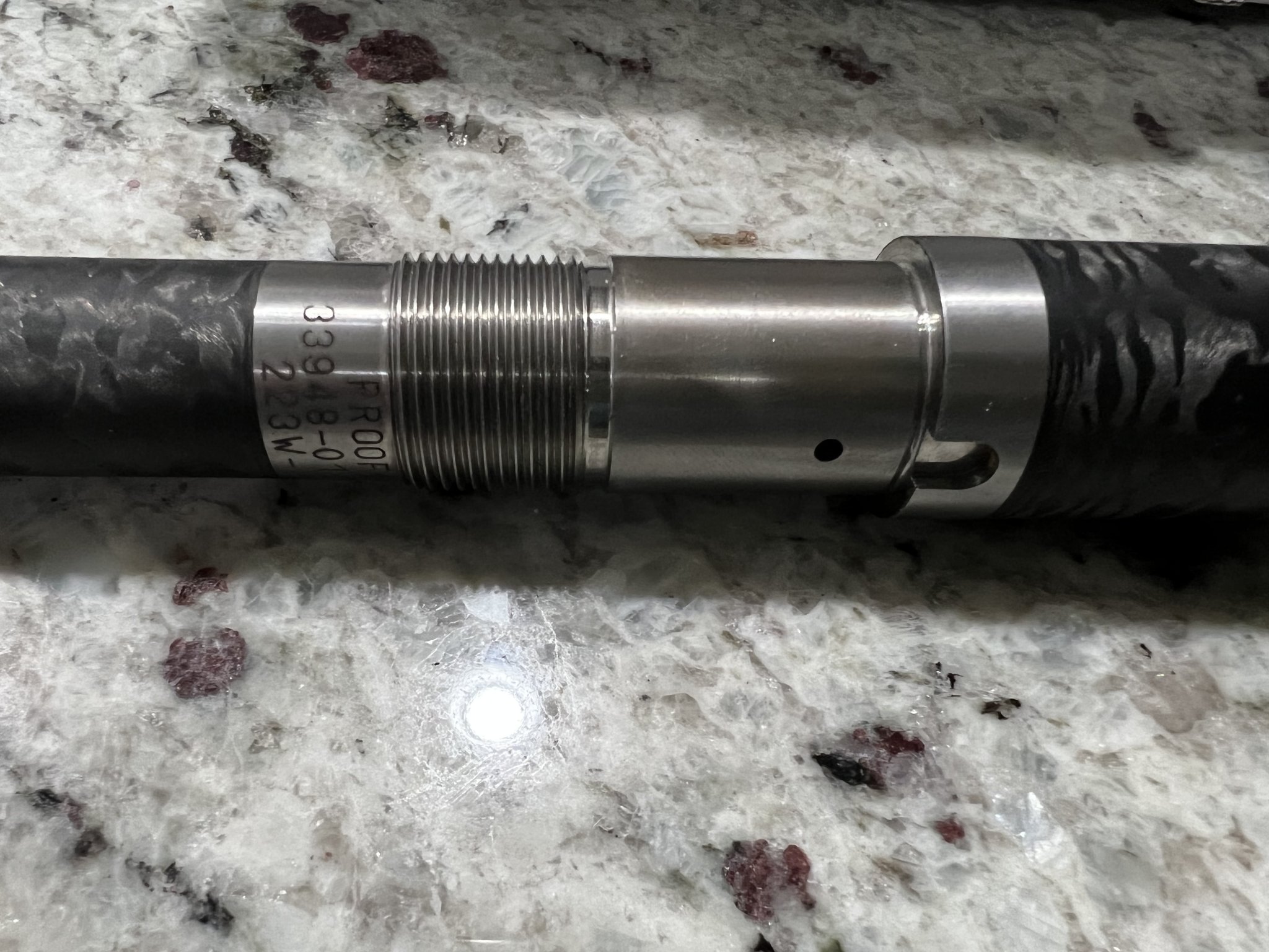

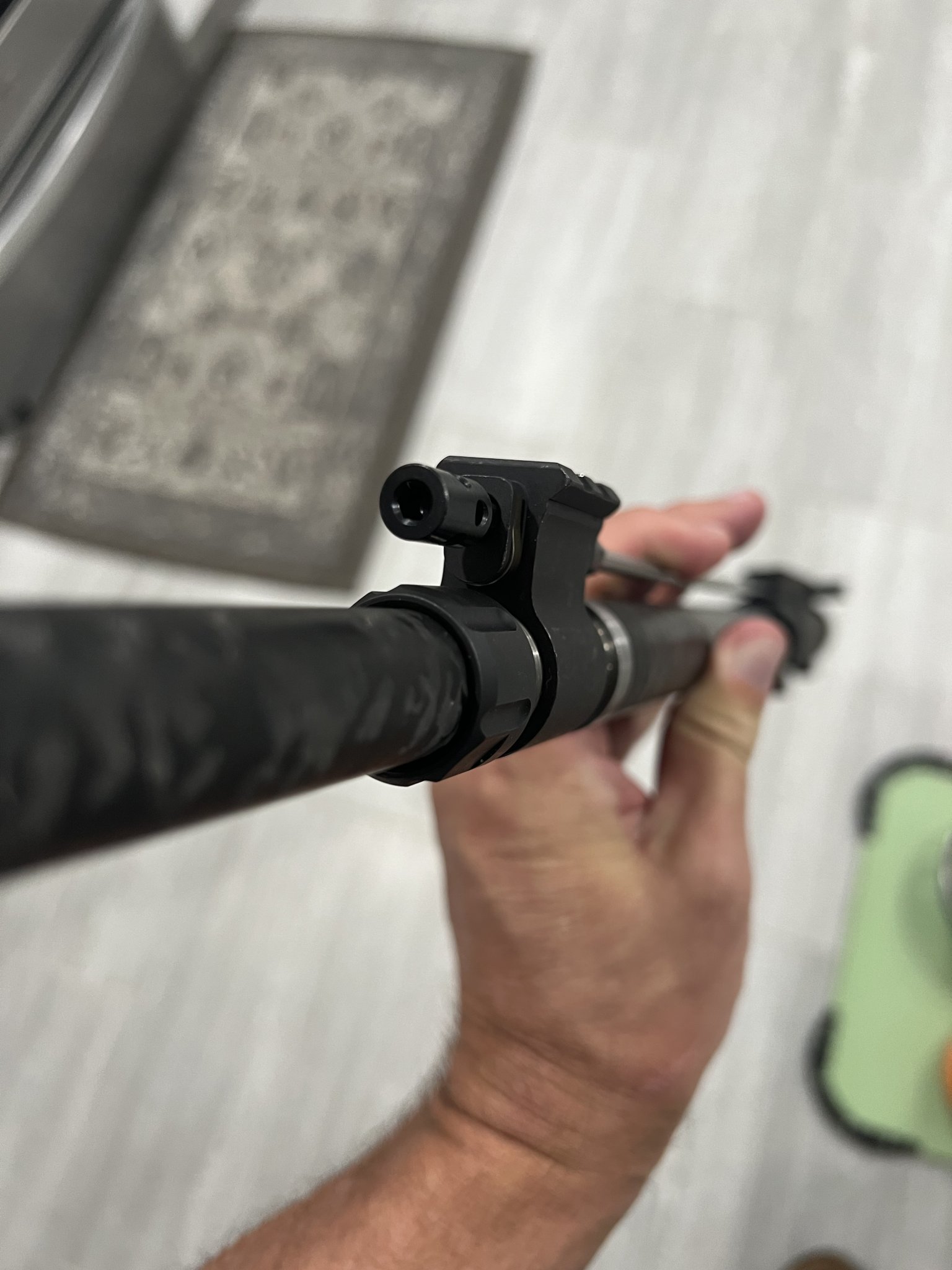

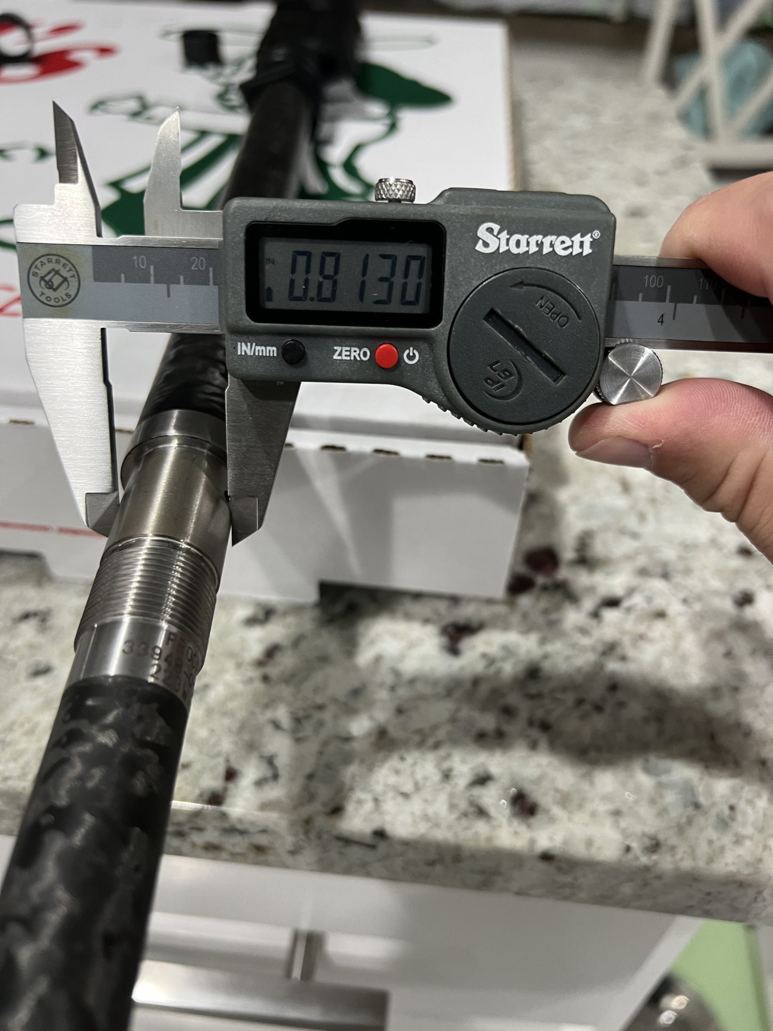

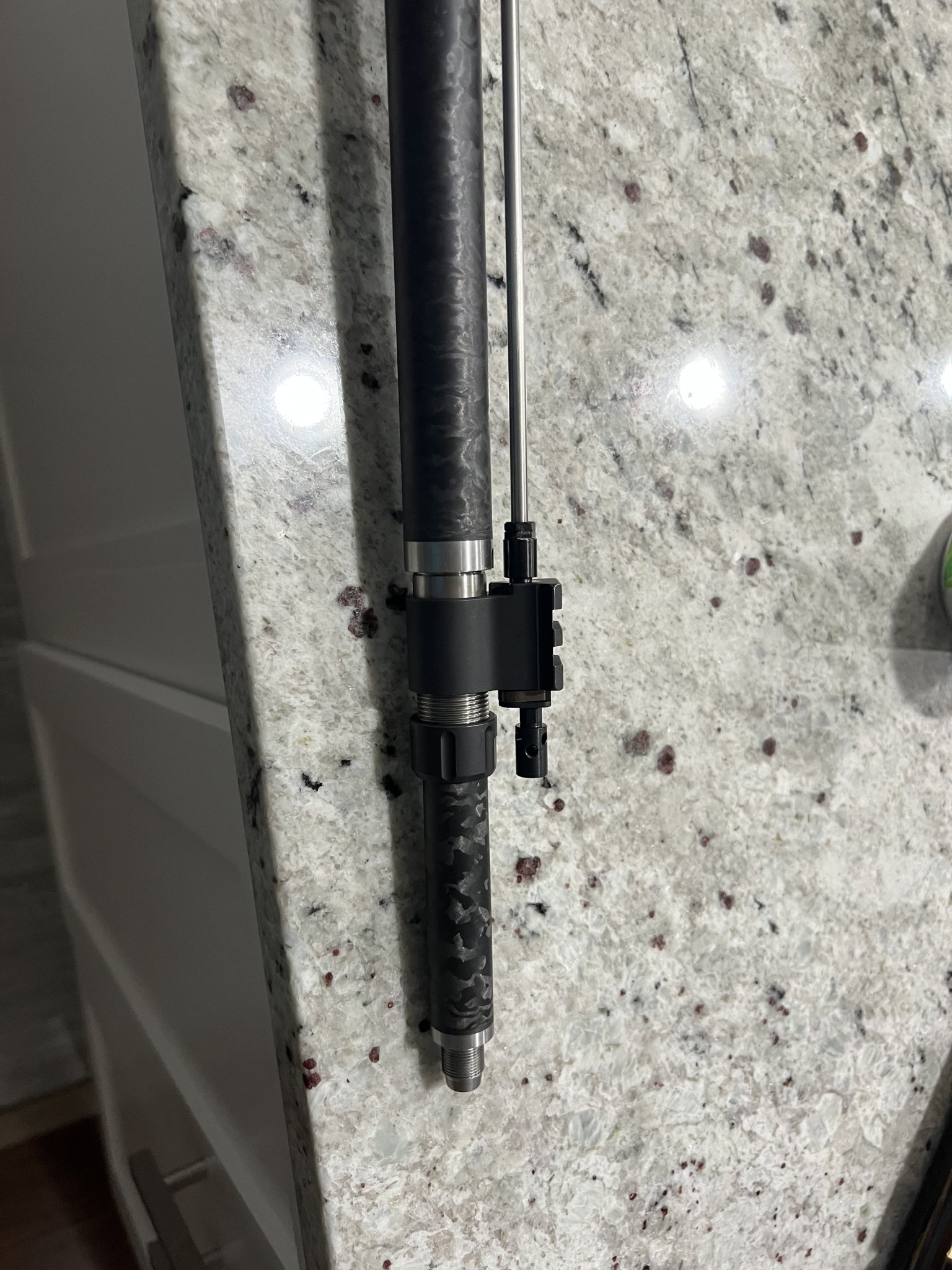

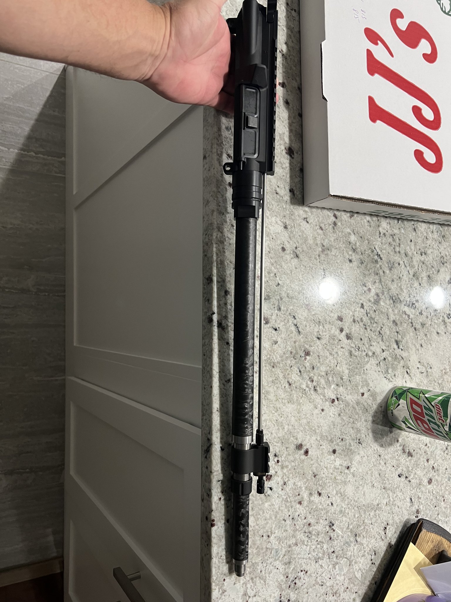

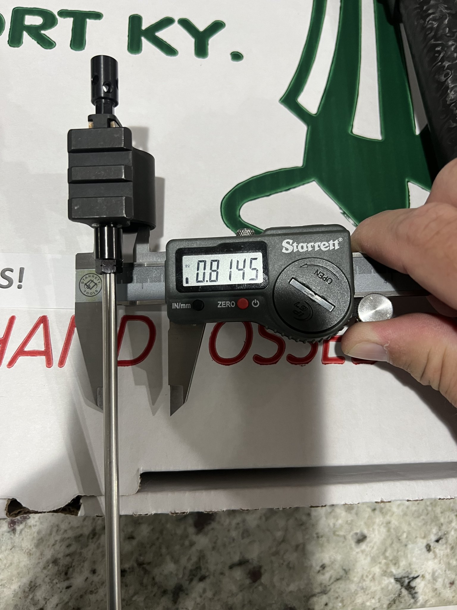

anyone ever seen a proof barrel with a .815 gas block that is held on by a threaded nut? I bought a barrel from Stocky's stocks and it came with a gas block and tube. The block is huge and wont fit under my handguard. I would like to change all that but i cannot find any info. The gas tube is only 13" also. I will call proof Monday but was wondering if anyone had any insight

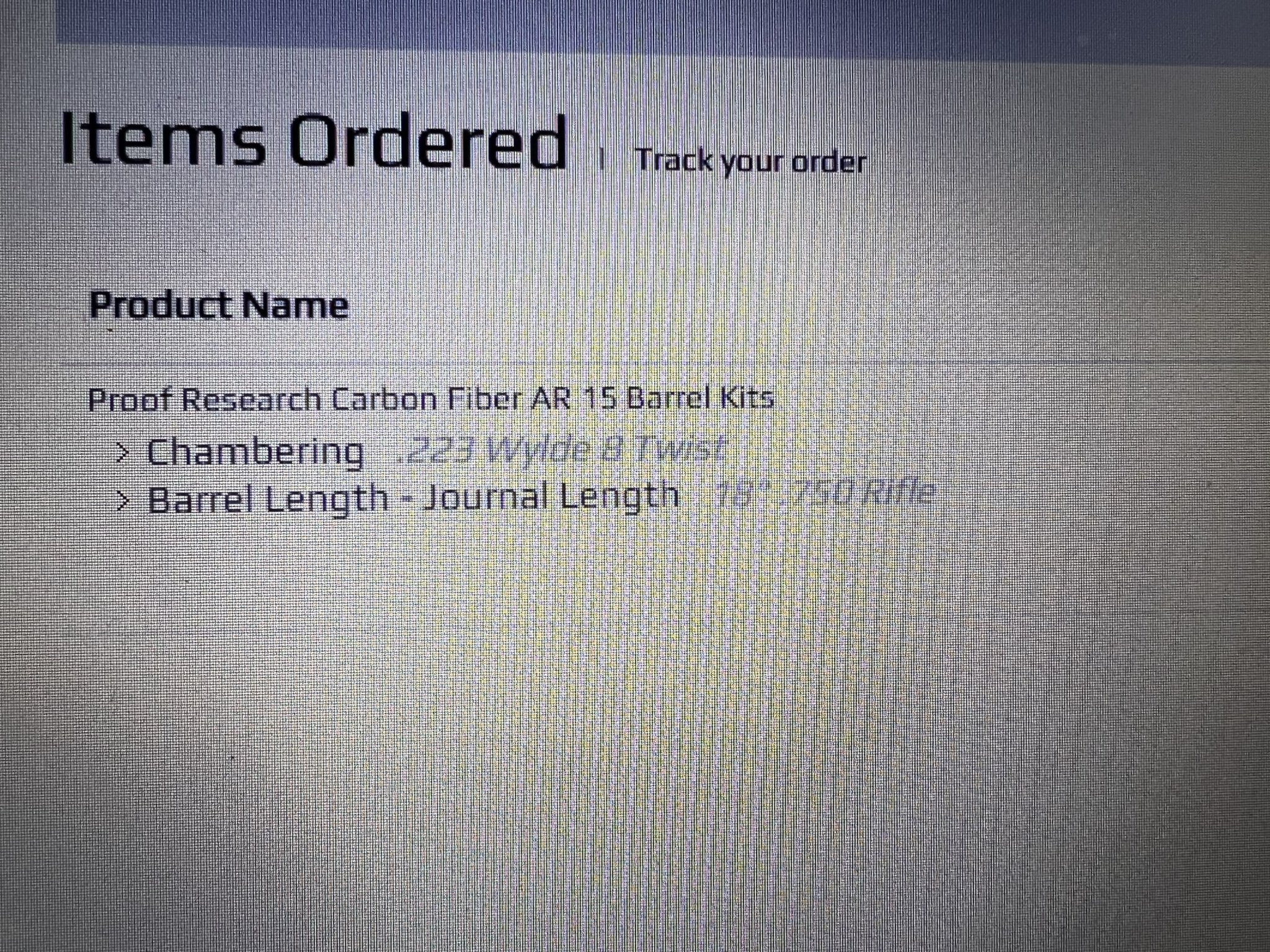

I'm guessing this is the barrel kit they advertise that comes with a brake, adjustable gas block, and gas tube?
This part caught my attention on the page:
"These are a special run that Proof offered that come complete with muzzle brake, adjustable gas block and gas tube. You must use everything included in the kit since they use proprietary parts."
well fuck! i missed that line......

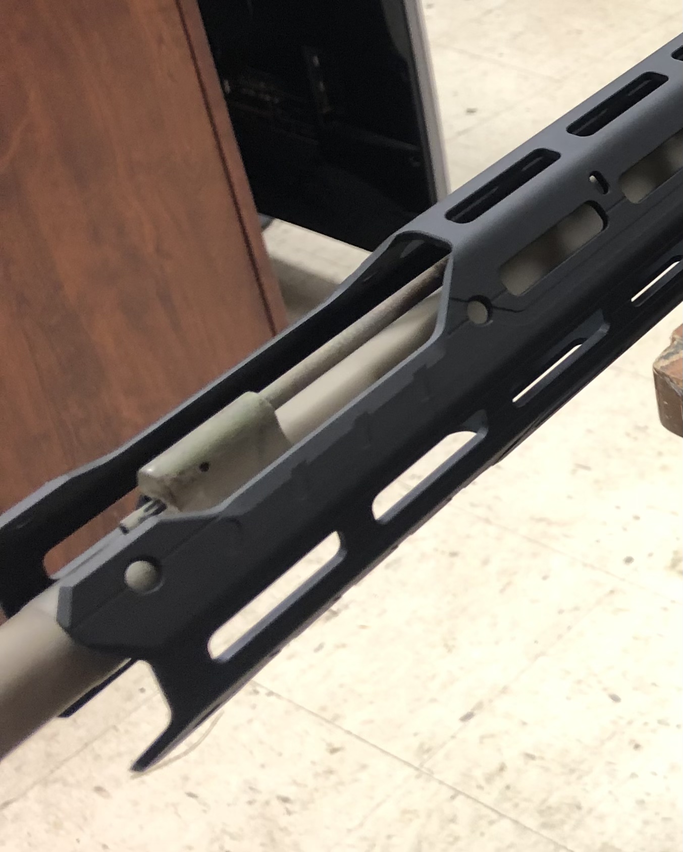

I would see about getting the handguard modified to run with it assuming you could finagle it over at all. Then again I’m sure none of this is what you were hoping to accomplish.

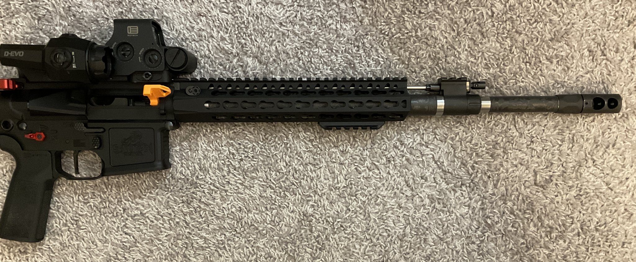

That is actually a really nice barrel, and even though it is a bastard you can still build a very nice custom AR around. I recently help a friend build one for 3 gun with it. Even though it has an oversized block we were able to use a 10" BCM Alpha KMR handguard with it and a stripped BCM upper. The installation was a little different from normal in that we had to install the handguard before installing the block and tube. However, the gas block is made to be inserted into those slots on the barrel, so the gas tube perfectly aligns with the gas port when you slide the block in place. I also liked the way the slot and nut system working for securing the block in place. When the nut is tightened to spec it holds the gas block as securely as pinning it would, and it is much easier to remove.

Now just a matter of figuring out how to get a handguard to fit… savage one, based on pic rail copy, paste, and count, is roughly 12.4 on the underside, cut back to 10.2 (ish) to clear the block… wonder if smoke composites could do a rifle diameter version of the cut-back brekke customs pcc handguard… or not, maybe. Seems like it would eat up anything I saved going with the kit in the first place…
Other option might be to see about trying to find the adjustable block off of the savage Valkyrie long range upper… that one looks like it had the same mechanicals/attachement, but in a smaller package to fit inside the rail…

Strike industries gridlock should leave plenty of room for that setup

rooster — These are pretty neat, and definitely would fit, but they are a bit heavy… ended up going with a KMR Alpha 10 for the time being; depending on how that works out I’ll either stay with it, or get something longer and have it cut out like for an FSB.

Added note on the install… getting the gas block nut to spec is a pain, since there’s very little barrel available to clamp to. I ended up using the pic rail side of pin-style upper vise block… bridged the section of rail on the top of the gas block with part of the handguard, and relied on the combination of the gas block alignment slot and the stiffness of the rail (plus the fact the rail has an alignment bridge to the upper) to deal with the torque. It seemed to work acceptably, and nothing broke… but use at one’s own risk of course.
Went with a BCM KMR Alpha 10.5 for handguard, kind of a different look with the exposed block assembly, but I’m happy with it. Only downsides are that the thin rail makes the optics look kinda chunky… and that I probably need to get a hand stop or foregrip as an ‘end of handguard’ warning.

I think, but am not entirely sure, I checked to see if that was a thing… but either it was really expensive, I couldn’t find the mod 2 gas block specs, or I found them and it wasn’t going to fit… looking again just now…. I can’t find inner diameter or length specs… however, if you’ve got more info (or more patience, I suppose), might be worth rechecking.
