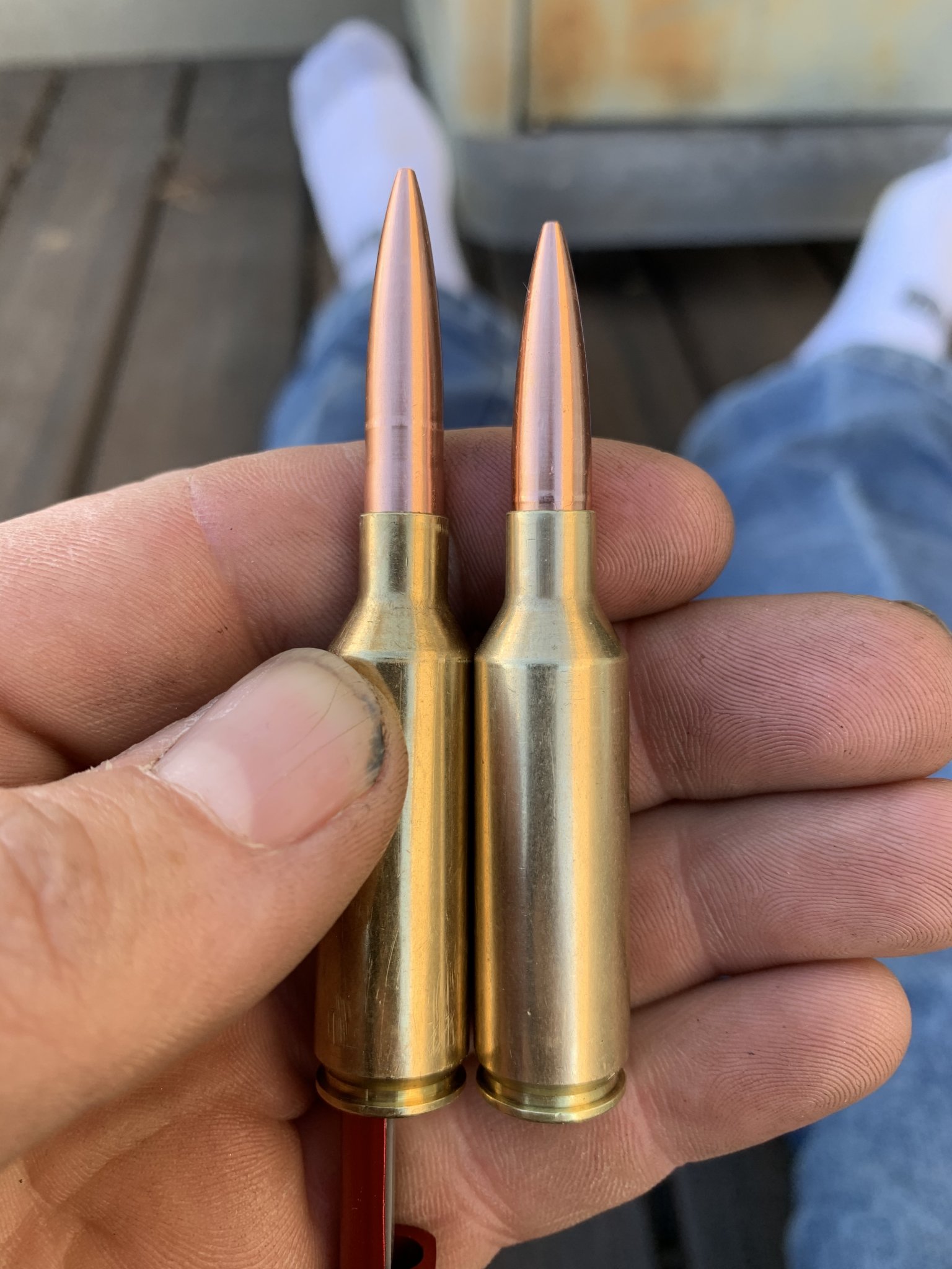

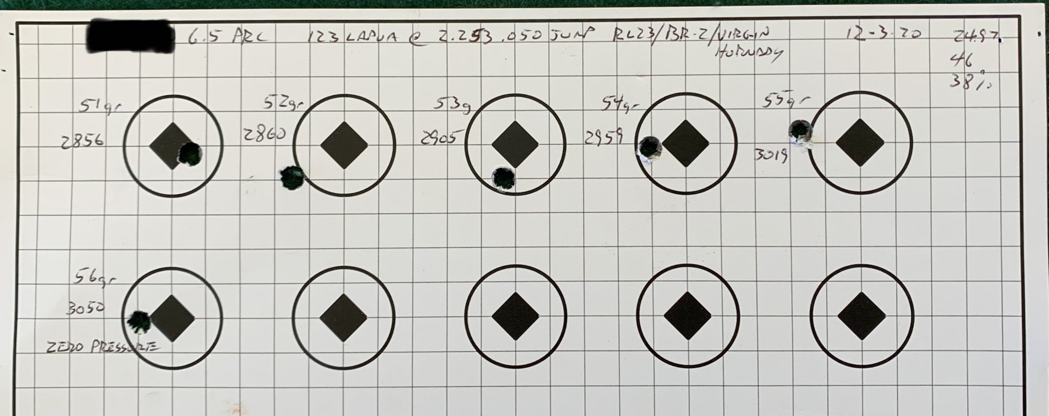

    I have a proof barrel chambered in 7 SAUM. I have not been able to get it to shoot any better than 1-1.5 moa at 100 yards. I called the smith who chambered it and he is telling me that I need to do load development in order to get it to shoot. I have tried 6 different types of bullets with various charges and seating lengths and nothing shoots. I was also told by him that at 200 rounds it should just start to shoot. Now I have never owned a proof barrel in a centerfire before but that just sounds crazy. All of the other cut rifles barrels I have ever used have shot great out of the box. Am I missing something here?
    Reactions: 338dude
    I experienced the same thing with my Proof CF. It’s a hunting rifle so the 1.5@100 was somewhat acceptable but not ideal. Low and behold, after about 150 rounds the thing settled in and now she’ll shoot 1/2 moa with factory Nosler hunting ammo. None of my other cut barrels did this, but now this one is good and I expect a lifetime of shooting out of it. Go figure.
    Berger 180, 184, 190
    Hornady 162
    Hammer 177
    Cayuga 170
    None will shoot
    I think the throat is too long, here is a pic of one touching the lands and one that is mag length
    Hornady 162
    Hammer 177
    Cayuga 170
    None will shoot
    Sounds like you have some good bullets you have tried. How close to the lands have you tried shooting them? Or have you stuck with mag length?
    Reactions: 338dude
    Run a Teslong bore scope down it and a tight fitting patch feeling for any loose spots. LRO Forum some guys had some barrels out of spec. Think it is uncommon, but easy to check. I have 1 proof barrel in 6 creedmoor. Could be more smooth. Would buy another but think they should take a few more passes lapping them.
    Longest break in of any aftermarket barrel vs Brux, Bartlein, Muller, Schneider, Shilen, Hart, or Wilson. More along the long of the lines of a factory remington stainless barrel.
    Reactions: straightandtrue
    That long of a throat will not help accuracy issues, but I would think you could get it to group better than 1 MOA still. You could see if they can cut a little off of your barrel and rechamber it with a shorter throat before you buy another barrel.
    Assuming you measured to the lands correctly, that throat is way too long. Doesn’t look like you have anything left in the neck of that case.
    Hornady 162
    Hammer 177
    Cayuga 170
    None will shoot
    What reamer? It would help to know the freebore spec, that seems pretty long for s custom barrel, but i have had plenty of factory barrels that shot fine with freebore like that. Have you talked to proof, I would hate to have to burn 200 rounds to get top quality cut rifled barrel to shoot. They would know if that is common. i am guessing it is not.
    I had a Kreiger that wouldn't shoot. i sent it back to LRI, and they hashed it out with the maker and rebarreled the rifle. Pretty good customer service IMO. I sent them the blank too, so it wasn't even their baby. I imagine their word the barrel wouldn't shoot, is better than mine when calling barrel makers.
    Reactions: 338dude

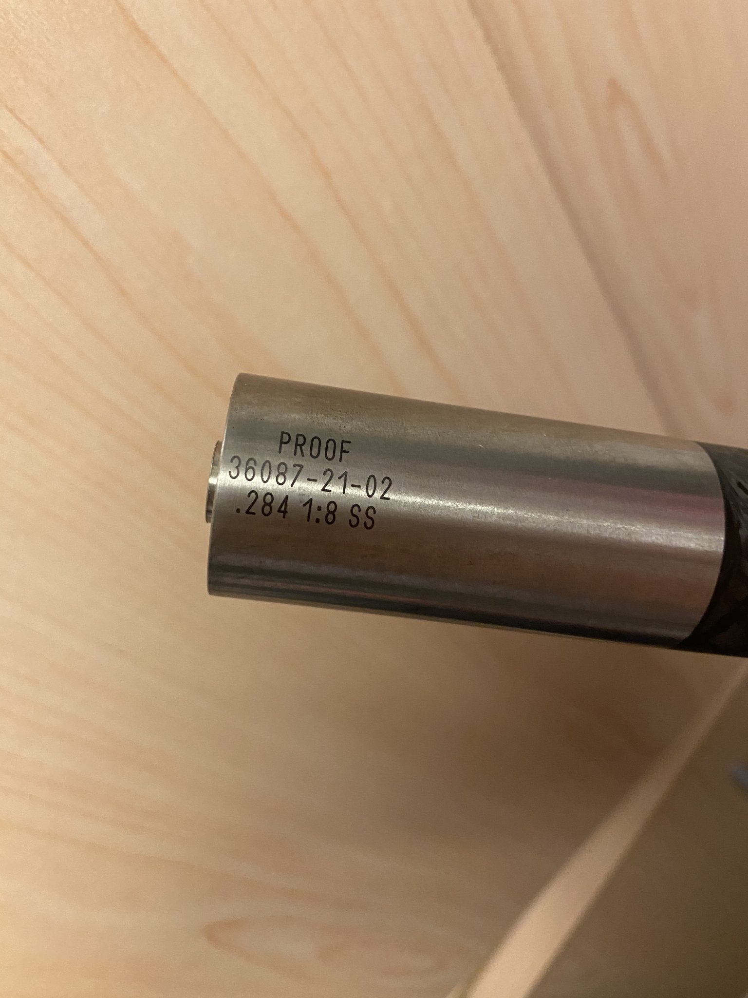

    7 twist in a 7mm? Jesus man! This is not helping your cause either. The first thing I would suggest is do a seating depth ladder. You should be able to get it to shoot if the chamber was cut straight. It looks like your throat was cut to run heavies in a long action. Be careful pushing too fast, you’ll start to blow up bullets. I have that issue in my saum with 180 eldm’s at 2990 with an 8 twist proof steel.
    My small sample of proof barrels shoot immediately, prefits and smith chambered.

    7 twist? Did you mean 8? Didn't think Proof made anything less than 8 in 7mm.
    It is a 7 twist based on what I was told by the original owner (who won’t stand behind the barrel now). 1:7 will easily stabilize all of those bullets based on the Berger bullet stabilizer calculator

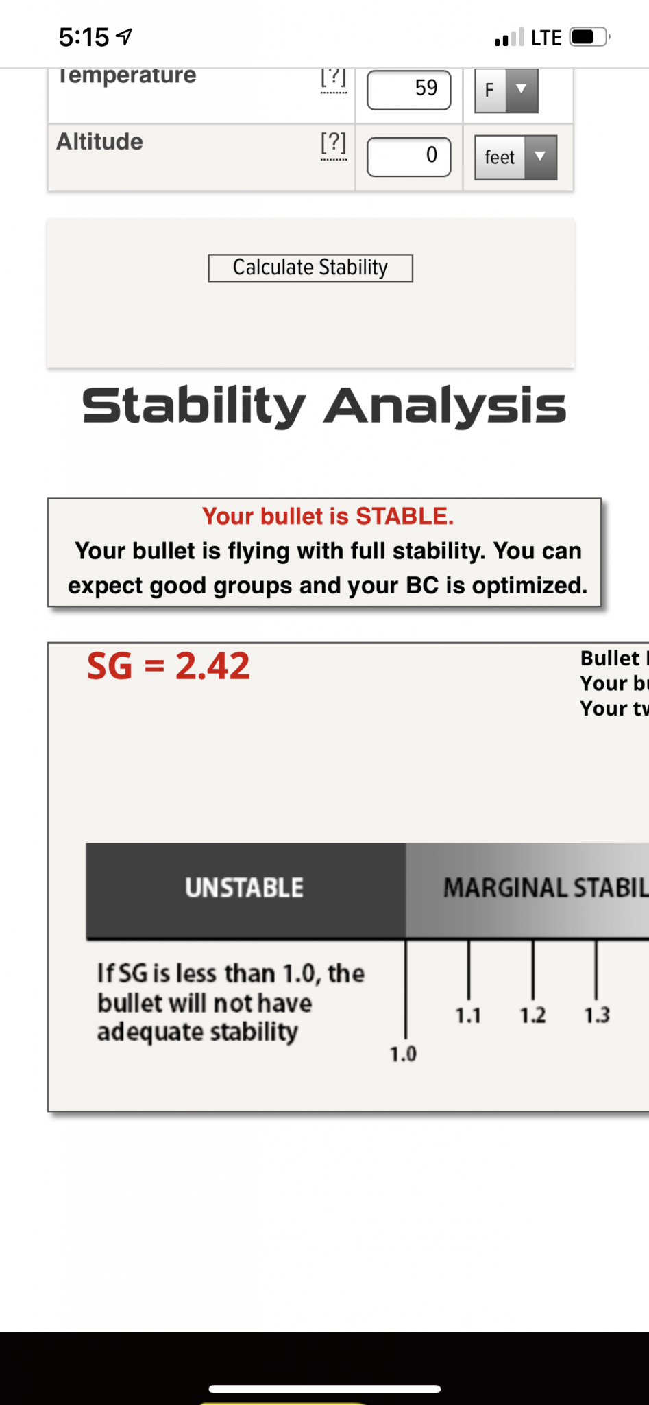

    Stabilization isn’t the issue, more like over rotation of the projectile. Theres been a bunch of differing opinions over the issue, makes for some interesting reading. One opinion is with standard cup & core bullets, spinning them too fast will lead to bullet failure inflight. I’ve experienced this with hornady’s in my 8, the Berger’s are fine, could be more of a QC issue with Hornady. With your barrel/throat combo, I wonder if it was set up for solids in a long action? Solids would be awesome though expensive. Or it could be as simple as whoever cut your chamber ended up cutting it a bit too long.

    Rounds 4 thru 9 on a spankin new proof carbon, in one grain increments. No published data for this combo. They act like other high quality barrels in my experience.
    These are the results I expected, I have no idea why the smith would tell me 200 rounds for break in.

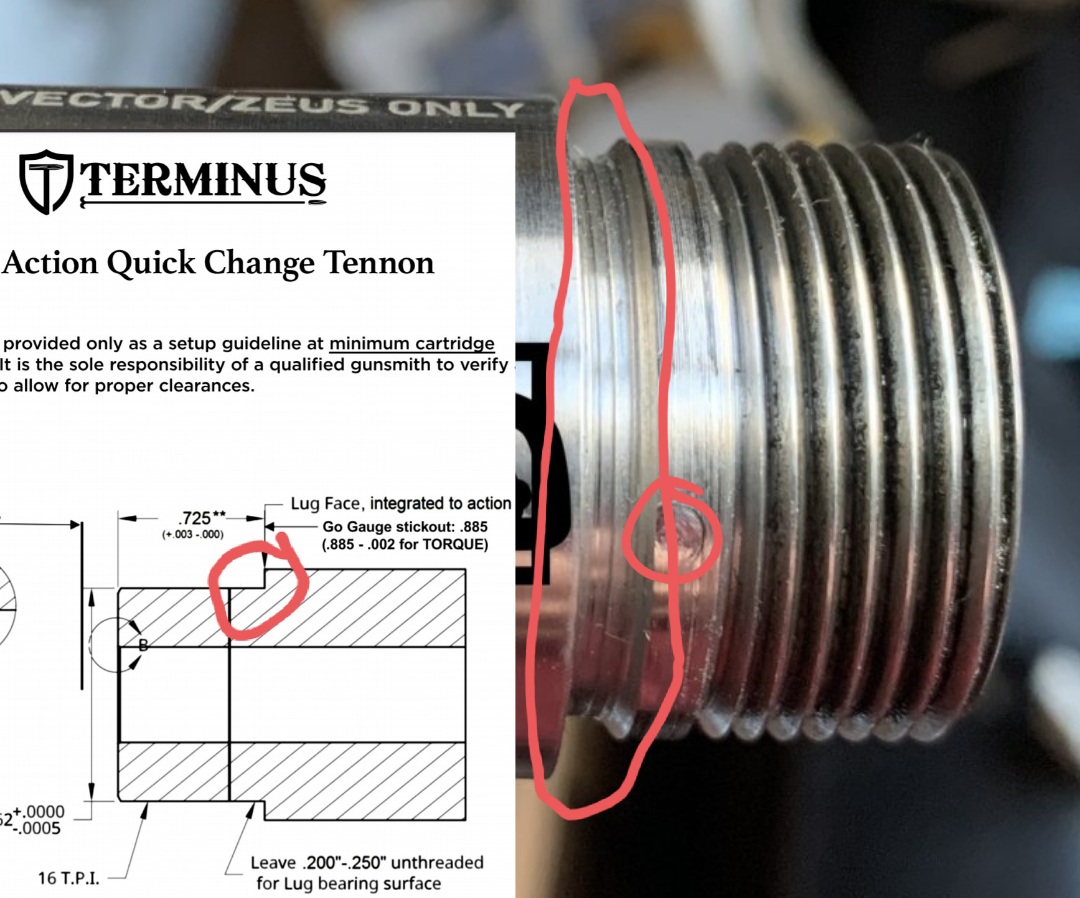

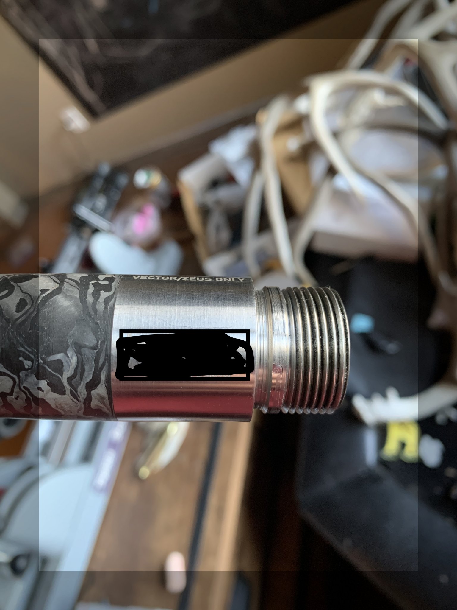

    one other thing that made me curious is why is the shank so short on my barrel when this the shank of an unchambered barrel
    View attachment 7495661View attachment 7495662
    many take 1' off of the muzzle end as the bore swells a little at each end, but they shouldn't need to take much off of the chamber end as the reamer removes all of this material. Once again sounds like someone's screw up
