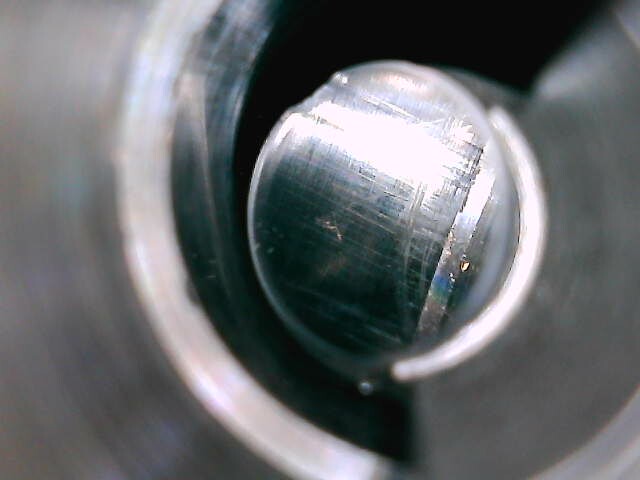

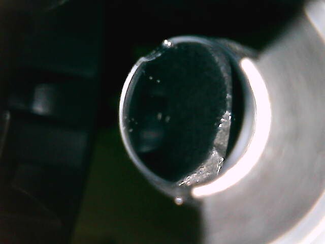

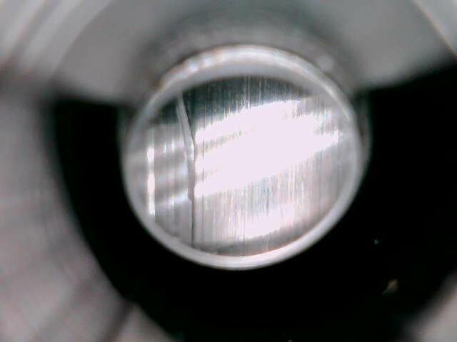

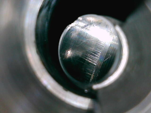

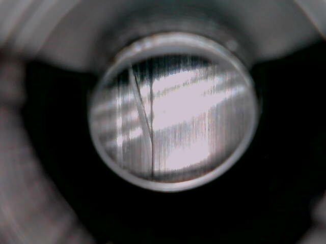

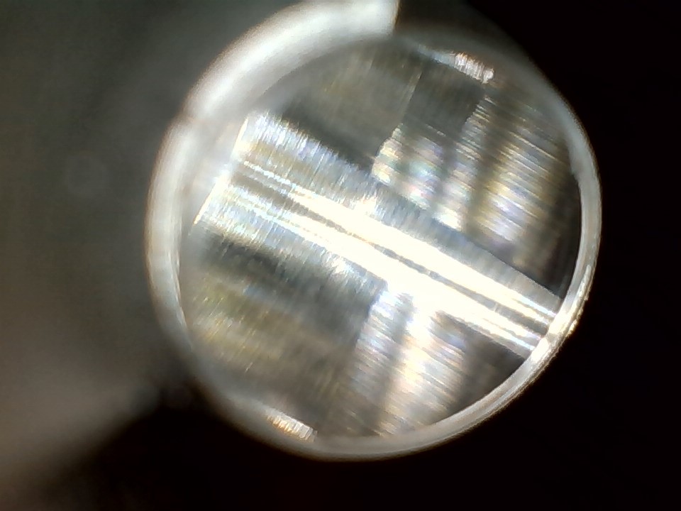

Went to cerakote a proof prefit this morning for a customer and thought others in this specific conversation will find this interesting.
Pic1 - You can see the wicked burr off the trailing edge of the land.......all lands have this burr......not good.
Pic2 - Clearly the throat is off-center on this 300wm proof prefit.
Pic3 - I like to do a simple visual inspection in the throat area.....simply take a clean new barrel and hold it up to the light and make sure the ending edge of the freebore/throat has a consistent line/edge all the way around. If the edge is heavy on one side and disappears on the opposite side.......it is clearly off-center. In all honesty there are some situations where there will not be an edge......because the bore is large or the freebore diameter on the reamer is very tight......some 223 reamers have this.......but ultimately you are looking for even machining......not really an edge, but a edge is easier to see in the light.
All that being said........this barrel may still shoot well........I am just pointing out the difference in machining/inspection from a mass produced prefit and a true custom shop prefit.

A gunsmith that doesnt like pre-fits..... mind blown
Haha. I have called out non-prefits too........even my own work. Don't mistake my knowledge transfer here for "disgruntled competitor shit talking". There have been multiple people in this thread alone that are more than pleased with proof prefits.........cheers to them for finding their satisfaction at the lowest price possible.
I am just trying to answer the original posters question without the industry habit of sucking off a big-time manufacturer and intentionally withholding information to gain some sort of buddy buddy relationship or business edge. If others hold this same value, American manufacturing will lead the way once again.

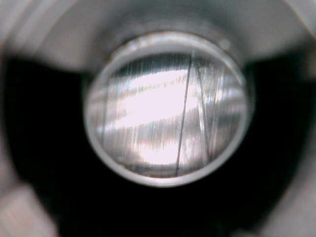

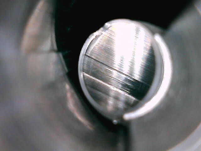

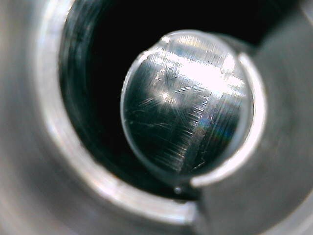

Something has definitely changed. About a month ago I had a Proof carbon blank that had a big slug of epoxy (from the carbon wrap) in the bore at the breech end. Funny thing was the epoxy slug had been 60degree chamfered.....so it was there before turning/grinding to contour.

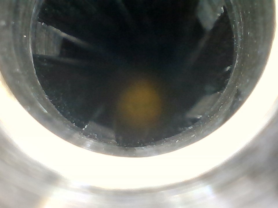

When I had started observing these shit chamber Jobs in my AR barrels I had contacted proof directly and had made contact with the Vice President of Sales, I forget his name I'd have to look in my emails but basically he said that they were expanding their facility and going through a few Growing Pains trying to get everything set up but that was in reference to the delay for the delivery of my barrels not about the quality.
These issues that were Illustrated in the above photos were all carbon fiber wrap barrels my stance on proof products today are their stainless steel AR barrels are still cheap enough to take the gamble on getting a clean barrel with no defects. I will never purchase any PR PreFit Carbon wrap barrels again, the ones that are done correctly make excellent barrels for hunting rifles and rifles with a low round count and slow shooting Cadence. Even my best PRCF barrels (.25-.5 MOA) had horrible muscle memory with cold bore shots they would group tight, but you never quite knew how fat off your Zero and in which direction the group would land.
There are two pieces of advice I give people now is (#1) if you're dead set on purchasing a Proof Barrel go with a stainless steel in calipers .308, 6.5 Grendel, 6ARC and .223 because the contours are heavy and those barrels are outstanding for high round count fire sequences, very rigid eliminating barrel whip and providing excellent Barrel harmonics, just very well balanced. (The SS 6.5CM contour is shit)
(#2) Don't purchase through expert voice because if there's anything unsatisfactory with the barrel you have to deal directly with proof CS which in my personal experience was not pleasant. PR did in the end make it right but I had to bring it to a level that I should never have needed to. Purchase through well-known companies with generous return policies so when you get the barrel home borescope it and check for any defects, that way you can send it back and request a new one or do what you should have done in the first place, spend the extra $100 and have a well established and reputable Barrel Smith turn you a quality Barrel.
