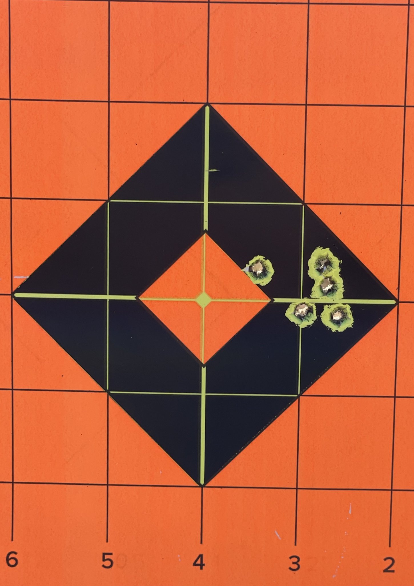

With my 16" Proof CF and an 8X LPVO, I shot this recently at 200 yards.

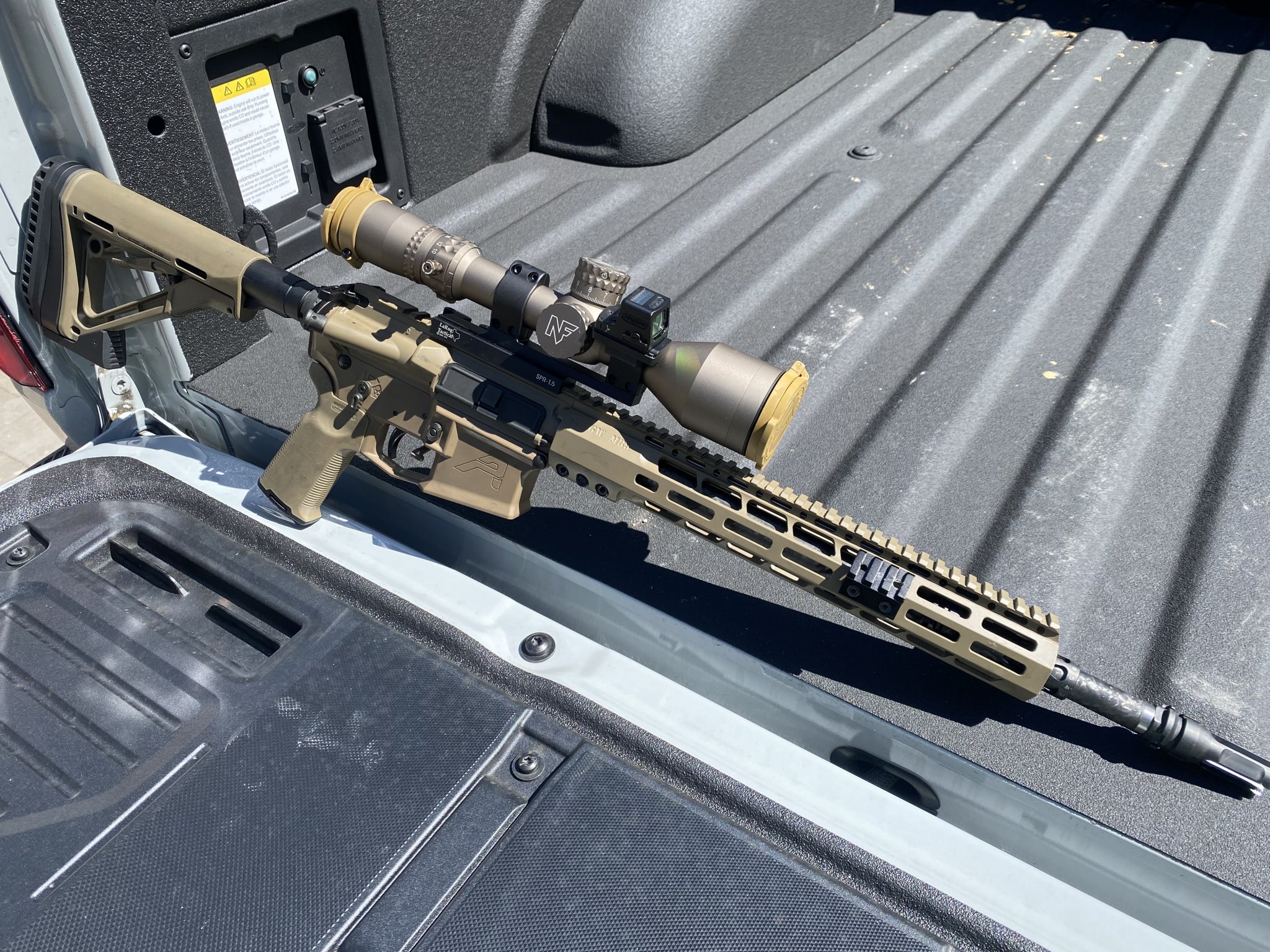

My 16" AR Proof CF is new and having some feed issues but I haven't come to the conclusion it was the barrel. Have been trying to find the right gas/buffer. However, it's accuracy is spectacular.
I have a couple more Proof AR CF (14.5/18) yet to be built but impressed so far.

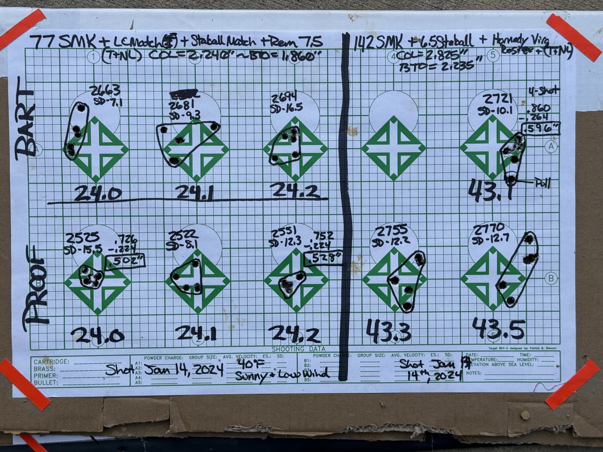

I had the chance to borescope a Proof CF .223 Wylde 18" barrel in a rifle I built for a competitive shooter, with a well documented 5000 rounds through it. It exhibited just the slightest hint of throat erosion beginning at the leade, with no heat checking at all yet apparent. In other words, it looked like a barrel with I'd WAG 1000 rounds through it.
I jokingly accused him of only shooting girlie loads through it. He said on the contrary, they were all 50 grain and 77 grain handholds at peak pressure.
