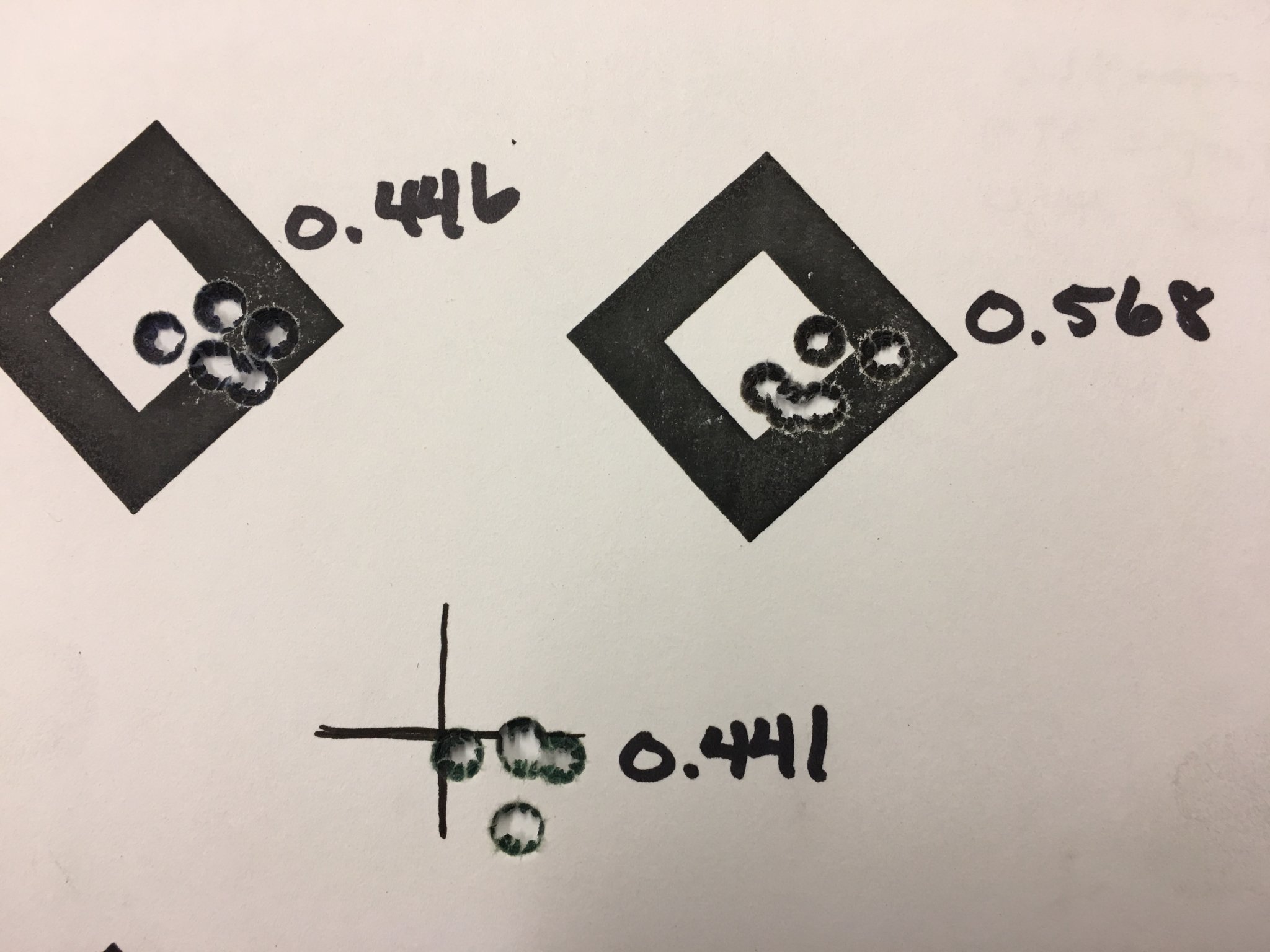

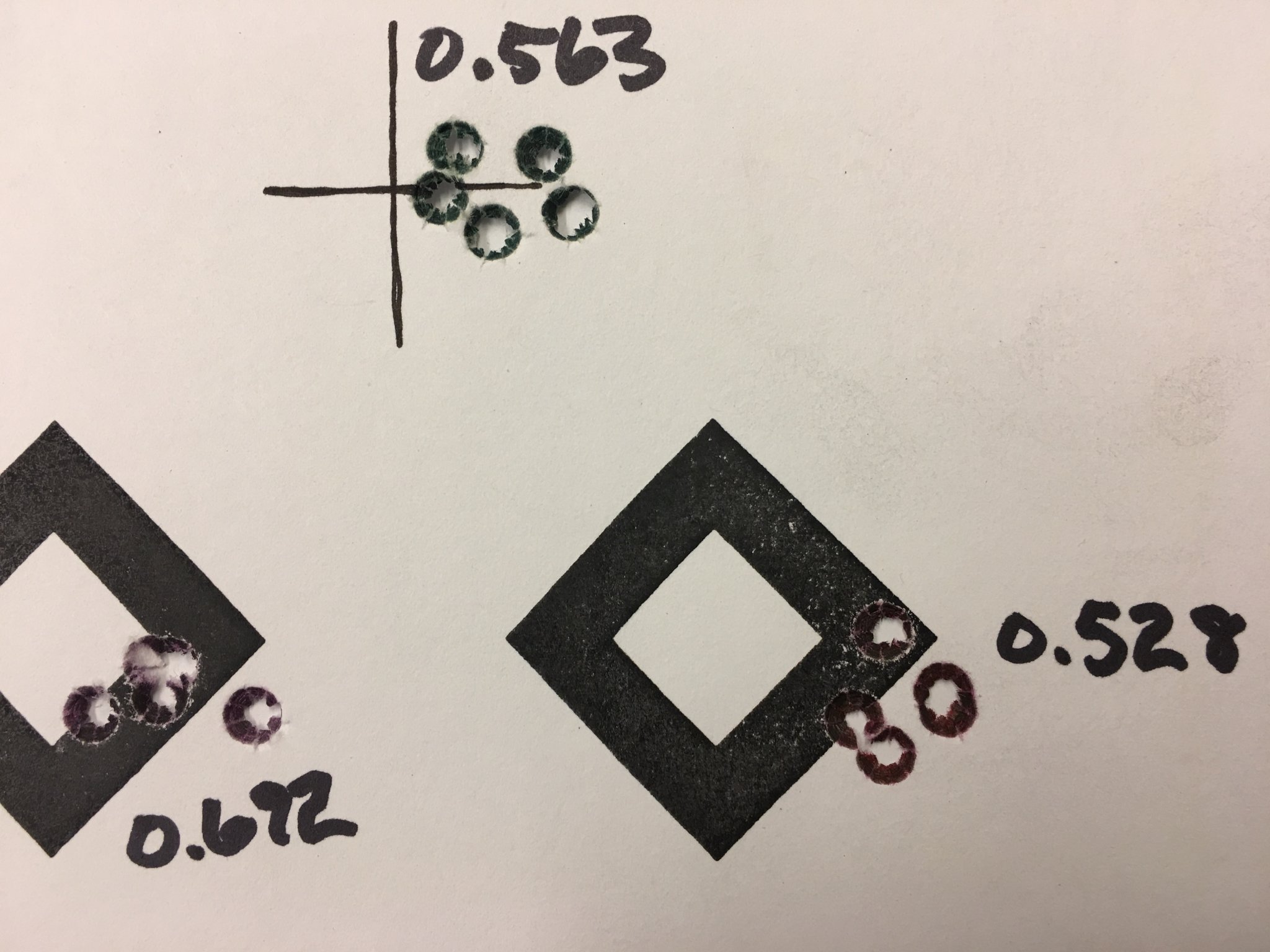

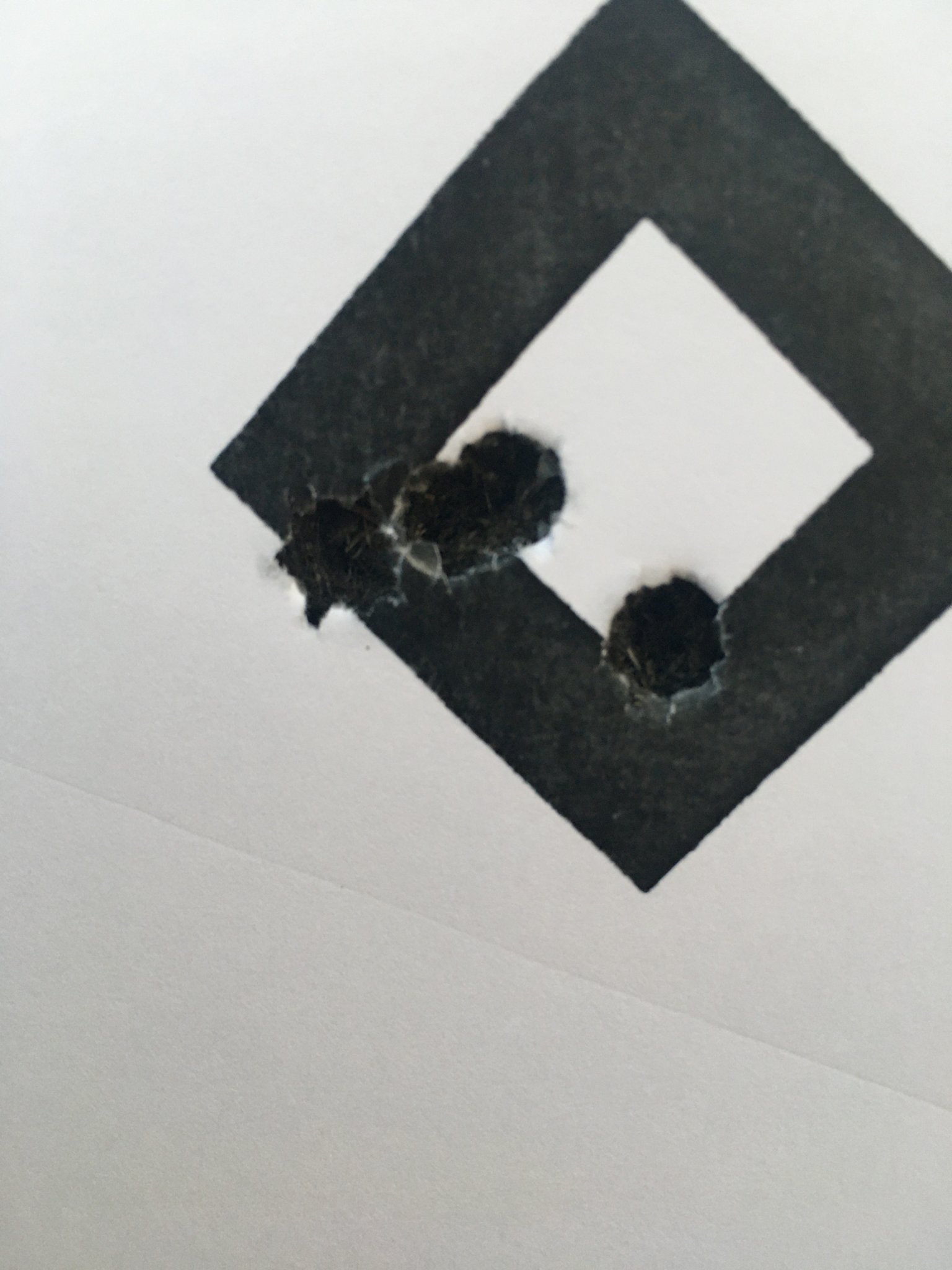

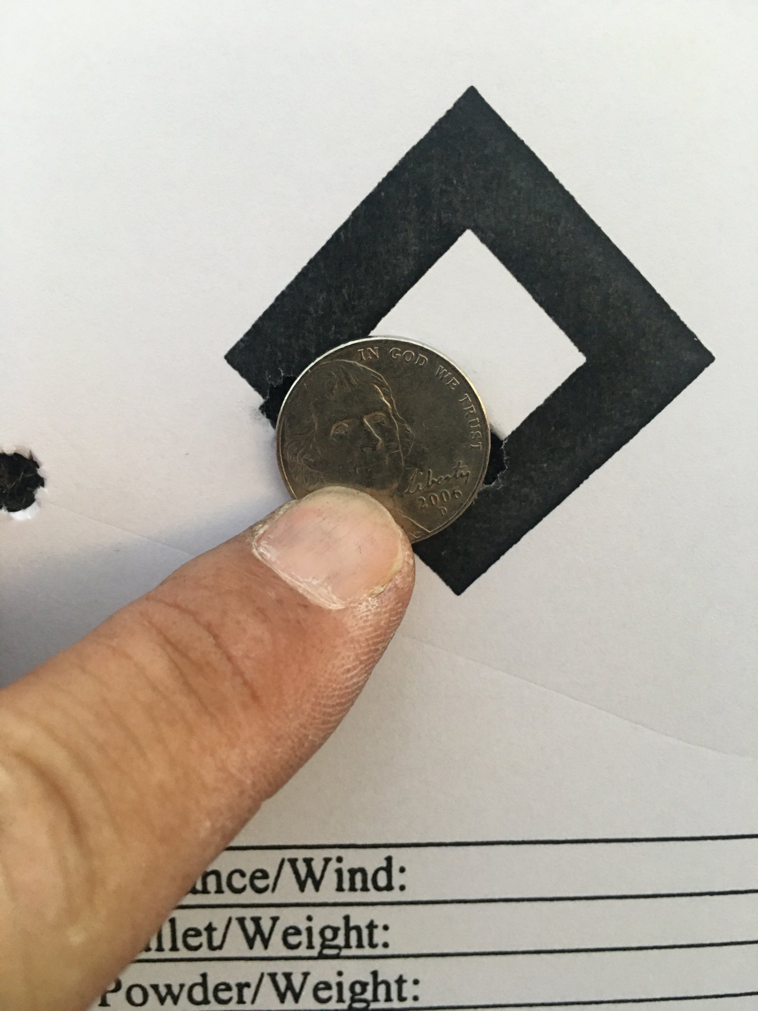

Yes, I've checked all those things. There's no dispersion. Thanks for the advice
LaRue 22”, UUK, 260
Zeroing scope to this recently acquired upper.
Loaded magazine w/5 rds.
Using a large piece of cardboard @ 100, did a quick mk 1, mod 0 eyeball test to verify not grossly off.
Shot one rd at cardboard, dialed correction on scope, switched to diamond target and shot 4 rds.
Low & right was last round.
130 AR Hybrid @ 2800, LaRue supplied buffer and spring, TranQuilo attached.
