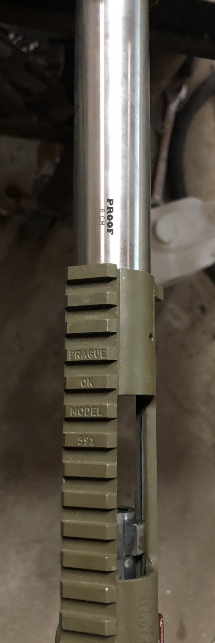

Has any one else had their Proof Prefit time up a little funky. I took an Impact Prefit and threaded on my OK built Surgron 591. This is a 6mm Creedmoor. The logo ended up about about 1/4 turn out of time. So I used a 6.5 Creedmoor go gauge and the bolt closed, with the no go gauge the bolt would not close. Can someone confirm this was measured correctly?
I have purchased a few, and its hit and miss on the thread timing on the logo. However, the gauges are the real concern. If they pass, you should be good to go. That being said, the prefit proofs I have received have been great shooters.
