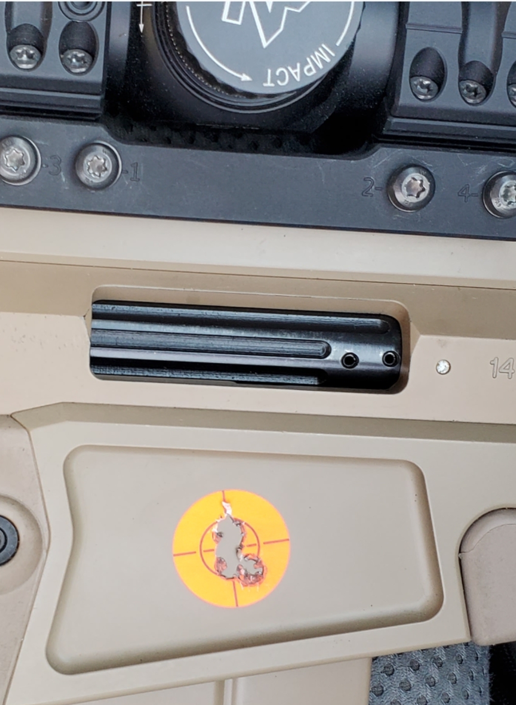

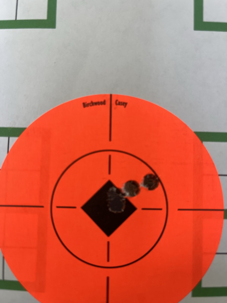

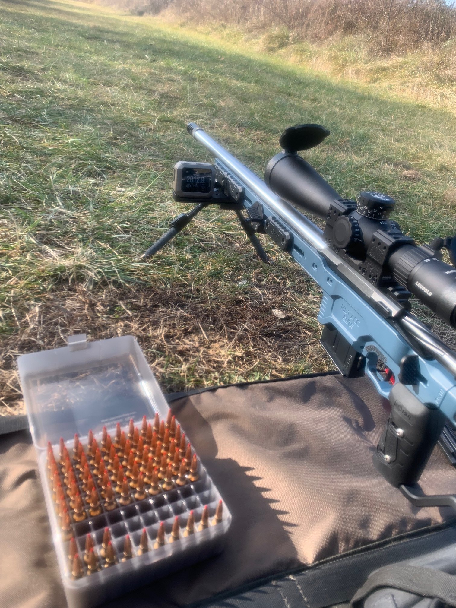

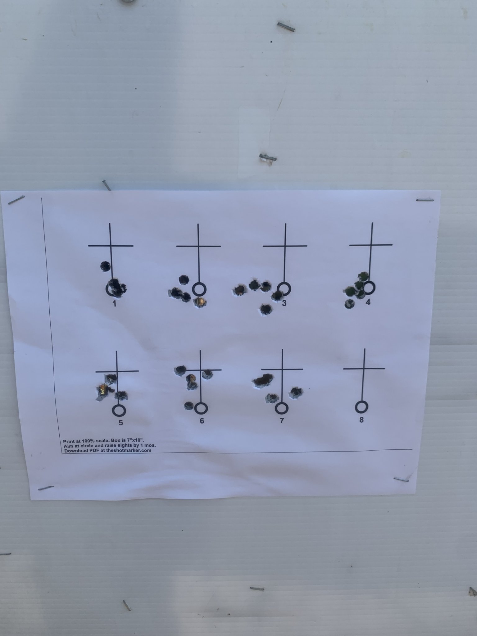

What kind of experience are you guys having with Proof prefit barrels. This is a 6.5 creed on an impact 737. Shot (6) 5 shot groups with it the other day and pictured is the result I got. This was the first rounds through the barrel but still was less than optimal. I dont want this to turn into a bashing session for proof research but maybe I have another issue. I use an area 419 brake that I plan to remove and try shooting a group just to make sure its not causing anything weird. Scope/ chassis everything torqued to spec. The high right group was shot with a magneto speed on which looked promising but still threw one way out. Ammo used is factory hornady 140 eldm and I got an SD of 3 with a 5 shot group. Any advice before I reach out to proof?

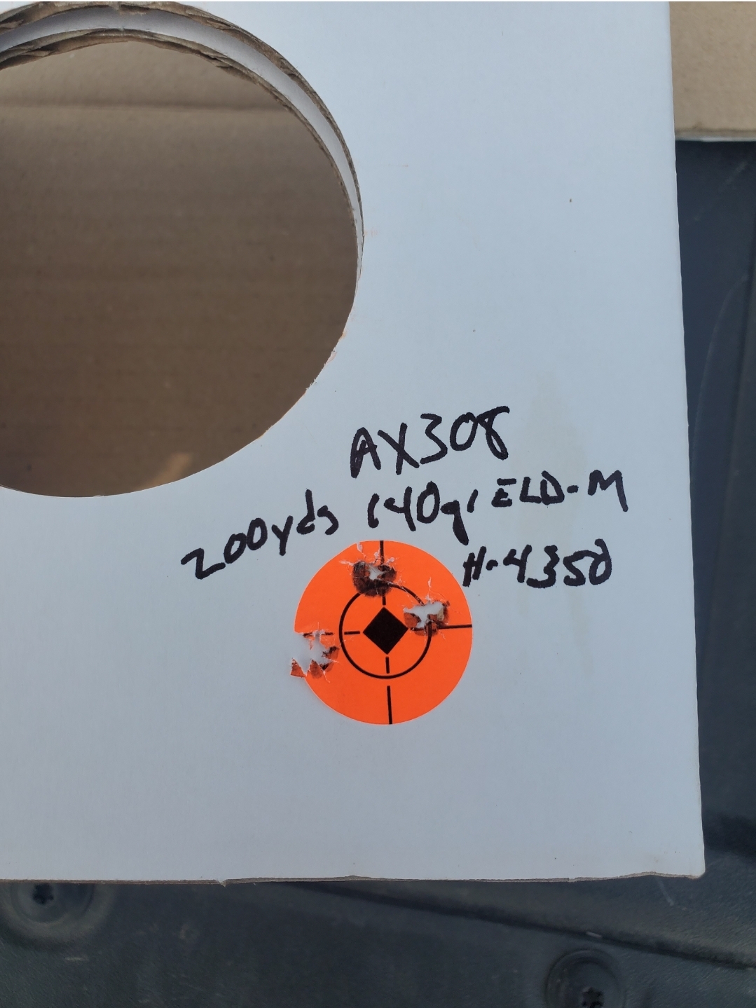

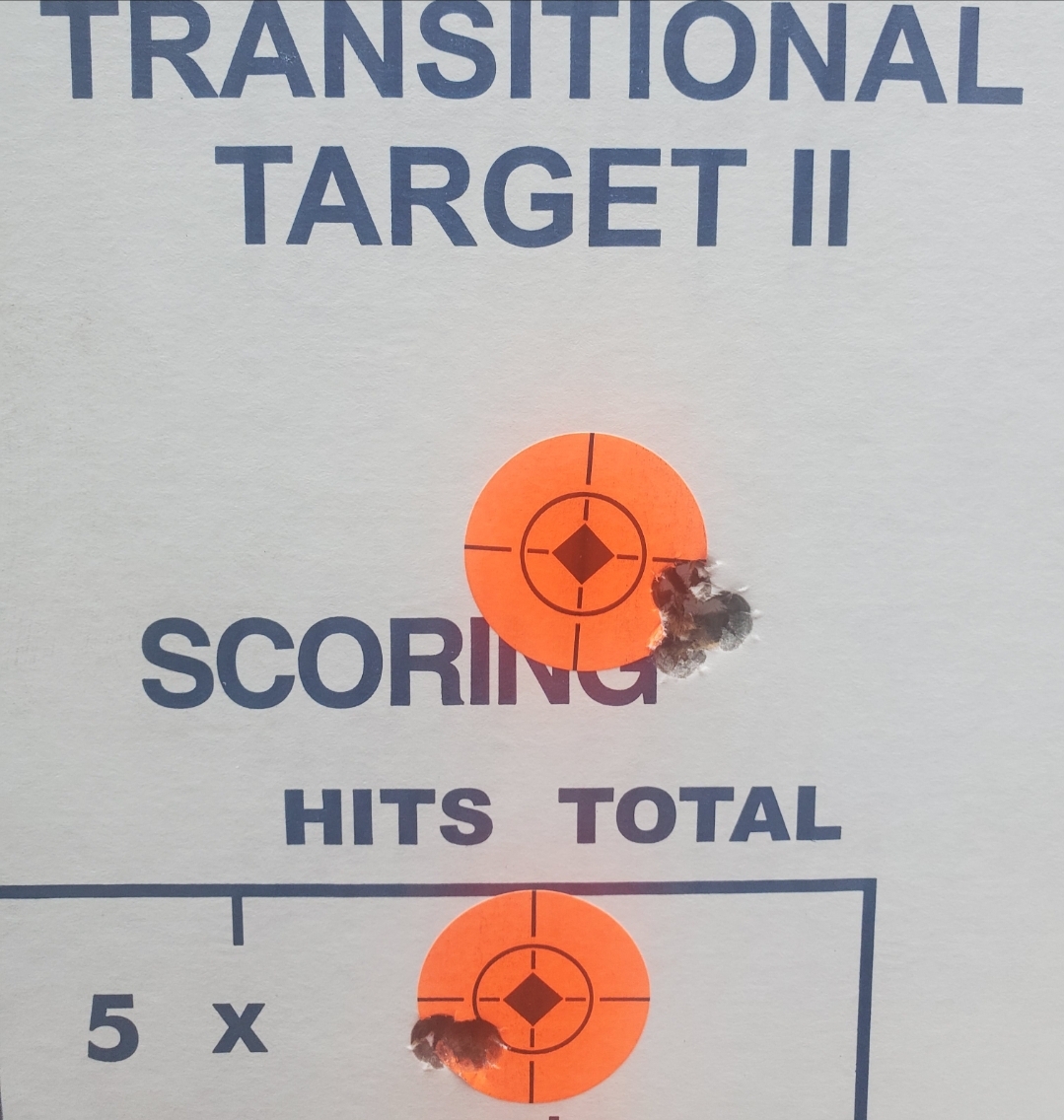

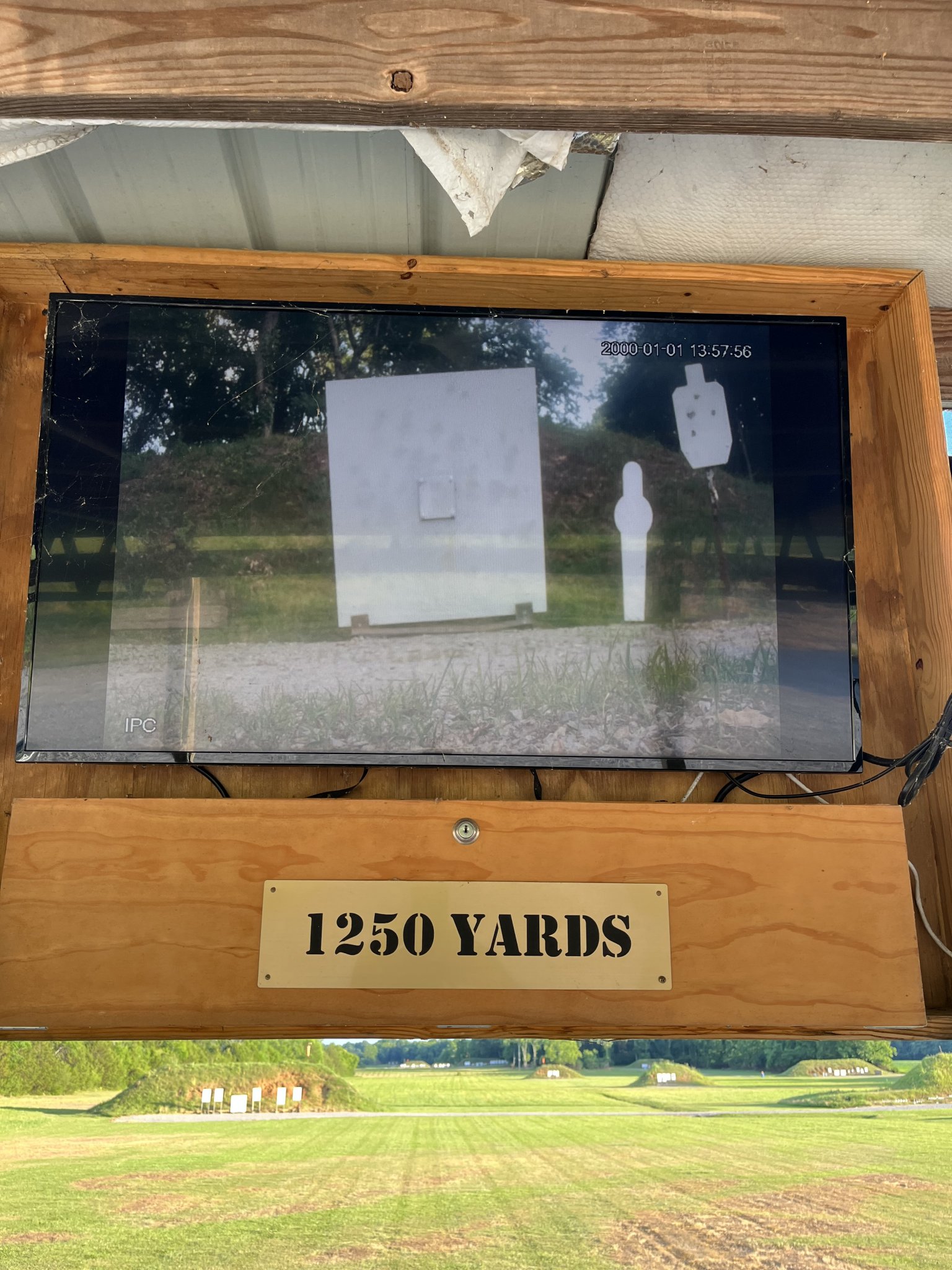

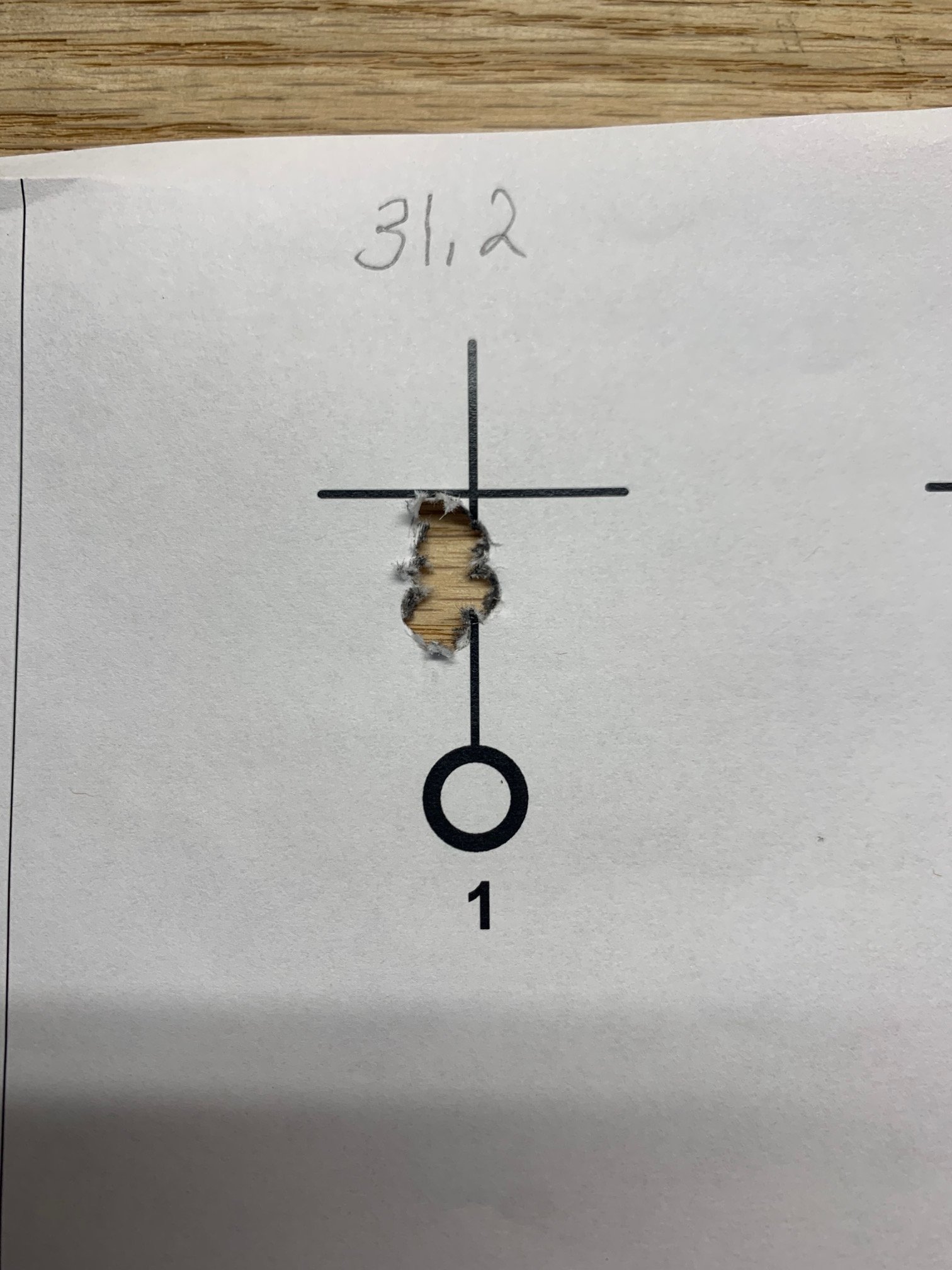

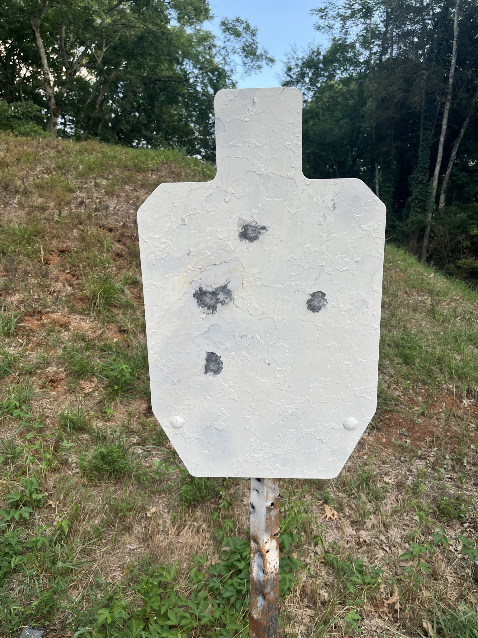

My Proof prefit on my Accuracy International AX will outshoot my abilities. I've had cloverleafs and bugholes out of it, so I definitely when I pull one, it's all my fault

I'm on Proof prefit #4 and they all have been hammers.
I'm very weary of guys blaming their barrels or any other equipment when 99% of the time it's the Indian, not the arrow.
The top right looks decent, and I'd bet the barrel didn't pull one, leave the Proof Research peeps out of this. 🤪
SD of 3... congrats on getting the best box of factory Hornady shit ever.

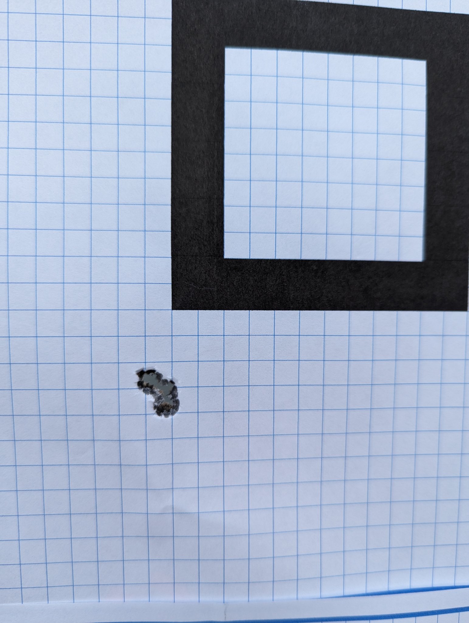

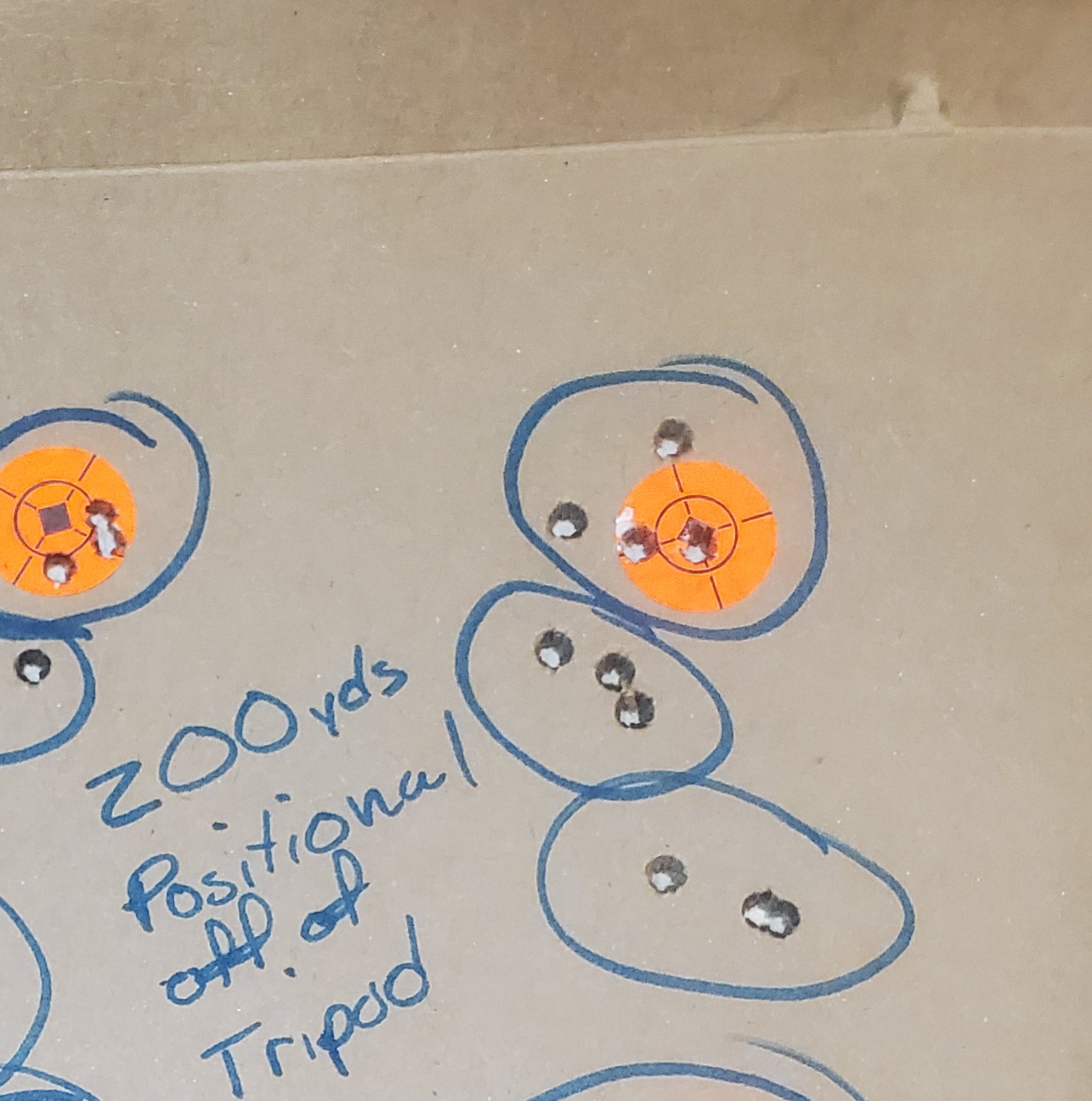

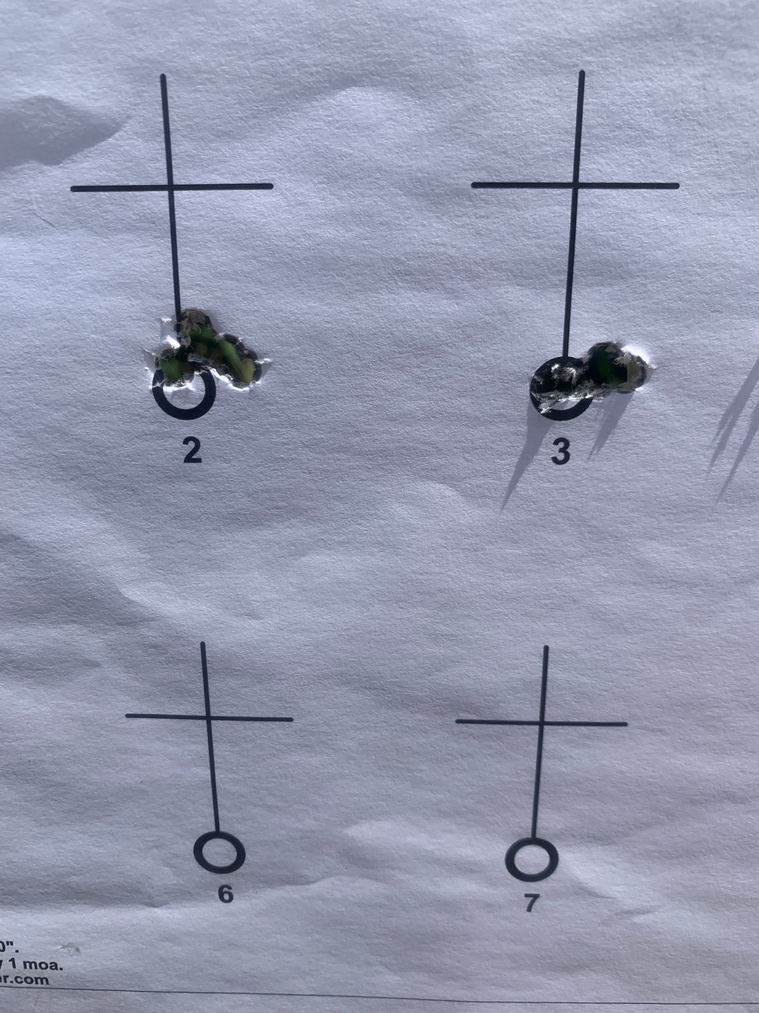

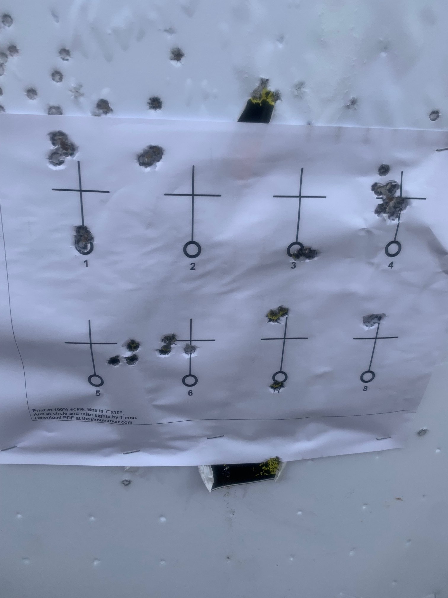

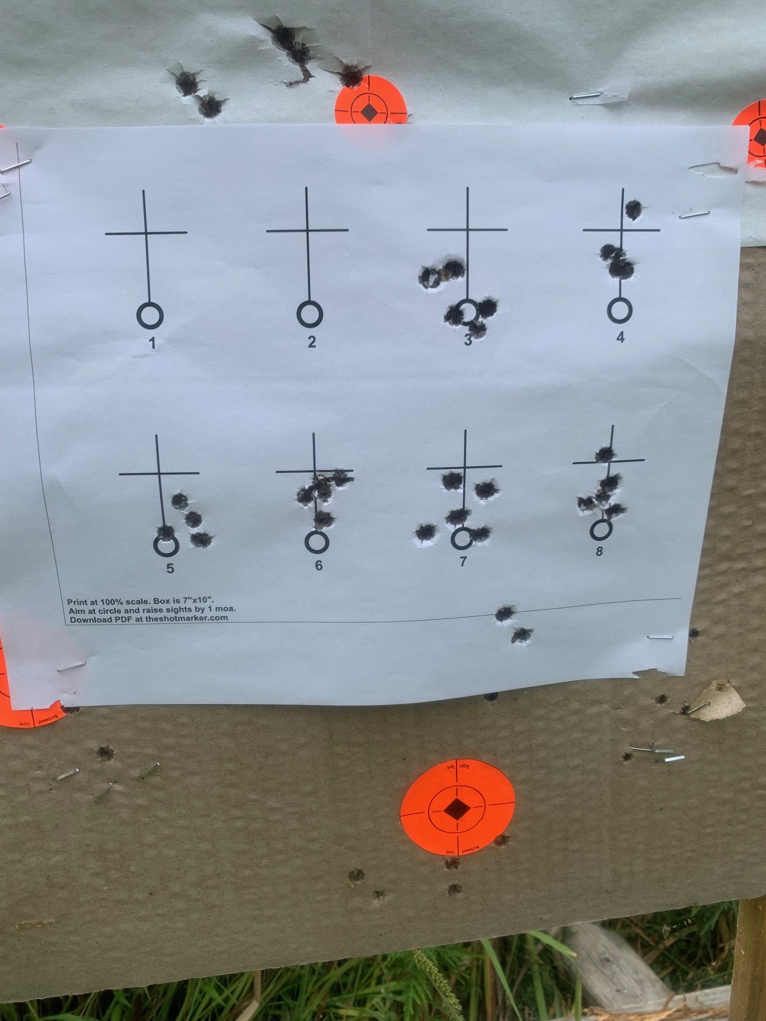

Interesting thought but probably not since my other rifle didnt seem to have that problem

Do those rifles print groups like that every single time you hit the range, do you take pics of all your groups or just the ones that look like that or the ones in the OP? I bet you don't have too many pics of your average middle-of-the-road, ok-but-not-too-impressive groups... It'd be pretty pompous of any of us to go around acting like we can just print a one-hole group at will every time.
The difference between printing a .25" group and a .5" group has more to do with how most guys slept the night before or what they had for breakfast than their equipment.
There are guys at my club every single weekend wearing out their fancy long-range rifles shooting too many groups at 100 over and over wondering when they'll find some magic barrel/load recipe instead of looking in the mirror.
Unless you lock the barrel in a mechanically rigid rest and can mechanically/electronically actuate the trigger exactly the same every time, you shouldn't be blaming the barrel, at least not yet, after only 30 rounds.

I have some Proof barrels.
They all shoot. All but 1 have many 5 round groups right at .5” or just under.
My CF from them is for hunting, so I only shot some 3 round groups once broken in, cleaned, and a couple fowlers.
.278” and .251”
With some Copper Creek hunting ammo I got off here for a song.
I have a Bartlein prefit from Ern that shoots as well as any barrel I have ever owned (with a skill-less moron slapping the trigger anyways).
5 shot groups routinely in the upper .2s to .3s.
Load development was “try a pet load 15 thou off and see”.
Rounds 11-15 .279”
It runs that to distance too
And my barrels from my local smith all hammer like no tomorrow. All of them.
But wait times and $ are a real thing for a broke dick like me, so good deals on prefits are nice.
OP, clean it really well.
Couple fowlers.
Try some different ammo. FGMM has shot well for me in a variety of calibers, as Ern noted, its also a good gauge.
My CF Proof listed above was .8-1.0 for 3 shots with old Hornady.
ammo it loves is Lapua SRP and Berger 140 hunters from copper creek.

Proof saga continued….
Cleaned barrel really well with boretech took it back out to the range and shot 4 different groups without the brake and 3 with the brake on(top row is without brake). Ammos used were 140 and 147 eldm (couldn’t source any Berger or federal. Pictures are the groups. I also took a video of myself shooting for anyone interested but I’m confident I made good shots. I did have a few rounds with ejector swipe, unsure if ammo or barrel is causing it.

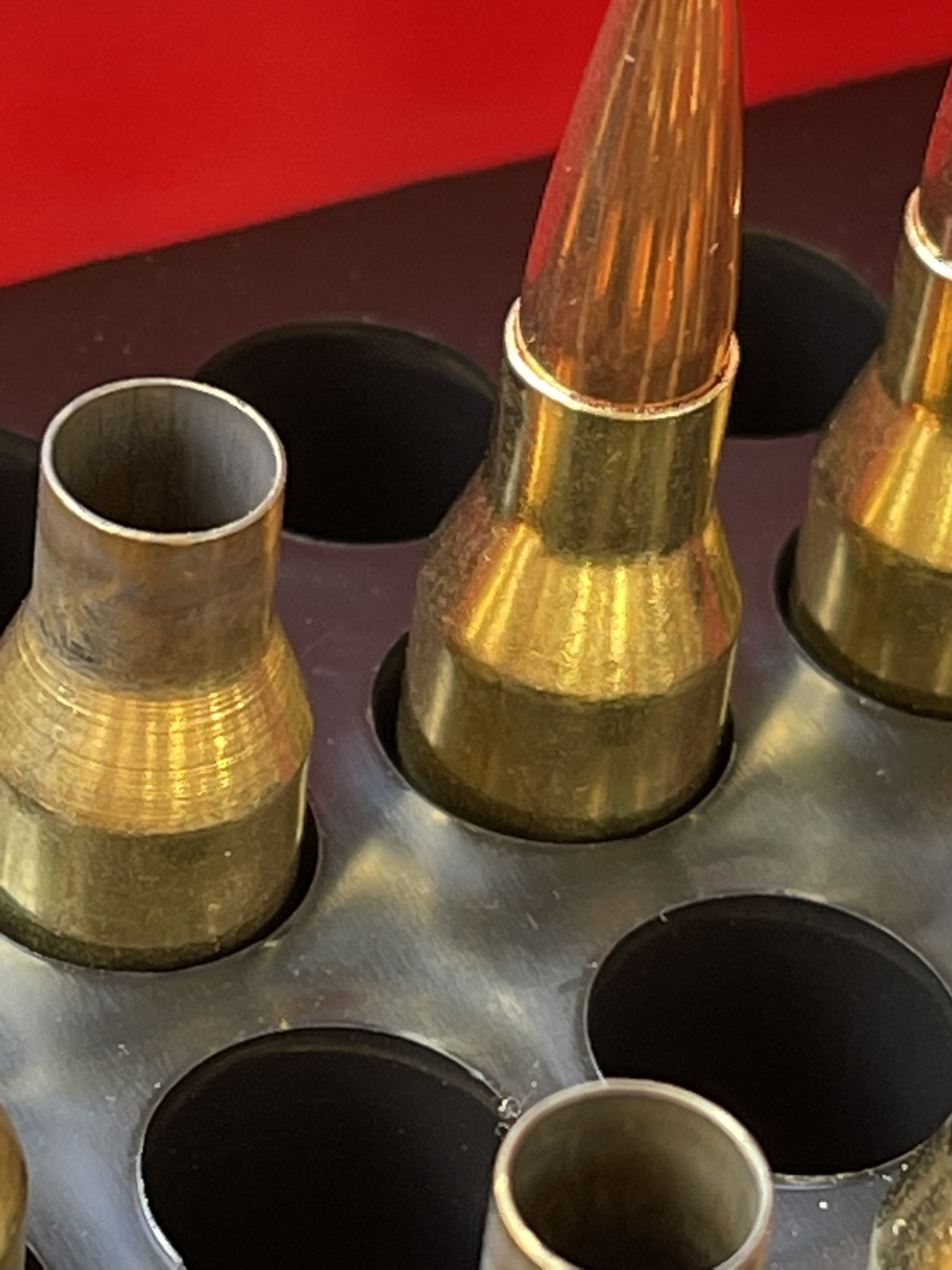

Check your fired brass. I had a proof prefit that chamber was so rough on it was marking the brass. Honestly it’s probably rare that one like that gets out. I only mention it because the brass not flowing properly caused some unusual side effects and is a possible cause for your ejector marks.
Check out the shoulders before and after firing.
That's a bummer. You may have indeed been "Proofed". Best case is you have a super finicky barrel that you will need to source a particular factory load for and hope it doesn't change.....or do a custom load work up.
Also, if it doesn't shoot FGMM with 130berger AR hybrids.....it is for sure junk. I swear that stuff will shoot good in anything short of an afghani ghost gun.

Final update. Bought a Brux barrel blank and had Short Action Customs chamber it up. Went to the range this week and rifle hammered as expected. Shot a pressure test with 3 shot groups just to get an idea on speed and all charge weights shot great. Currently shooting eldms but might get some Berger hybrids once the eldms are gone.
