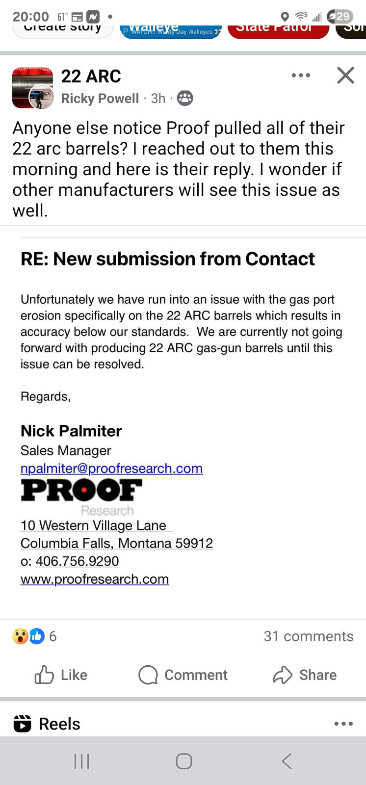

Does anyone know if this is true?

Yep. I had a 22ARC barrel on order with Proof and emailed them after seeing that same screenshot elsewhere. They confirmed that 22ARC is shelved indefinitely, and offered to switch my order to something else.

I had 5 22ARC builds in play and in the break in cycle of about 75-80 rounds per barrel, saw the fall off in accuracy and serious gas port erosion in all 5. To their complete credit, Nick replaced all 5 after their own examination and got them back to me pretty quickly. Happy with Proof customer service and support.

Since most everyone uses the same barrel steels, it would seem to plague the whole 22 ARC AR industry...if true.

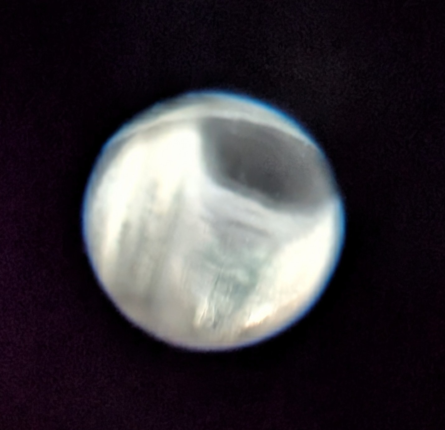

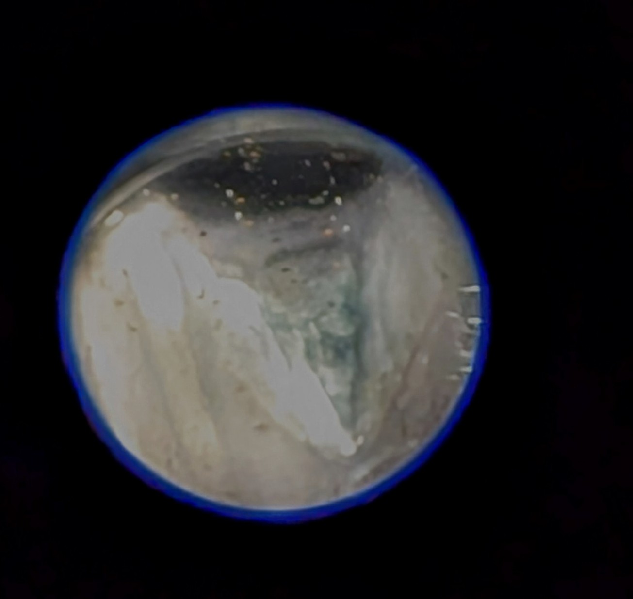

My Craddock RTR has pretty massive port erosion. I can't take a good photo because I have a Hawkeye bore scope but it's as bad or worse than anything posted above. It did also lose accuracy after about 100rds. Been chasing it for a while. This might explain the issues I've had.

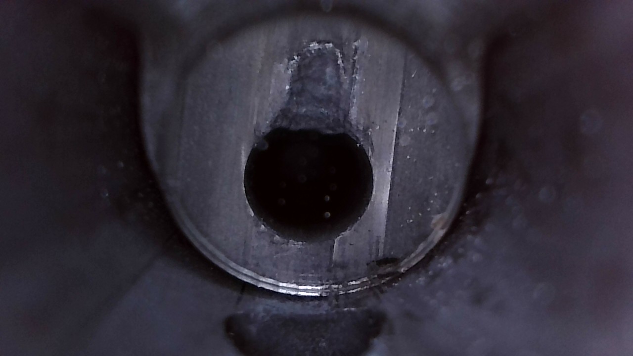

So I checked a bunch of barrels...they all wear at the gas port...how much, seems to depend on the gas pressure at the gas port, its location in the barrel, and barrel material. But they all wear.
The 450 bushmaster is much better than the 6 mm ARC, both 6mm ARC Proof barrels show about the same wear, both 18" but they also have quite a few rds on them.
The shorter the gas tube the higher the pressure, the more wear at this point on the gas ports. Appears to be true for 308 and 6.5 CM.
Between the 6.5 CM and 308 bolt guns that have both have had high pressure hybrid cases fired in them, the stainless steel barreled 308 which has many more rounds has on it has almost no wear, while the CM steel 6.5 CM shows fire cracking, quite a ways down the barrel.
The 6.5 CM is a real barrel eater compared to the 308...about 3 or 4 times more erosion in the 6.5 CM.

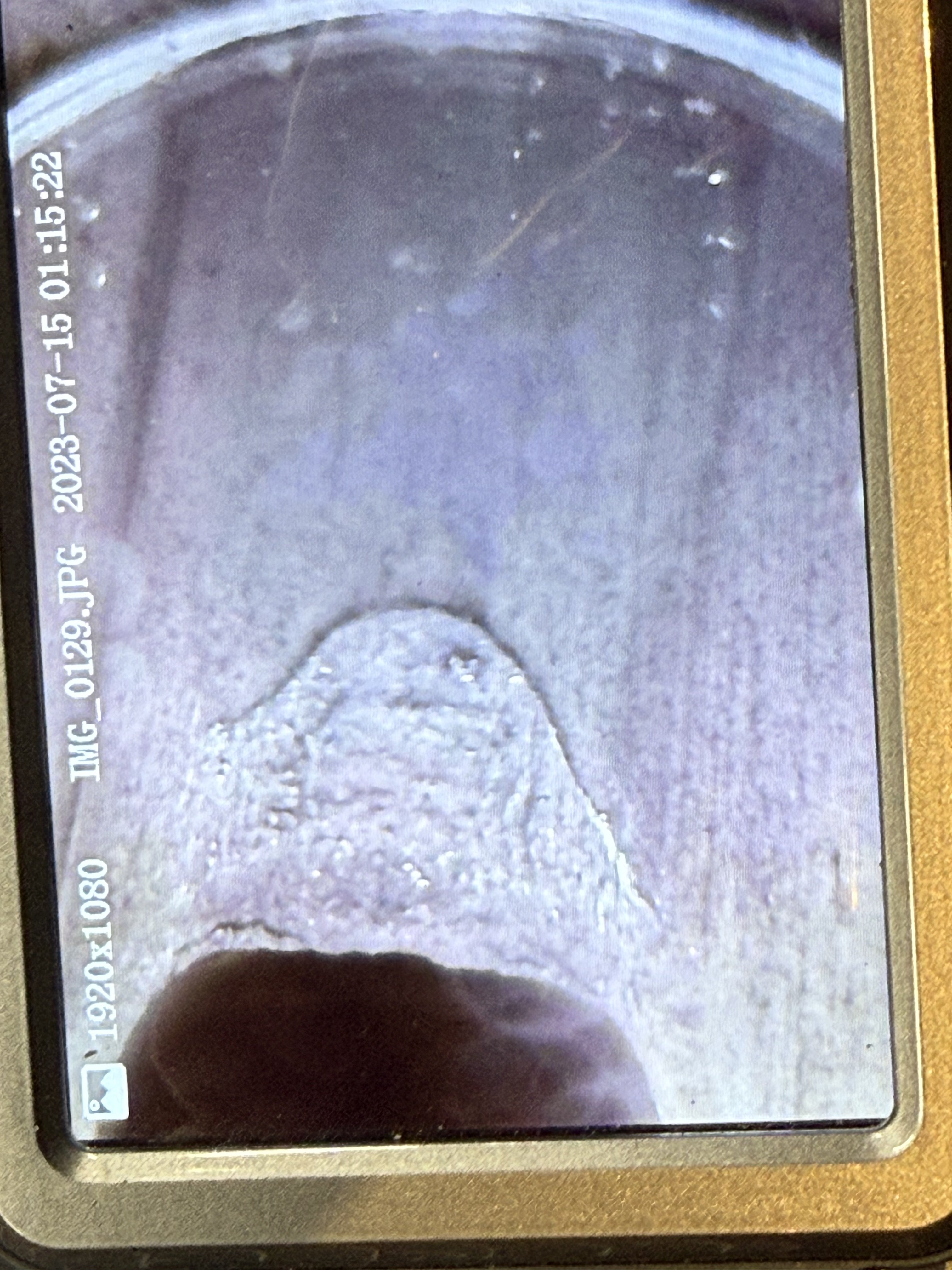

Gas port erosion has been with us forever. It's just with the advent of more reasonably priced borescopes that that we all get to watch it happen in real time.
Different barrel steels behave in different fashions at the gas port. Gas port erosion really doesn't hurt the barrel's performance as long as the erosion is smooth and gradual. What upsets accuracy is when a little jagged chunk of steel breaks off at the forward edge of the gas port. The bullet doesn't like this. You'll see the trail of copper from that point all the way to the muzzle. Accuracy of course suffers.
Years ago, one renowned AR' barrel maker switched to a super hard SS that would unfortunately do this regularly. After sending so many back, I just had to quit using them.
The only good news I have to share is rough gas port erosion will eventually smooth out after a couple hundred more rounds and the barrel will perform at its earlier capability.
