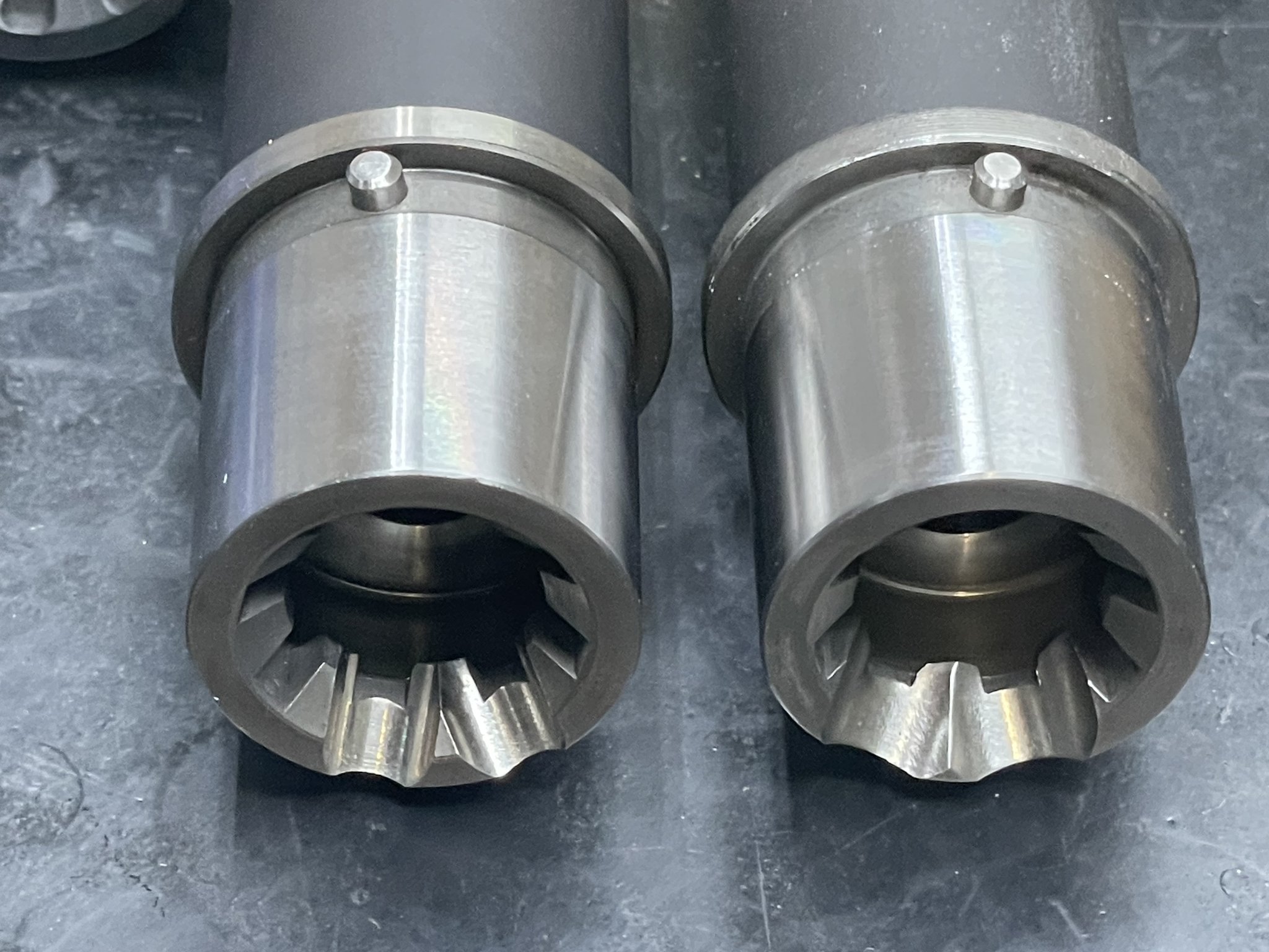

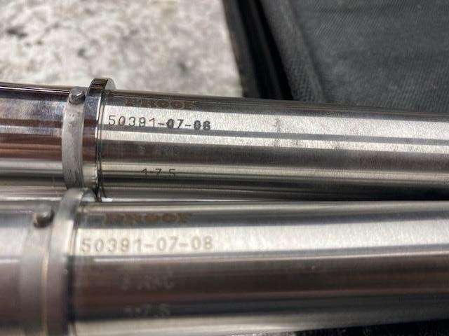

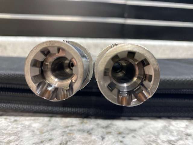

I just purchased two proof research 18 inch steel 6 arc barrels for a steal that had been sitting at my dealer for some time. Same part number but appears to be a different date code? One has much wider feed ramps than the other. Anyone know if there was an update to widen or narrow the feed ramps because of feeding issues? Proof advised a possible different barrel extension manufacturer? I'll be gifting one and to a friend and I don't want one of us to have jamming dud.

I have 2 6 ARC Proof barrels, I did polish the feed ramps before installing the barrels as usual....so my feed ramps are narrower than the wide ones and different than the narrower ones.
I do not have any feeding issues out of either rifle.
May try some different magazines and also cartridge overall lengths, to help solve the problem.

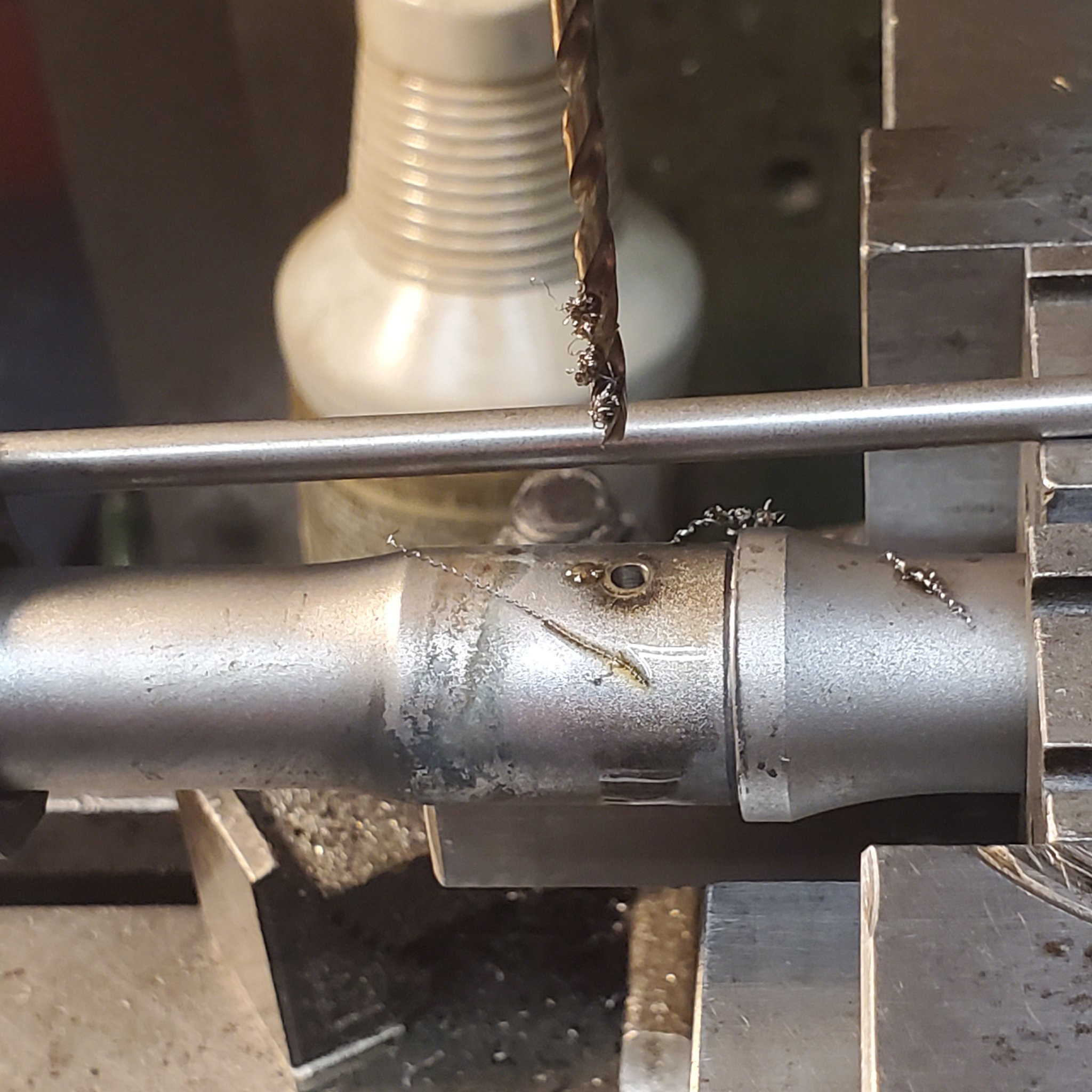

I almost always open up gas ports on every AR barrel.

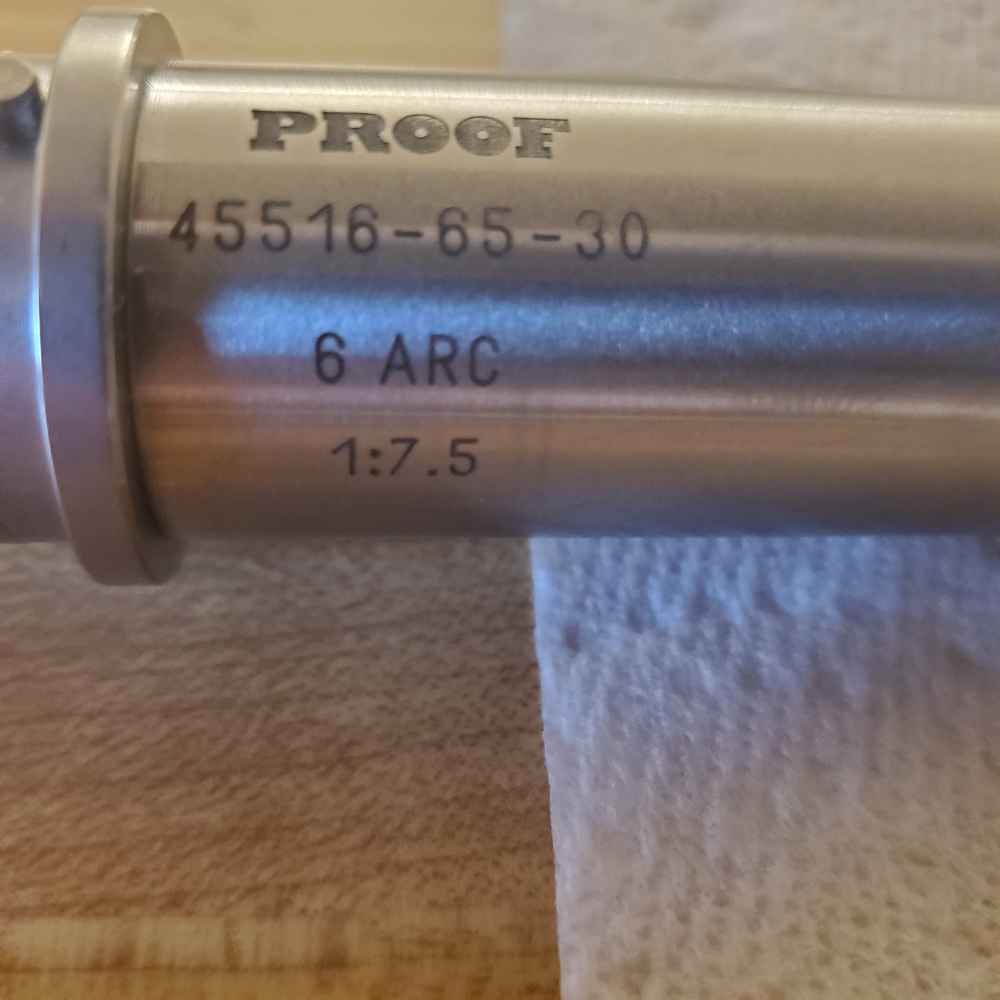

My buddies grabbing ours from Cera-kote in the next few days. I'll try and have him pin gauge it while he's there. These will both be suppressed with non flow through cans and adjustable gas blocks. If anyone knows how to read the part number/date code I'd be interested to see how old these are.

I dont know if it was an update, or if the earlier batches came with a gas port that was not drilled to the correct size.
In either case, their website lists the blueprint with the correct port size and a half-decent micrometer or pin gauge set will confirm if thats accurate or not.
If you please, what was the original GP size , and you opened it up to ?
Also, what gas system length, and barrel length ?
The gas system is rifle length on an 18" barrel. I use number drills to determine the original size, then move up to the next size, sometimes 2 sizes. Until I get the right functionality. They could start around, .082 but.. .086" to .089" is more likely,
I will go .096" and try, then .098" .0995"
Will usually solve most problems.
