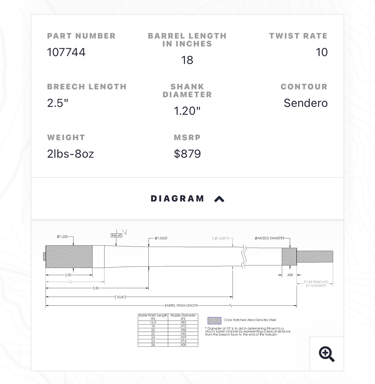

Hi,
I’m fairly new to the precision world and building a rifle (attempting to lol) for LE sniper work. I just picked up a proof research 18 inch 1:10 carbon fiber barrel. What actions will go well with this and does anyone have any gun smith recommendations to assemble the barreled action? Do I need a specific action? I was leaning toward nucleus. Thank you and sorry if this is a dumb question. Still learning, AR’s have always been my gun of choice.
This looks to be a barrel blank which would need to be threaded and chambered for the .30 caliber cartridge of your choice. It is not specific to any action and will need to fitted by a gunsmith.
I'm thinking you are doing things out of order.
Maybe research things first before ordering something that could potentially be an expensive mistake.
I appreciate the comment but doesn’t help me at all. I’m doing research right now by asking questions. I was told and have read the proof research carbon fiber barrels are one of the top barrels. I cannot find any “Remington 700 pre fit” proof research barrels. So I went with thr 308 bolt action barrel and now I’m exploring my options of what action and gunsmith to use. If you have any sites I can go read up more on this, please feel free to share.
A Nucleus would work fine for that blank. That barrel has no chamber or threads, the .308 part is referring to the nominal groove diameter, not a specific cartridge. However, it can be chambered for .308 Winchester and thread to fit a Nucleus. If you are looking for something to just screw together you should buy a Nucleus pre-fit chambered in .308 Winchester. I assume you are using .308 Win for LEO, since that's what most M.O.s are still using.
The closest thing to a Remington 700 prefit is a Remage barrel that uses a barrel nut.

Thank you! So are there any barreled actions I could drop straight into a chassis you’d recommend over going this current route?

We use Remington 700’s so we are requested to stay on that platform. Other than that, we’re good to go. So far I have a Magpul pro 700 chassis, nightforce 2.5-20 with a spuhr mount. Budget is pretty open at this point but we are a urban police department so most shots would not be long distance shots, 200 yards at most. I want high standards than that though obviously.
What he said was spot on. Your question could literally be answered by saying “Every bolt action, and every gunsmith listed on this site”. What is your budget? Any other likes or wants with your build? Stock or chassis? Be as detailed as you can, and you’ll get detailed info.
I need to try to stay on the Remington 700 platform. I currently have a magpul pro 700 chassis, nightforce 2.5-20 with a spuhr mount. I work in an urban area and budget I’m pretty open with. .308 win caliber
Pretty much every aftermarket action is based on the "Rem 700 platform"... do you have to use an actual Remington 700 Action, or can you use any brand based on that platform? That's a big difference.
If you can use any Rem 700 Platform Action, I would purchase a Proof Pre-fit barrel (They make prefits for several actions), buy the corresponding action, and just torque it on.
If you have to use an actual Rem 700 Action, you are going to need to buy a Rem 700 Action, have it Trued, and then have that barrel chambered for that action. I'd highly recommend LRI
Can use any 700 platform, does not have to be Remington. Can you link me to a proof research pre fit barrel?
Call Long Rifles Inc.
I bet Chad has a 700 that he can perform his tier 1 blue print services on. He can fit your barrel, install everything into your chassis to make sure it all functions as it should.
That way you are using the approved action and avoid any questions.
I'm sure a defense attorney would love to hear about how you assembled the rifle yourself...
I can do a prefit Proof CF at 18" in .308 for several actions. All in $1,050+shipping or send me the blank you ordered and the labor is $300, you can send the action too if you need it assembled. PM me with any other specifics if interested. You could use a Zermatt Origin or a Defiance Tactical action etc. they will drop into a R700 pattern chassis as will an ARC Nucleus.
