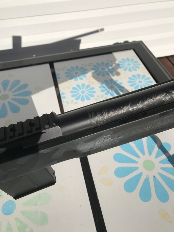

Turned out pretty good I think. Thanks to all for the tips and feedback!
