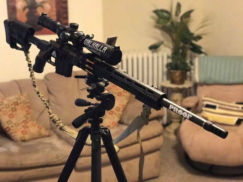

I have one in 6.5, I absolutely love it. I have numerous high end barrels and the Proof is my favorite. It is no more accurate then any of the top barrels but it weights less, runs much cooler, and doesn't shift POI after long strings. They look cool too and are cut rifled which I much prefer. I would not hesitate to purchase another.
I have one on a trued R700 as well which I use for hunting. Love it, precisely because of the weight savings. It it as accurate as my Bartlein. Chambered in 6.5 cm. Love that gun.
I've had consistent POI (no shift in zero) from 5 degrees to 75 degrees this winter. Accuracy is sub 1/2 MOA. Latest load testing session I had a couple that were shooting 1/3 MOA elevation spread @ 400yd.
In other words, pretty much the same performance I'd expect from a Bartlein, Rock Creek, Krieger, etc.
XLR Carbon chassis are super sexy!
