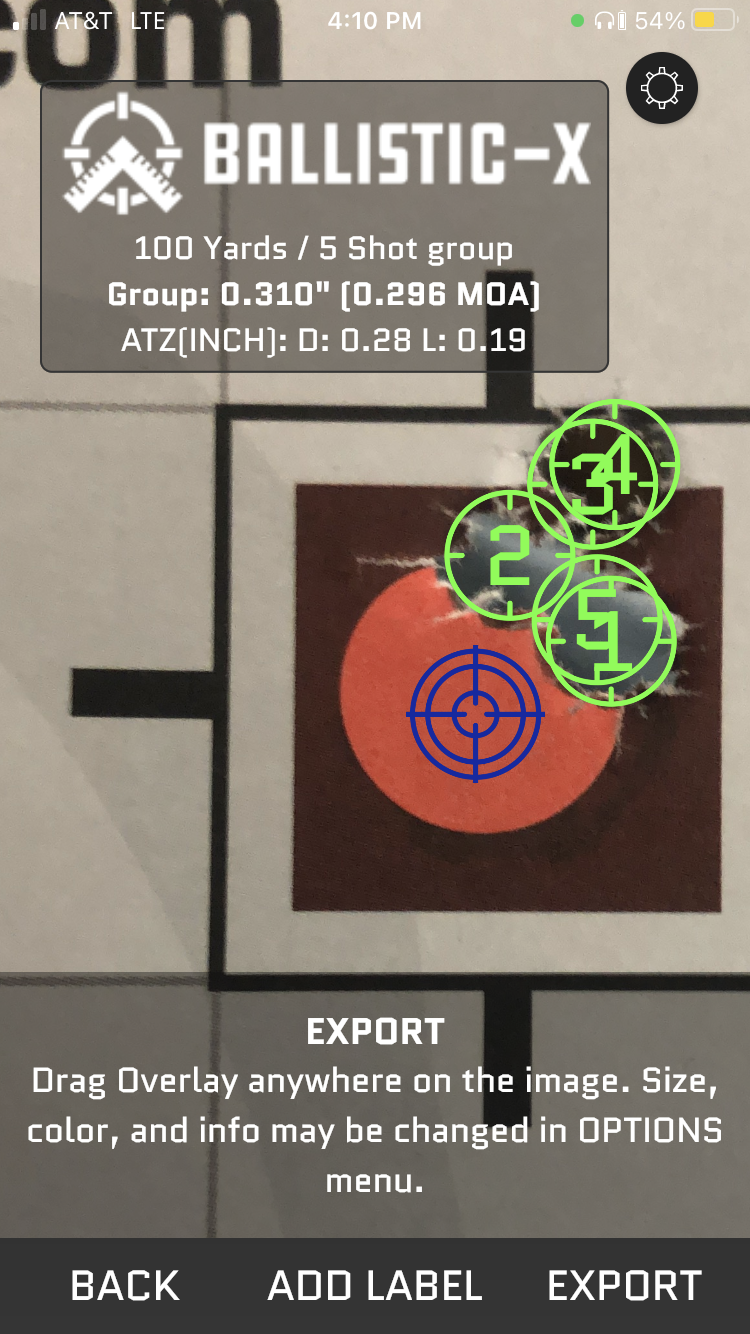

    I’m shooting a mild load of 38.2 grains of H4350 and a 115 DTAC. Starline brass and Winchester LRP. 2880-2900 FPS. 9 sd. Very accurate easy shooting load. This was shot today I have over 1200 rounds on the barrel. I was jumping the bullets .085”.
