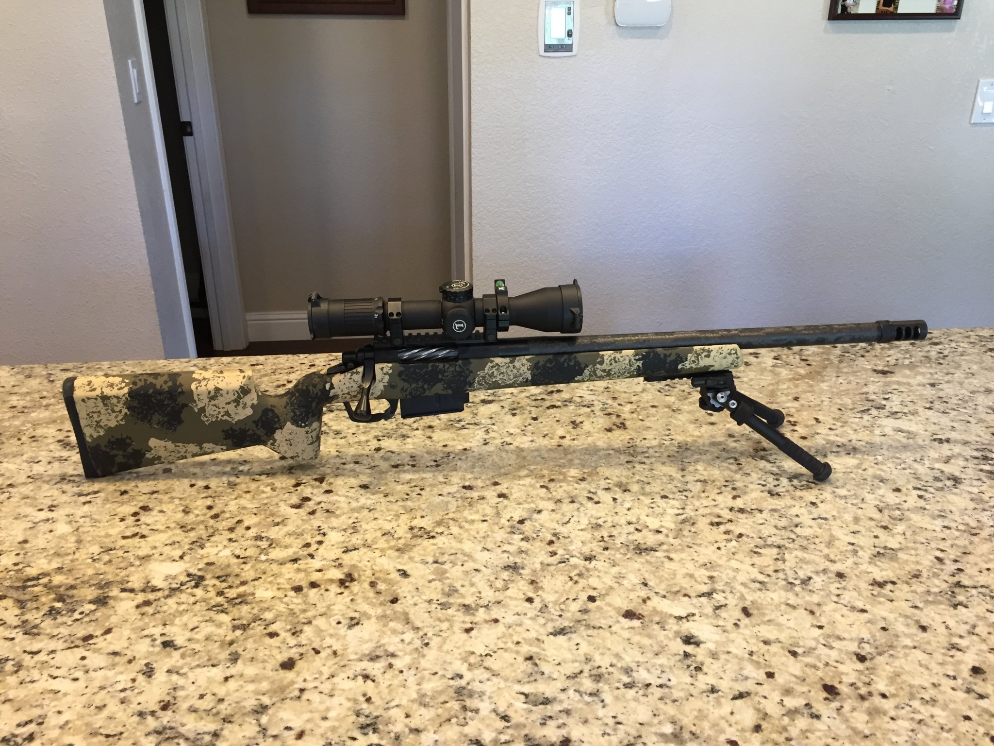

This is my work horse rifle. Defiance action, 20” Proof Scendero chambered in .308, little bastard brake, Timney Calvin elite 2-stage, in a Manners EH1.
Running the new 175 TLR’s at 2,590 fps. Just shot them at 200, 300, 500, 600, 800, 900, and 1K. Advertised BC was right on. They still get their ass kicked by the wind at 800 and beyond, but they do better than 175 SMK’s. I am very comfortable taking an animal out to 700 with it.
