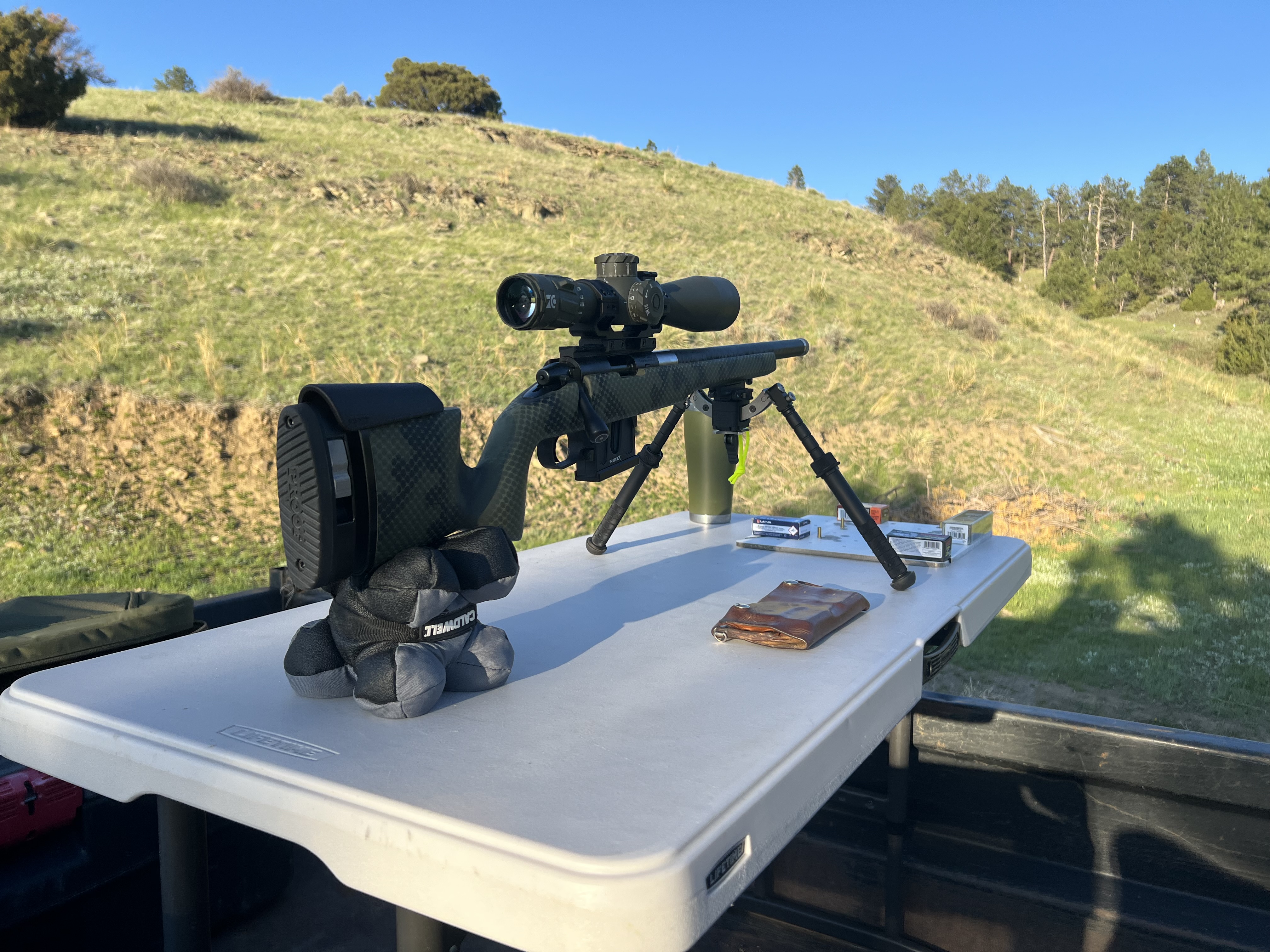

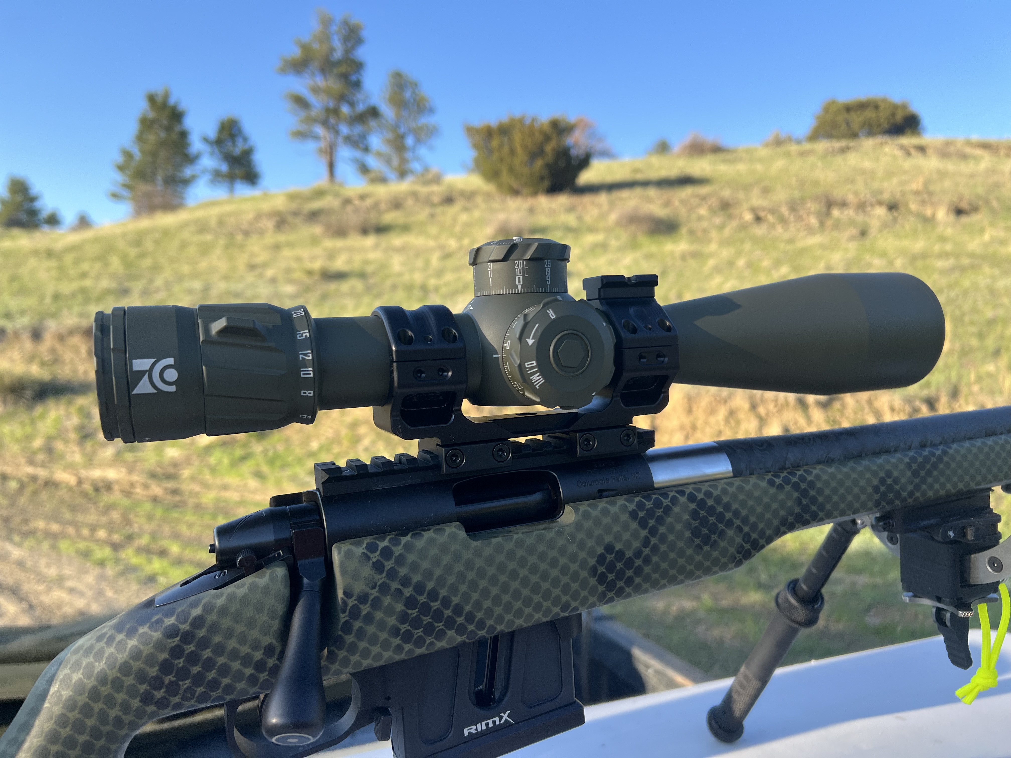

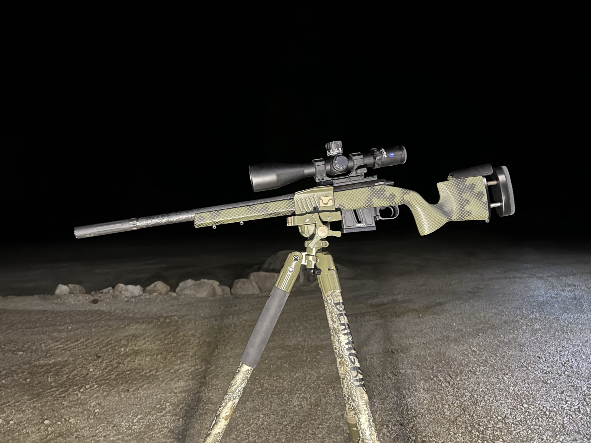

@BravoSector1 messaged me asking after this rifle I picked up for my wife. Been pretty busy so I hadn't done anything more than get the Zeiss LRP S3 6-36x56 mounted. <<<That scope is hard as hell for me to get behind BTW. Didn't notice it much when I was comparing it to my Trijicon Tenmile, but I sure did today. So he put the bug in my ear and I decided to break it out of the safe and see what it would do. Kinda lack luster results. Could be a bajillion reasons why, and I'm sure some of y'all will point them out to me :LOL:, but I have a few excuses ready. LOL.

Second. I was shooting on a slope off the tailgate of my side by side. I tried to get behind a Bog tripod that I bought a while back and I don't know if tripods just aren't for me or what, but that was terrible.
I'm curious to see your thoughts on that scope.......I've always been a ZCO guy and I have 3 of them but bought a Zeiss s3 6x36 and really liked the scope enough to buy another.....I have to get used to the reticle going from the IMPCT3x but its also a steal at $1865 shipped = compared to the ZCO's. I think it's pretty impressive so far.

Well that took a while. Life happened and we just made time to shoot this again last week. Just like me, my wife found this scope to be very hard to get behind. It is absolutely doable, but I’m going to look for something else. Suggestions?
I ended up setting up my enclosed trailer as a temporary shooting shack and everyone had a blast. I setup a bunch of targets we got from Atlas Target Works and they are all addicted to ringing steel now!
I bought a Fatboy Traverse 3 Section Tripod with one of their ball heads and wow what a game changer. My 9 year old daughter was transitioning from target to target with it like she’d been doing it for years! Last time they did any shooting was a little scoped break barrel HW30. And that’s been a couple years ago now. With the little range we have setup we should be able to shoot way more frequently.
