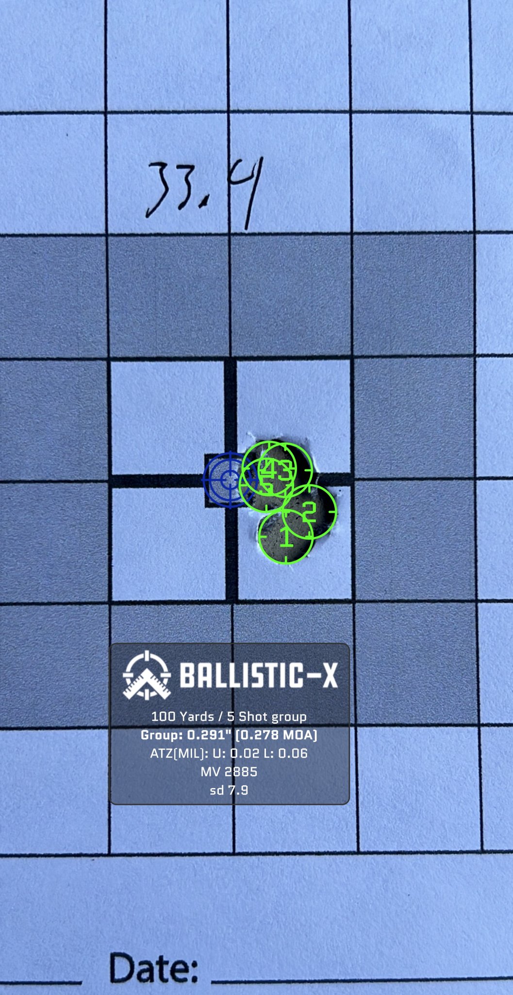

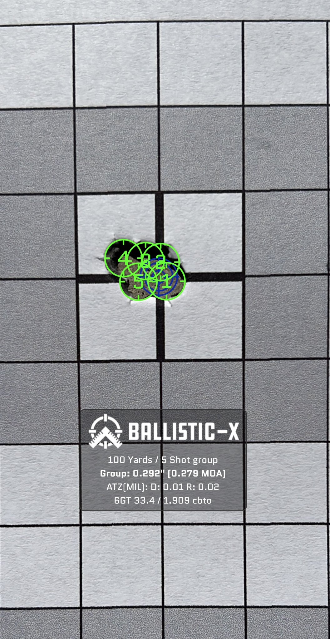

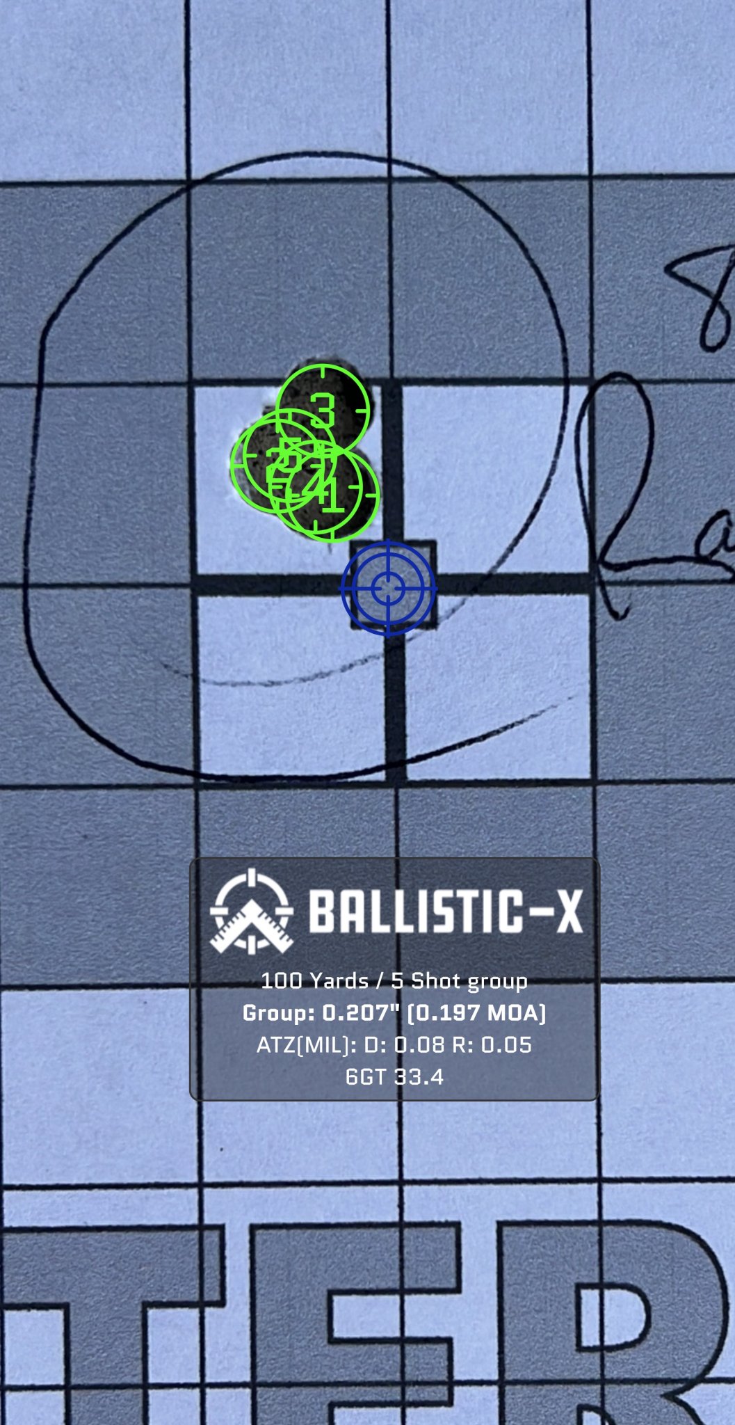

This is my first Proof steel barrel but I’ve had several Proof Carbon barrels and they all shot .25 or better with good reloads.
I have 26” Proof steel and carbon barrels chambered in 7SAW. They both shoot 0.25s and are within 20fps of each other with the same hand load.
Got a comp contour 6.5CM prefit on a TL3 that will shoot .5 consistantly with hand loads. Shoots between .5 and .75 with Hornady or Norma factory match ammo. I plan on picking up a few more in the near future.
