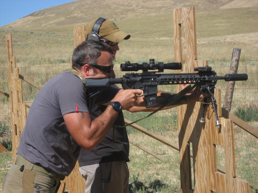

Here his SPR with PR barrel at Magpul DMR class:
