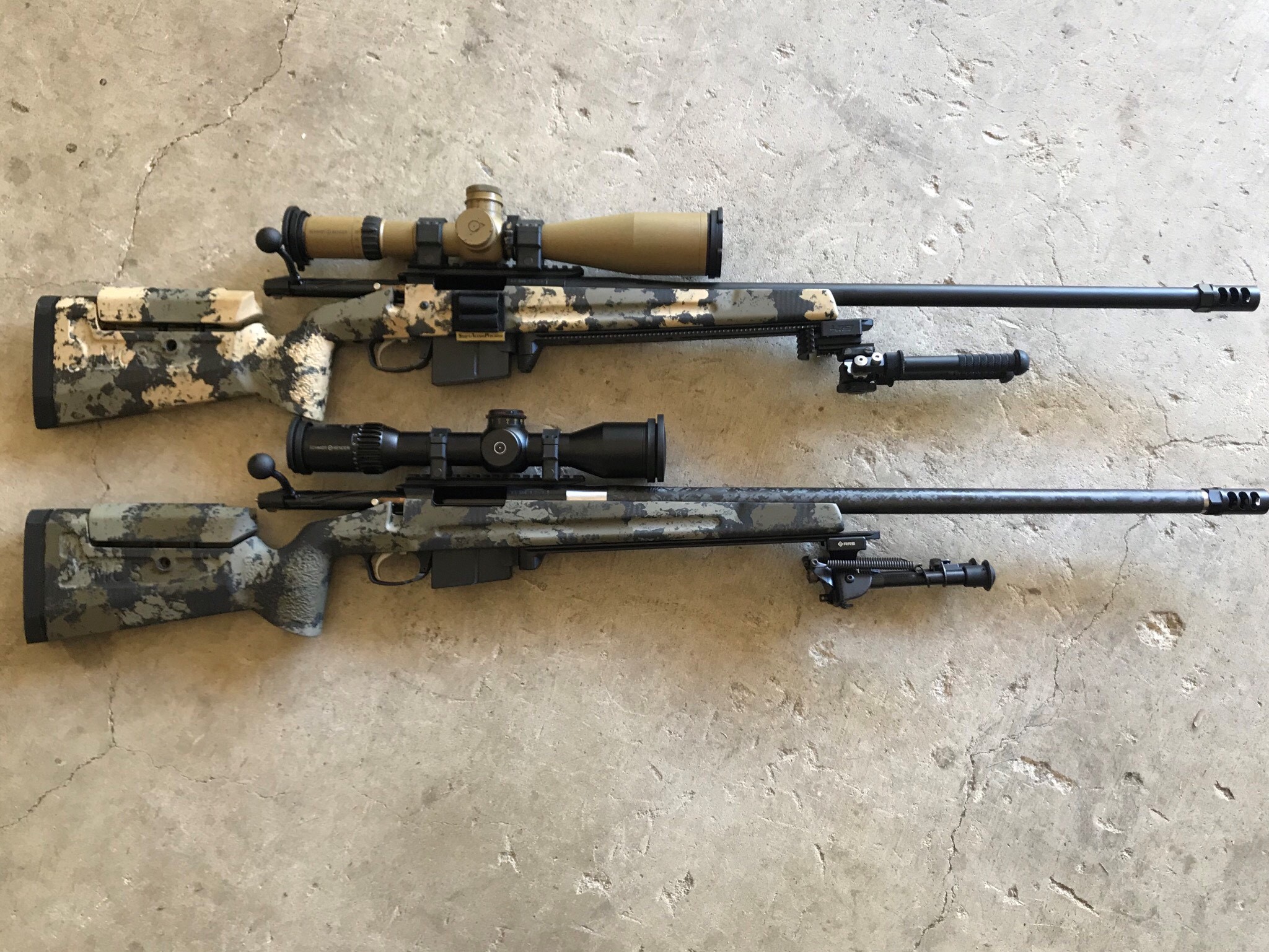

I used proof steel and carbon barrels to build comp and hunting guns that are almost identical. Balance is obviously different between the two, the bottom rifle is so easy to get up into the shoulder. Massive fan of the carbon barrel, similar results from the same load as well.
7075825
Simia Dei - what contour are those barrels and what do each of those finished rifles with scopes weigh?
Medium palma on the top rifle and carbon sendero on the bottom. I can’t remember their exact weights but I think it was 13.6 for the top rifle and 11lb for the bottom rifle. I’d have to go and reweigh them to confirm.
