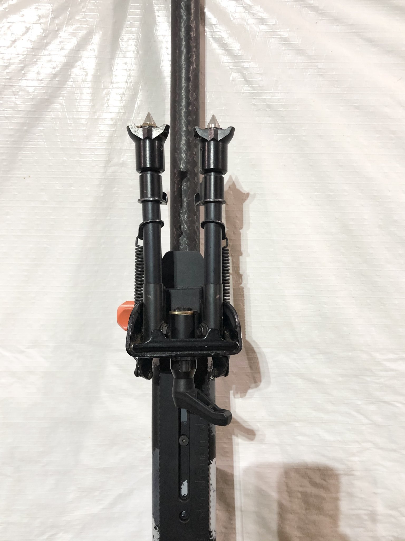

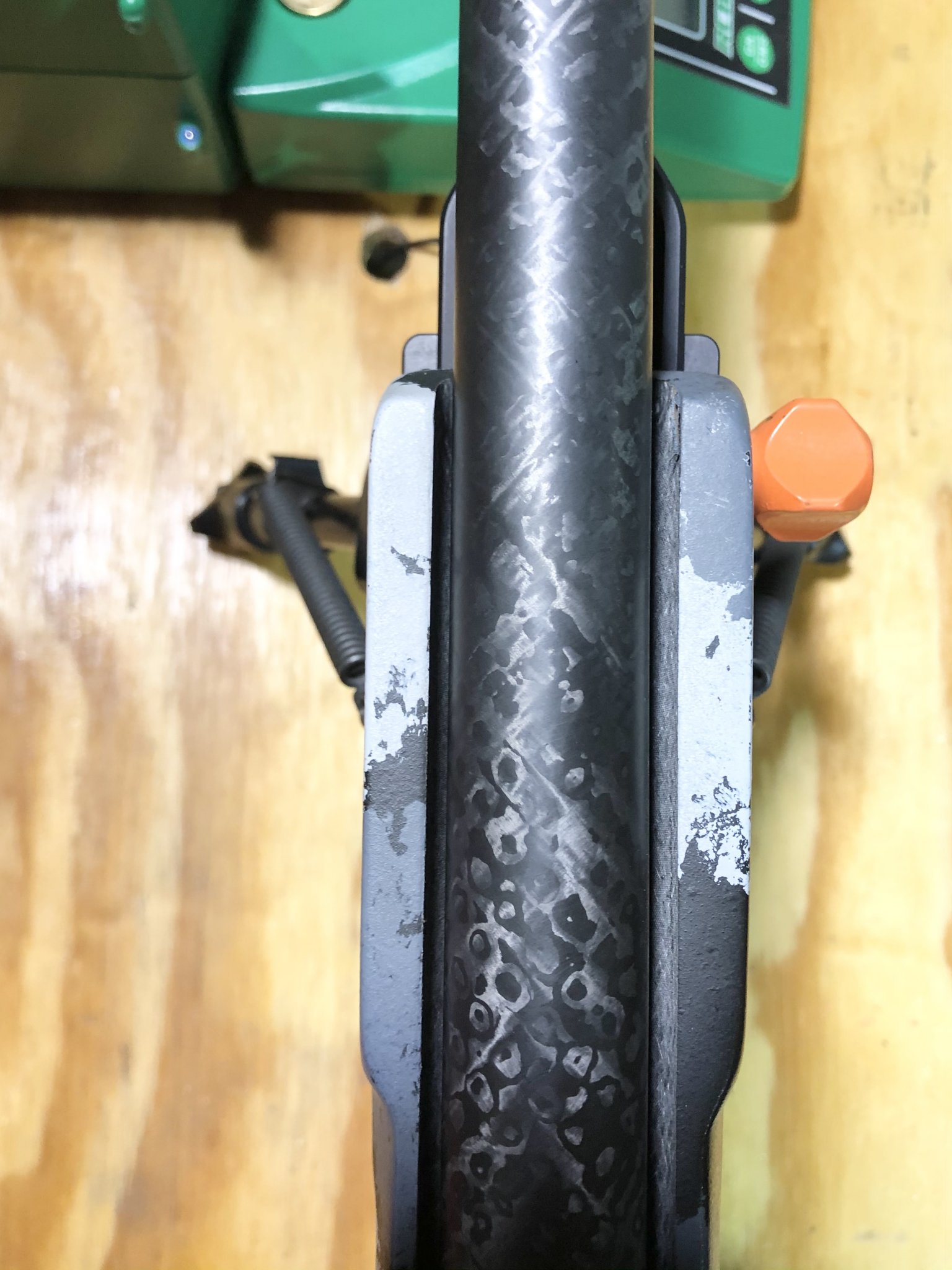

So I bought a Proof TL3 prefit for my Origin action. I also bought the HLR lug.
I have 3 other Shoulder Prefits for the Origin action, that run perfectly down the barrel channel of the stock.
I’ve measure the HLR lug and it is square. It’s a difference of .070” of gap between left and right side.
To me something seems unsquared, to be honest it doesn’t shoot that great.
Has anyone experienced the same issue?

Take it all apart and measure the distance from the chamber to the treads with a caliper in multiple directions. Should all be the same. Maybe placement of action in stock ... inspect and re-torque. I highly doubt it's a bad barrel. Eliminate all of the user controlled inputs first. I have the same recoil lug but have not used it yet so I am interested in the outcome.
I have taken the BA of of my Manners and put it in my MPA same outcome. The only thing I haven’t done is measure from the shoulder to the breech.
It’s not cross threaded.

While I think it's unlikely, check that the junction between the breech shoulder and the recoil lug has no gaps. It is also possible that the barrel bore is not concentric with the OD. Look at the muzzle and see if the bore is concentric to the OD. If you measure it with calipers, be careful not to damage the crown. Best to use a pin/plug gauge in the bore, then measure from the pin/plug gauge.

So I removed the barrel and flipped the Lug over and pushed the pin through to the other side. Reinstalled and torqued and placed back in the stock. The barrel still aligns to the left side of the stock.
Don’t see any gaps between the action and lug or the barrel shoulder and lug. But since the barrel still favors the left side of the barrel channel after I flipped the lug, issue doesn’t appear to be the lug.
