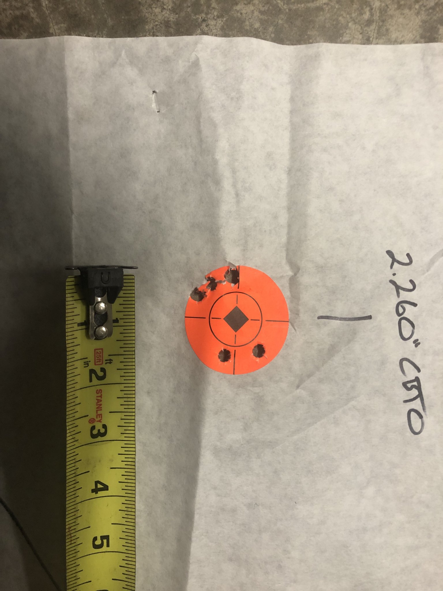

I had good luck with a Proof prefit in 6 Dasher for PRS. Just pulled it at 2400 rounds but was shooting great. Screwed on another Proof prefit in 6 Dasher to finish the season. Plan on swapping back to the 2400 count Proof prefit in off season for practice.
Reactions: MattK1

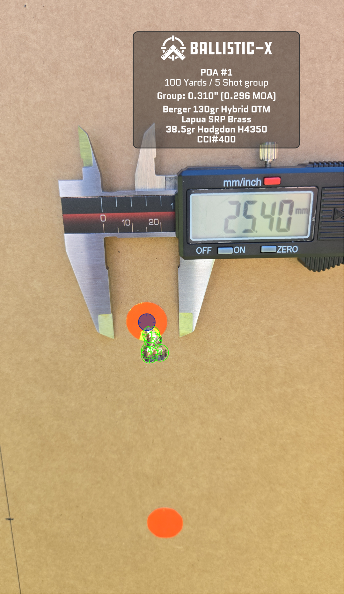

I know you have already made your decision, but thought I'd share my experience with a proof prefit anyway. It hammers!
Here are the first five rounds of my reloads after running 40 rounds of a couple different factory rounds to break in.
The load was one I had worked up for a different rifle. I don't know how much better it will get with a full load work up, but I'm not mad with the results so far.

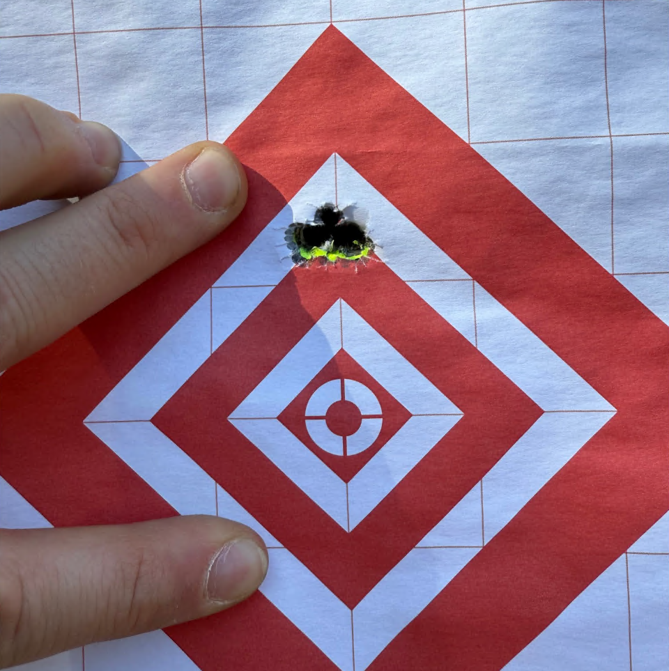

To follow-up on this, first 10-round group at 100y I tested through my recent 26" Proof SS prefit with 105gr Berger HT's in virgin alpha brass.
She hammer'n - No issues from me.
