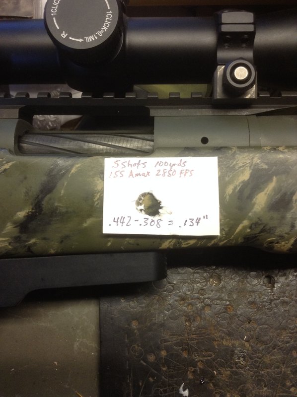

Bartlein.....l never had a proof carbon. This is a group during barrel break in from my latest build with one and I am not sure how it could get better,
