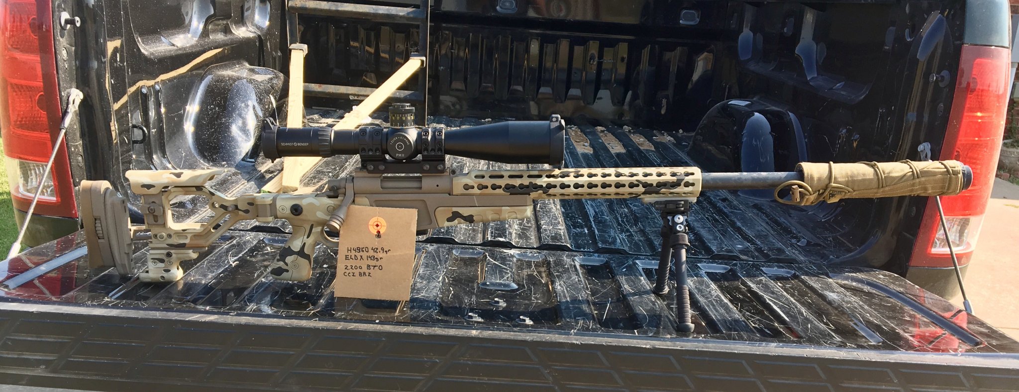

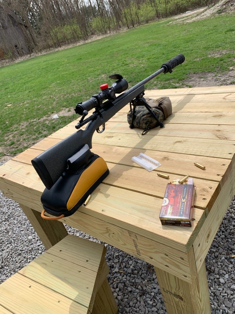

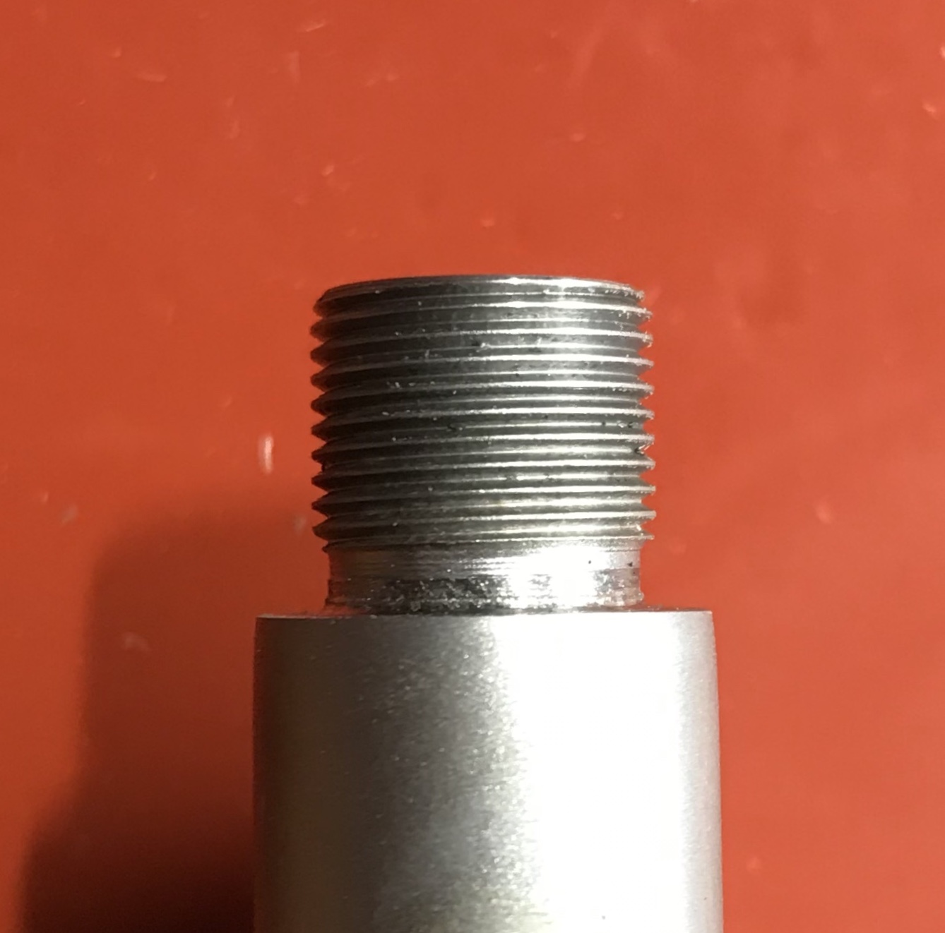

Have tenacity action, 22” proof sendero chambered in .308 (10 twist) that is dropping shot to shot with a TBAC 30-p1. Stock is a AG composite. Suppressor is fine and shoots great with other rifles. Target was duplicated back to back weekends from a cold bore. Shooting different factory loads with the same results. When the suppressor is off it will shoot 1/2” with 168 Berger hybrids from federal. Has anyone else seen this?

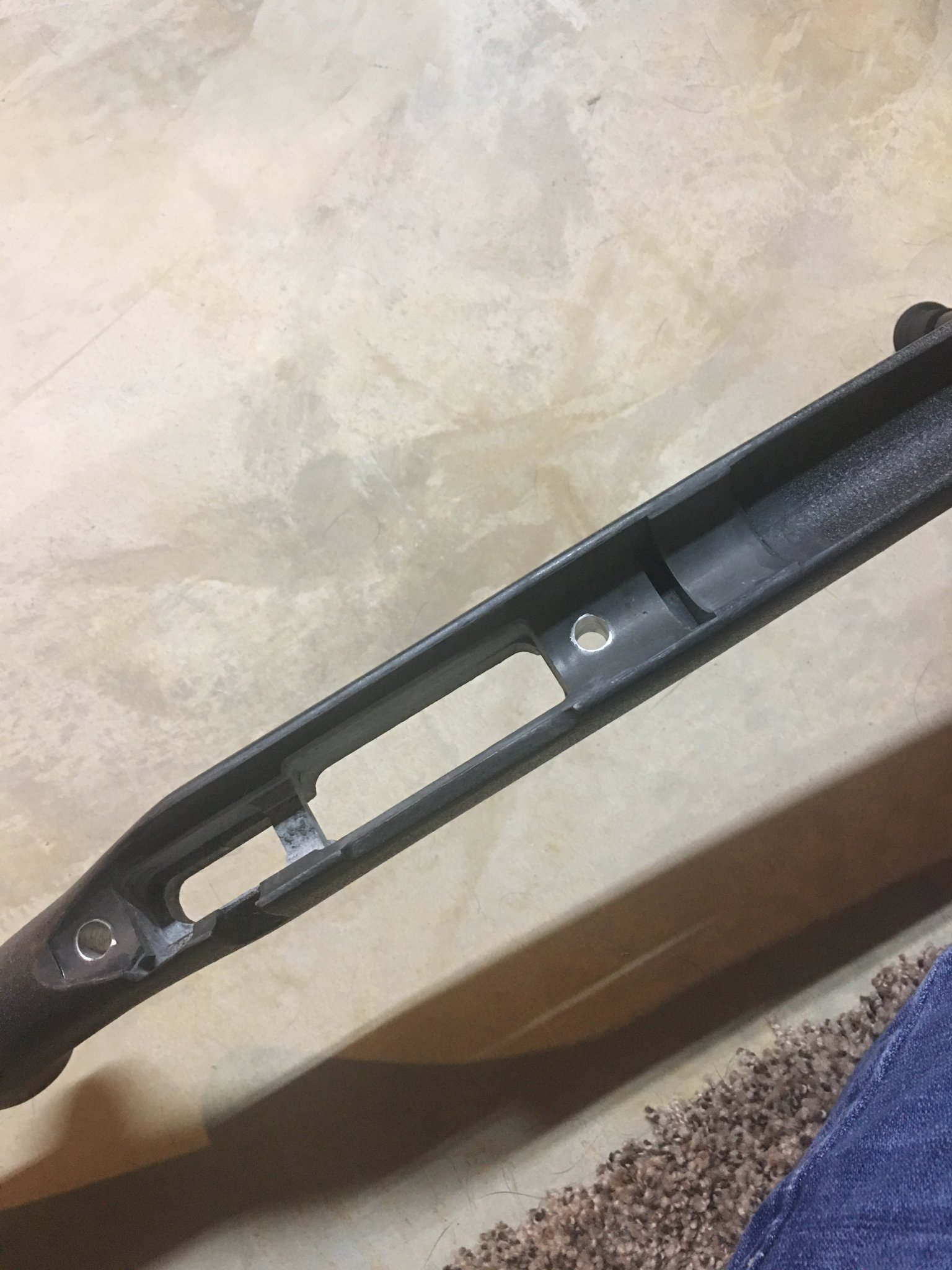

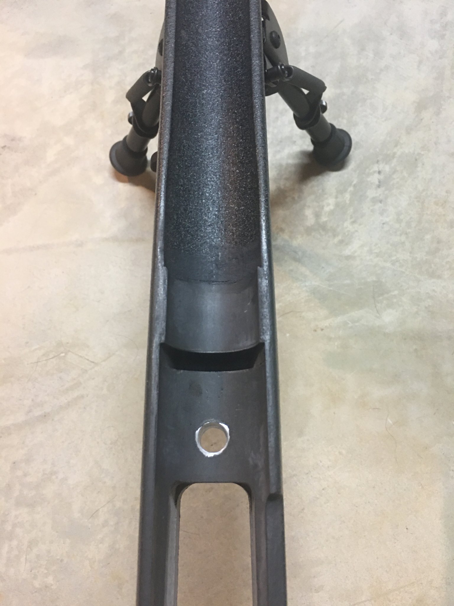

Yes I even separated the action from the stock to check free float or anything else that could cause bad accuracy. Re-torque the action screws alternating back-and-forth 5 inch pounds at a time to 55 inch pounds The action was bedded when it was built.

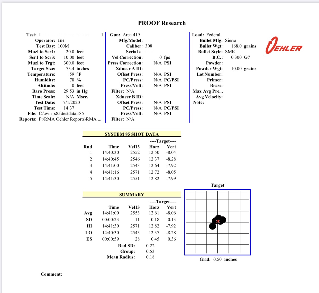

I run a TBAC Ultra 9 with my Switchlug and 20” and 22” Proof CF barrels and have zero problems. I’d be checking stuff like action screws, scope screws and making sure your suppressor isn’t coming loose while shooting .
Tried my Nightforce ATACR and a Nikon both with same results. Direct thread can and I check it often. I don’t shoot strings or more than 3 rounds in a minute.
here is another target with some more Berger’s. I shot the group on the right with the can on then while still hot took it off and put two on the black target to confirm it’s not me.
what the heck?
Any pressure signs on the brass when shooting suppressed?
edit: you shoot any other ammo through it w/the can on? If so, similar results or different?
I know with my cans and rifles, if the load is too hot, the gun will send shots low and to the right relative to the normal POI.
Still free float
poi isn’t consistent. Cold bore or warm moves lower with each shot.
no prefit. It was a custom build from a well known smith and is going to do some testing with it.
no pressure signs with the can on.
targets were shot at 100 yards
Interesting case...problem seems to be related to the presence of the suppressor (not saying the suppressor itself is the problem, just it’s presence on the rifle).
Did this just start happening last weekend or was it always an issue?
Edited: just reread OP and multiple factory loads were shot with the same results.
You can rule out pressure as a potential issue by using a micrometer or dial caliper to measure the thickness of some unfired cases just above the extractor grove then measure your fired cases when the suppressor was on...if you see more then .002 expansion, you have an over pressure condition but ejector/extractor marks and primer cratering wouldn’t be visible yet...I dont start to see that stuff until the brass is expanding .003+
Like a few others said, it’s most likely timing differently with the can attached. Rather common. If you don’t reload, best thing you can do is try different ammo brands to shift you into a different node. If you reload, then back to the drawing board with load development.
Suppressed shots have been stringing down since the beginning. Never had a round come back up like I’ve seen on a semi-auto.
This is a brand new build that has maybe 50 rounds through it. Shot 1 and cleaned 1 first 10 times. I know break in doesn’t really do much different than if I hadn’t but I do it anyways.
no pressure signs from any loads. Can on or off. I did shoot some 175 smk hand loads I had from another gun but it didn’t like those. It will shoot most factory ammo .75 or better. The 150g cheap stuff I used during break in where almost 1”. 165 trophy noslers were not much better until I got into the 168 ammo.
Wow, new build. Scope, ring and can issues.
darn...
like my dad always says just rub some money in it and it will go away.

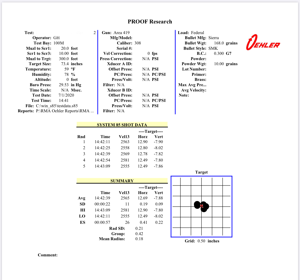

Rifle has been sent back to the smith for them to test on. On a better note I took out my stock rem 700 16” and shot it to rule out me and the suppressor. Still using factory ammo. Same bipod and bags and the same cheap Nikon scope. First target was win 150g power points. Not ideal for a 10 twist. 4 shots after sight in. Second target is federal 168 smk 3 shots.

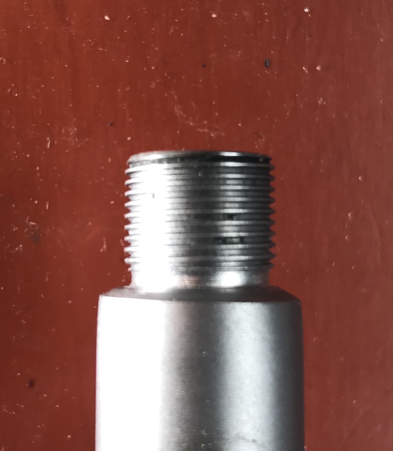

My first reply here....but this is just one minor check that will cost nothing.
take a couple of good High Def photos of the threads and SHOULDER of the muzzle.
one of my rifles was accurate, however with the suppressor attached...the impact was unreasonably shifted.
Several gunsmiths could not diagnose the culprit.
Good High Def photos of the threads and shoulder revealed the threading job was straight and true.....but the shoulder was not perfectly square. It was minor...almost unnoticeable, especially with the thread protector installed, but when the suppressor was tightened,
it caused a shift in impact.
The barrel was removed and the shoulder was squared. The threads and crown were not touched. They only took about 1/100th to square it...but the results were no shift in impact with or without the suppressor.

I took the gun out again this time shooting the first 5 rounds unsuppressed clean cold bore. Using 175G black hills ammo, first round was low right the rest of the groups was me but stayed together.
the 30-p1 went on for the next 13 rounds. Using a bipod and a rear bag took my time and watched what I had seen before. Shots starting walking down as if I was dialing for it. This time on the drop it looks as if it were pausing every other round. Here we go again! Another 5 months this gun would sit at area419 if I sent it back just to hear it shoots fine.
with the chamber open my wife and I went down range for a closer look. No more than a few minutes. Proceeded to shoot for a second group on the left side of the target. I settled in and let one go. Already I could see 1” low of aim. So the next 6 rounds that where left in the box I loaded the bipod and continued to shoot. Still With a low Poi i was able to produce two 3 shot groups close to each other. Best I've seen this pos shoot to date. Now I’m baffled how after 3 rounds the group shifted and produced another 3 rounds. I’m starting to guess that’s why area419 sent photos of 3 shot groups and not 5.
so now is this a bedding or AG stock issue? I don’t want to go on a wild goose chase so I will swap stock and go shoot again soon.

I'll add that if your stock is very close to the barrel (tight barrel channel) and you are using a very heavy can, it could be hitting the stock. I can almost guarantee it.

Here is 2 pictures of the AG stock
