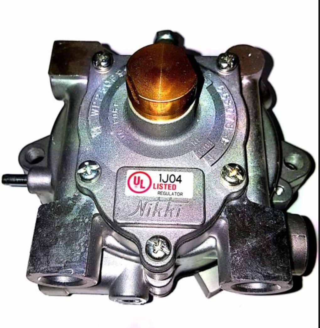

There is a member here in Southwestern WA who is an expert on propane issues. I would PM him.
His preference is this model regulator.
