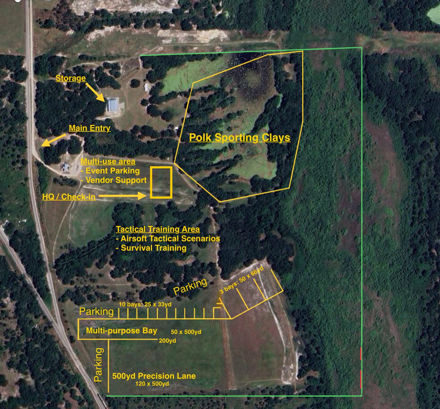

Well I'm glad you asked.
Real, real soon you'll have a place off off Highway 37 a couple miles south of SR 60.
It's called Bone Valley Range.
Initially, it'll have a 500yd range and a bunch of pistol bays that will allow run and gun stuff.
We're still working on the purchase of the adjacent property which will allow for a mile.
I'll be out there working tomorrow.
This is an old layout design from quite a while back, but it's still fairly close.

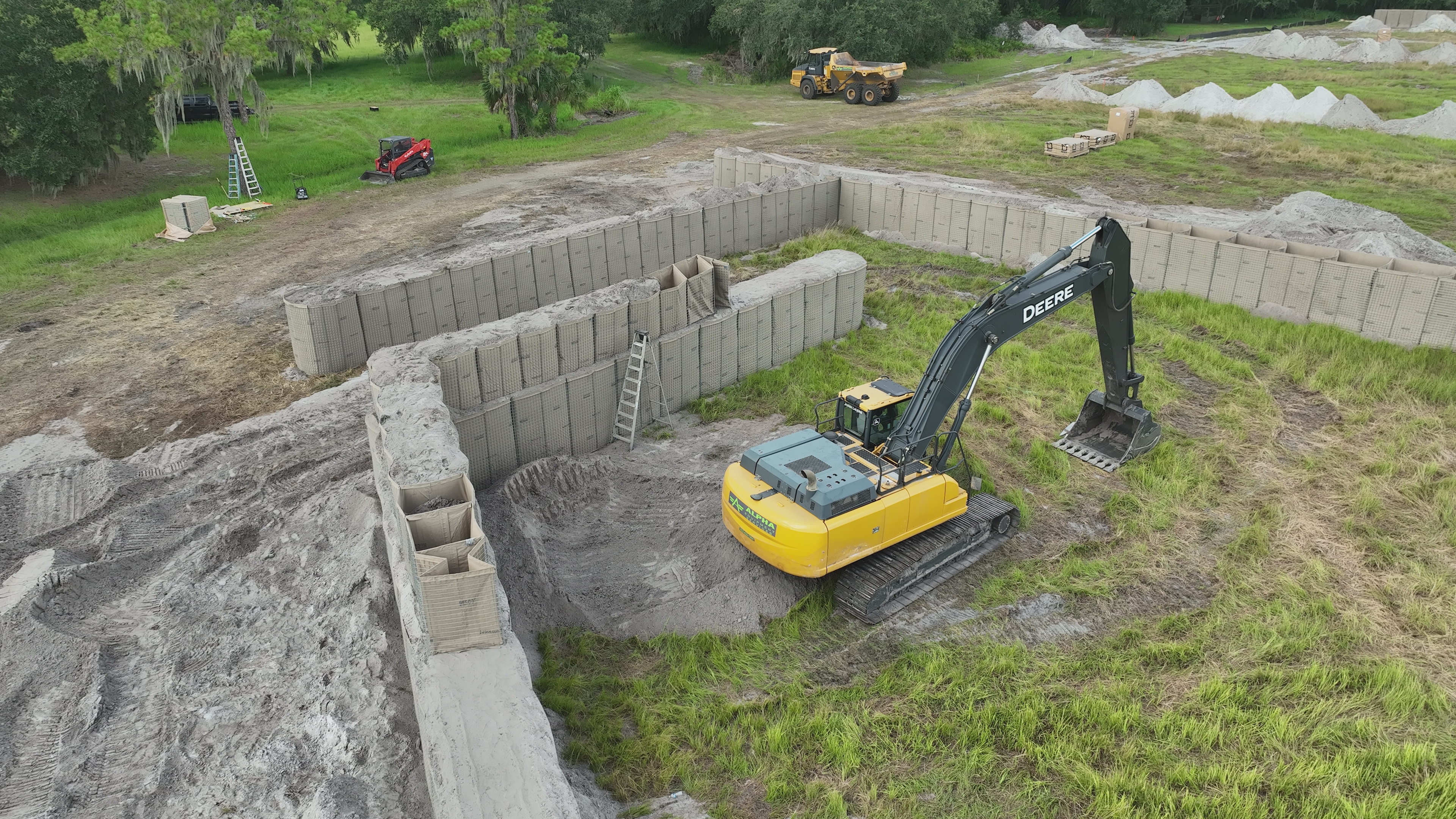

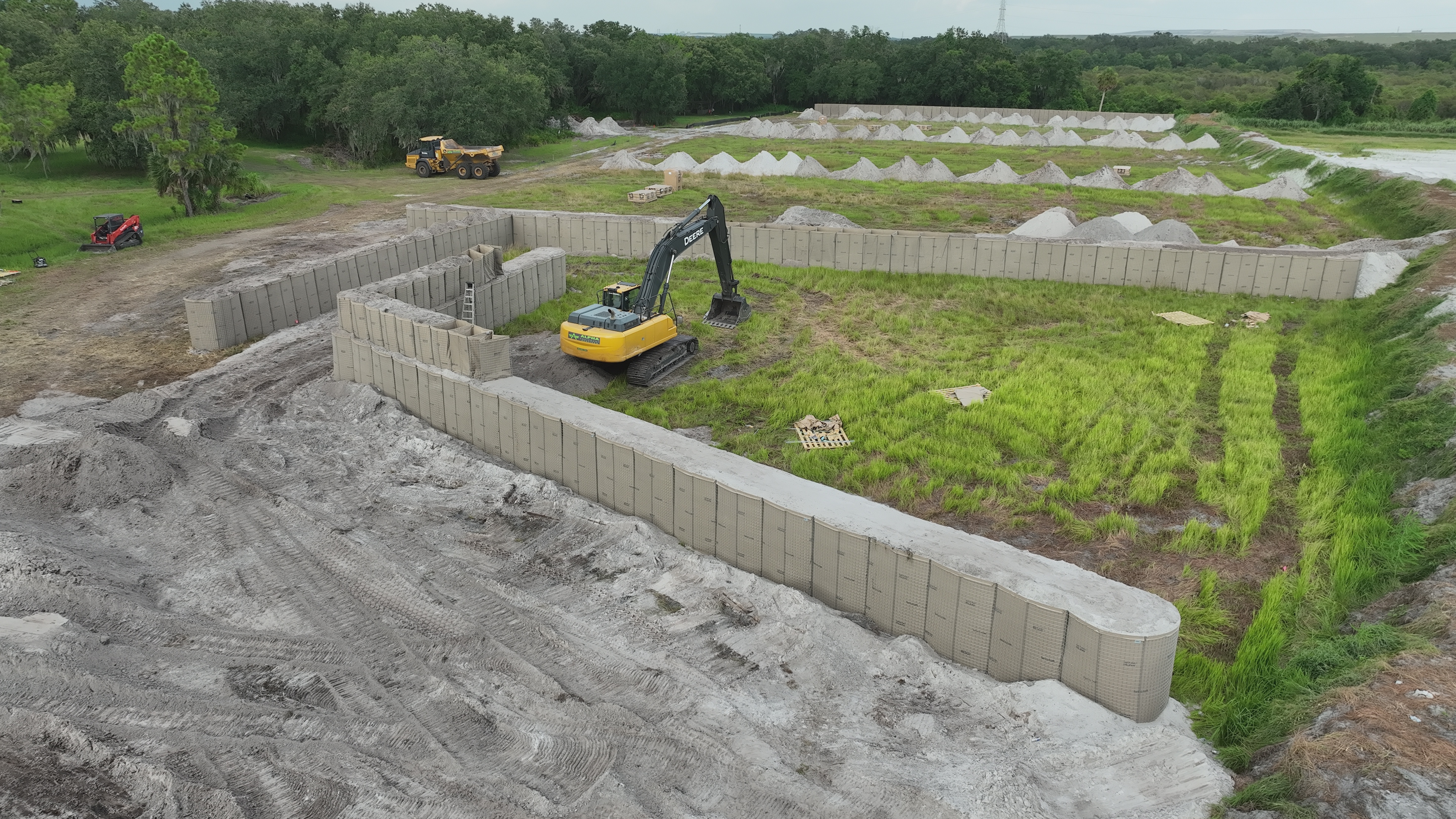

I say "we" an awful lot when I refer to this range.
Let me be very clear, it's not my money.
I'm just helping out whenever and wherever I can.
Lately, my contribution has simply been Mick's/Miguel's/Mike's lawn and garden services. It's something that needs to be done and I'm available for it.
There are at lot of great people responsible for the design, implementation and pure labor to get this place up and running.
We were having a hell of a time trying to figure out how to get the mile range laid out.
@lash came up with a simple design that we couldn't, because we were literally just to close to see it.

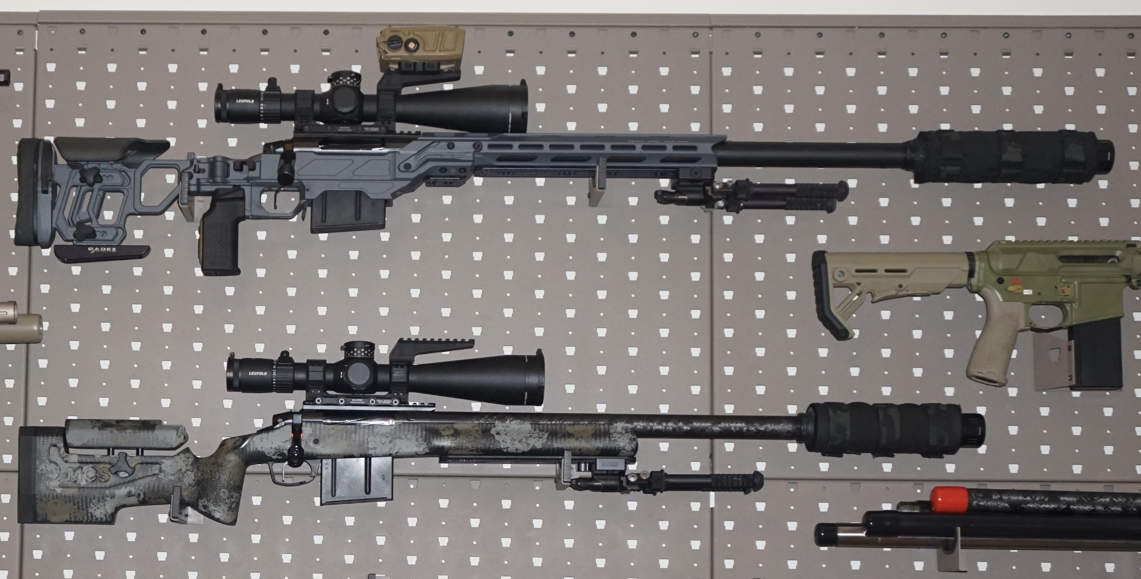

Re:rifle balance
In my KRG chassis and AIAT experience, both chassis have a rearward weight bias. Adding weight just to the front of the chassis just sorta helps.
But what really helps is a heavier profile (Rem Varmint or thicker) steel barrel at 24”+. Plus a suppressor. Way more effective leverage (or whatever you call it).
