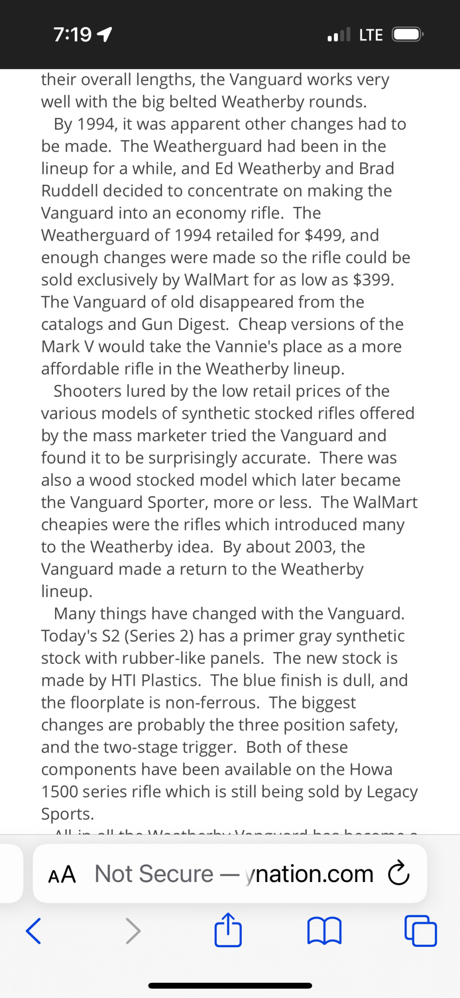

This excerpt sums it up nicely regarding the timeframe and accuracy but doesn’t address where they were made or by whom. I bought mine at Wallyworld on sale for $399. Reading a bit further it does seem to be rebranded and made in Japan. A few differences but pretty similar per all the discussions I’ve briefly read. I always thought that was in regards to the S2 Vanguards so learning something new this AM. 🍻
Interesting info on the history.
More interesting info, for my day job I am a Mechanical Engineer at HTI Plastics. I didn't that that us making the stocks was out in public domain.
