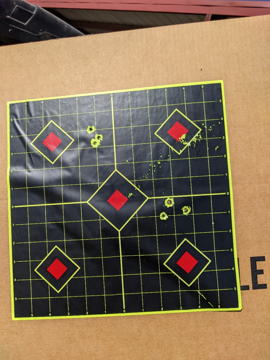

First time on here. Here is my situation. I have a Ruger American chambered in a 6.5 Creedmore. The rifle has a composite stock, a 22 inch barrel with a 1:8 RH twist. The scope is a Vortex Viper 6.5-20 x 44 dead hold BDC moa. suppressed by a SilencerCo Harvester 300. Ammo is Winchester Deer Season XP in 125 grain. Ballistics table says I should be 1.7 inchs high at 100 yards to be dead on at 200yds. The day I was shooting there was a slight cross wind of around 5mph. I was on a solid bench, bipod and sand bags, so I feel like I was steady. At 100yds I was within 1/2 inch group, but at 200 yds I was 2 1/2 to 3 inchs wide right and about 1/2 inch low. I'm fine with the 1/2 low but being that for right has got me really concerned. I will have shots from 50 yds to 500 yds so I could imagine how for right I would be at 500 yds. Any suggestions as to what might improve my accuracy? A friend suggested I get on here and ask for advice. He thinks it has a lot to do with harmonics, the grain weight of the bullet and manufacture. Any suggestions would be much appreciated to increase accuracy.

1 I have a good zero at 100 yds
2 I believe it is level.
3 yes. without the suppressor the group was 4 inchs high and 1 inch to the left.
The three shots to that are high are without the suppressor the three to the right are with the suppressor. Big difference.
The easiest next thing to try is different Ammo, I would try something like the Hornady 143gr ELD-X. That gives you a completely different dynamic with a better bullet and a heavier bullet.
The suppressor is really pushing you to the right so you may want to look at how it is mounted. Could be a very light strike inside the suppressor (unlikely) so check the inside for impact marks.

AllenOne1, I have a similar situation with a Savage 110 High Country chambered in 308. It has a 1:10 twist. I am shooting Federal Power Shok 150 gr bullets in it. I have a Sig Sauer Sierra 3 BDX 4.5x14x44 on it. At 100 yds I am suppose to be 2 inchs high at 100 yds to be dead on at 200 yds. again I am 3.5 inchs wide right and .5 to 1 inch low. I am using a Harverster 300 suppressor on it as well only a different one. What grain bullet or what ammunition would you suggest I shoot in it? I have come to the conclusion that the suppressor is the problem and I am waiting on a response from SilencerCo the manufacturer.
I'm not a 308 guy but I would probably recommend a 178 gr bullet.
Having the same issue on two guns with the same suppressor is interesting, starts to point to the suppressor doesn't it?

I don't think your issue is gun or ammo but the scope not being level. I see it all the time especially on left hand shooters as most stocks are made with righties in mind. Very easy to correct. Put a level on a base, drop a weighted line down on something and make the vertical wire parallel with the string.
