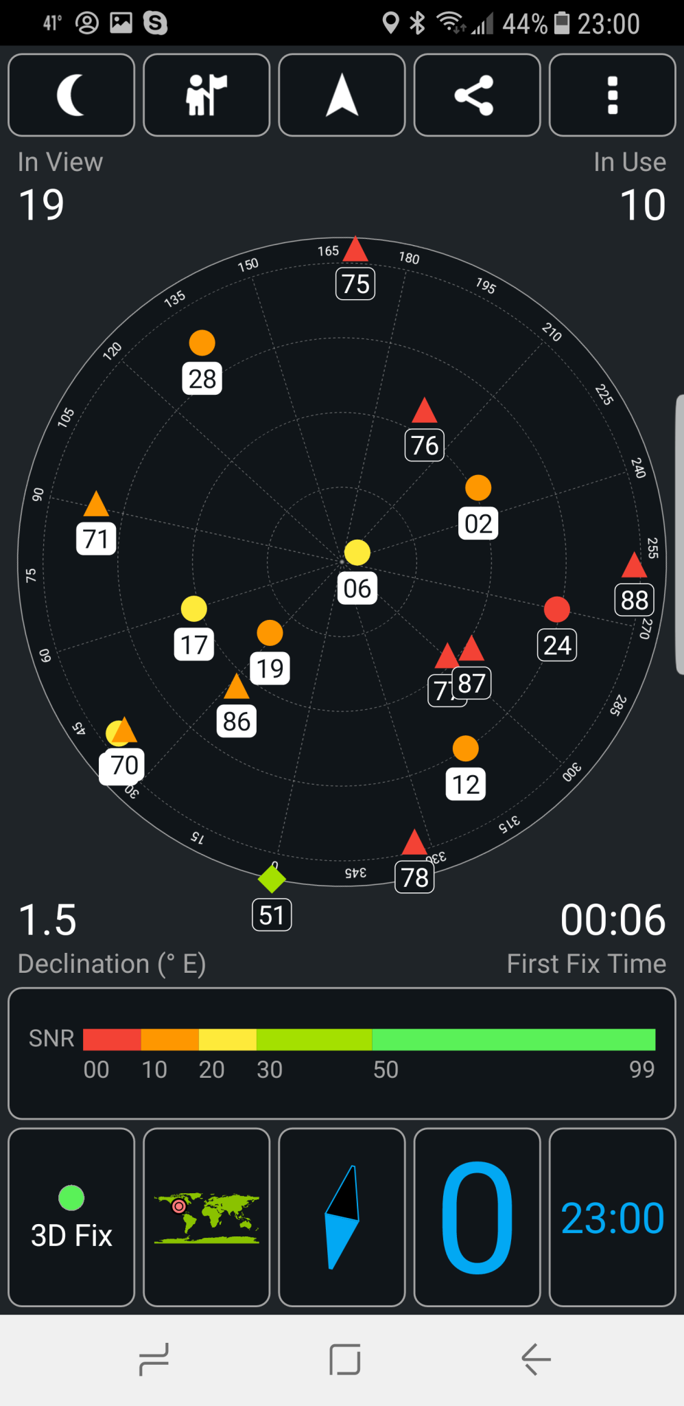

Unless in a cave, no.
Sure, more satellites will be not in view at all times, and orbits do mean they move around, so there can be issues, but unless you are in a deep and narrow canyon, you should always get position, even if lower precision.
For those that don't know (and a lot do not!), it is worth knowing how to read the GPS screens:
The diagram is a sky-oriented map. As used by astronomers. The outer ring is the geoid horizon, say if on the ocean. Center is straight up, etc. In the mountains you can orient this, look around and pretty quickly get a guess about how well things receive or if something is likely out of view, decide if you can move down the valley or up a little hill to get a better position.
Also note the useful in-view vs in-use values. In-view is a lie, and means "on the diagram," or "could be in view if you were on a parking lot hundreds of miles across. In-use means in use, but once all the signals are synched, means how many are in /actual/ view. Noticing which are locked after a bit helps determine if a sat can be added to your data by moving up. I have had them go from out of sight to lock by raising the unit over my head.
(Also, most receivers are not GPS but multi-band GNSS. Those are both GLONASS and GPS satellites on that image.)

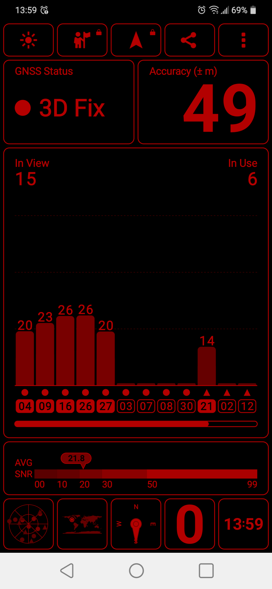

Also this:
Somewhere it will give you the accuracy rating. Upper right, here. That's an actual value. Basic GPS stuff is: time+lat/long/altitude/accuracy. Always. Accuracy is the radius of an R68 circle, meaning you have a 68% chance of being inside the circle (there's no such thing as R100, due to probability, so they had to pick a number).
There is also geometric dilution of position. If the satellites are all clustered up, the angle between each is too small so it's harder to get an accurate fix.
I can go on about this for days :)

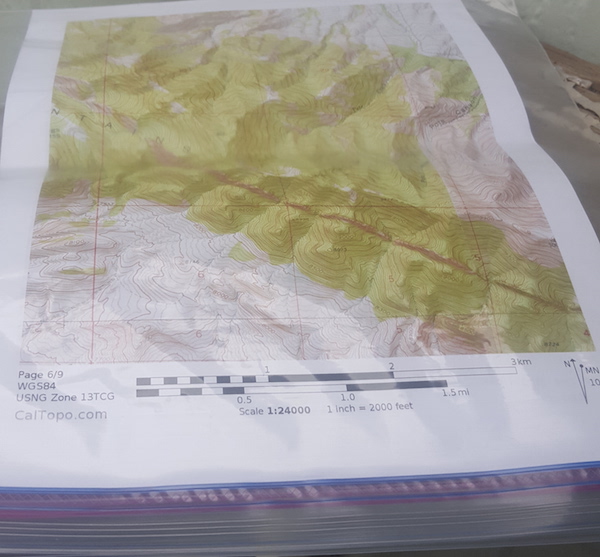

For decades, gallon zip-loc bags have weather-proofed the maps of the staff and tens of thousands of our students through New England, Alaska, and Norway. Staedtler map pens go well with them. Permanent are great given the inexpensive nature of the bag. The non-permanent (wet-erase) if you must re-use and/or make adjustments on the fly.

Zip loc are great idea!
The only issue is maps typically need to be folded to fit inside either your pocket or the zip loc itself, which may complicate the situation.
And over time folding copy paper maps will start to wear. But that might be secondary concern depending on priorities.
Digital gps maps could in theory also be custom sized and printed to lay flat for marking vis the bags, Maybe worth condidering.

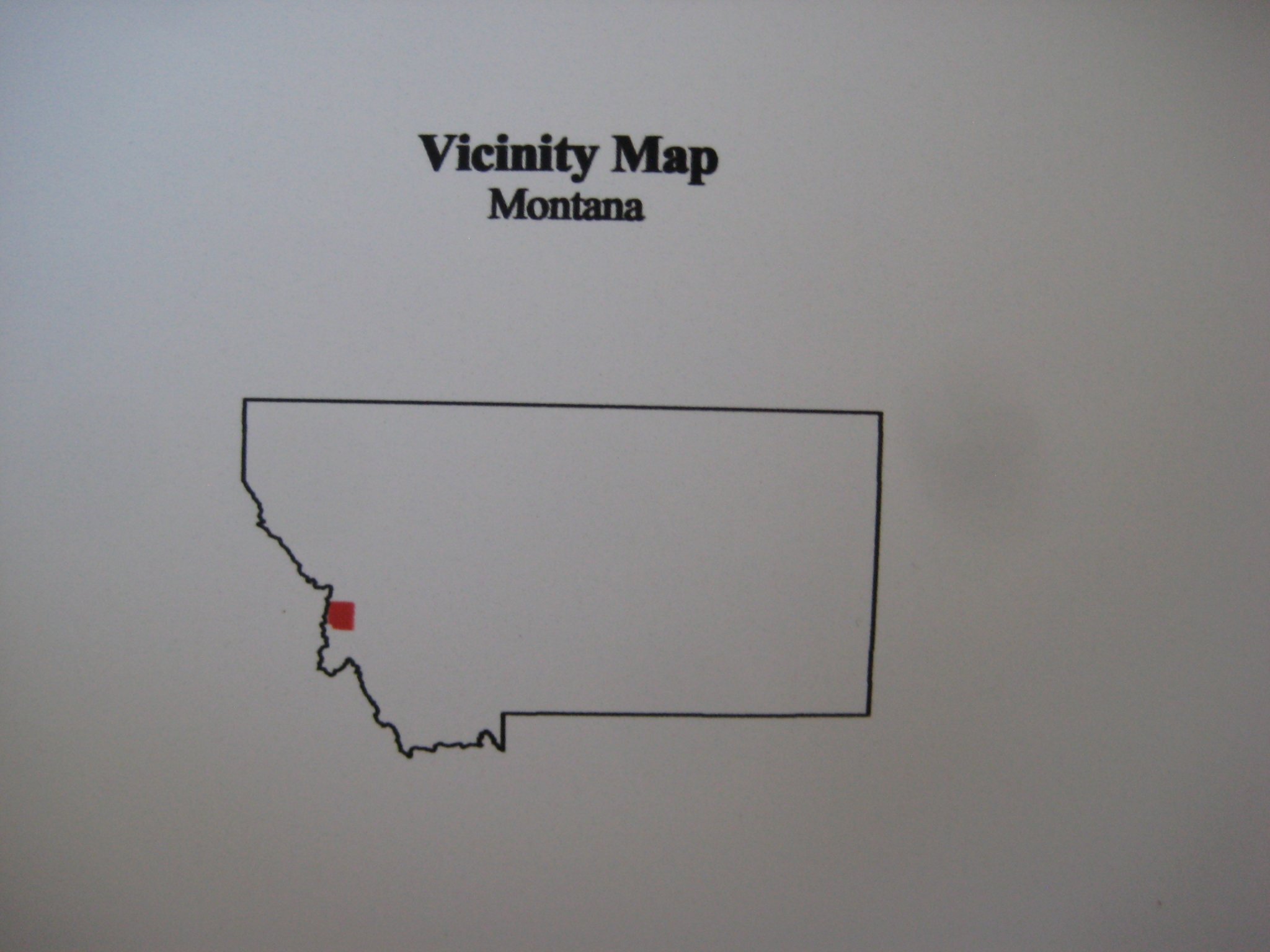

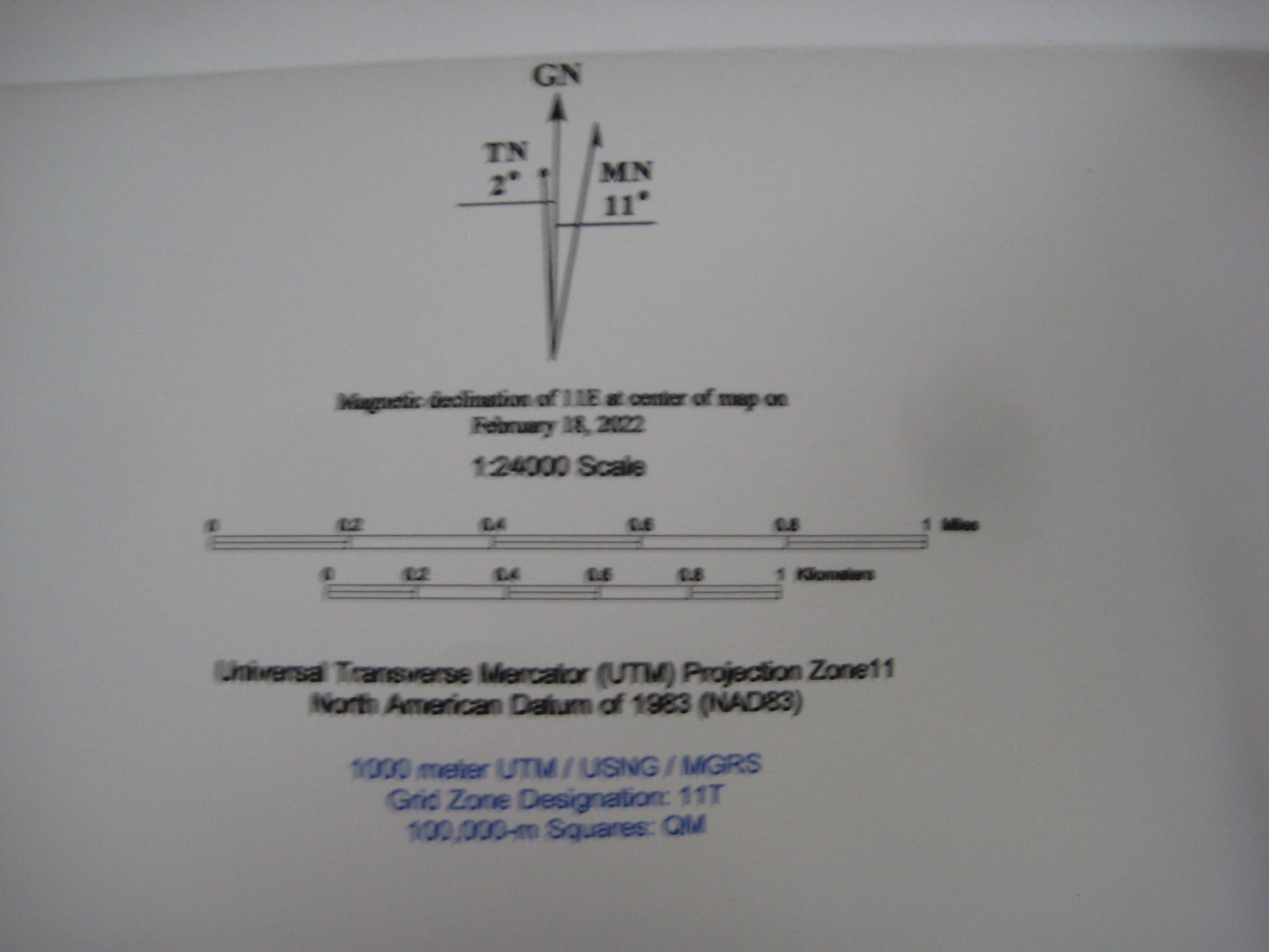

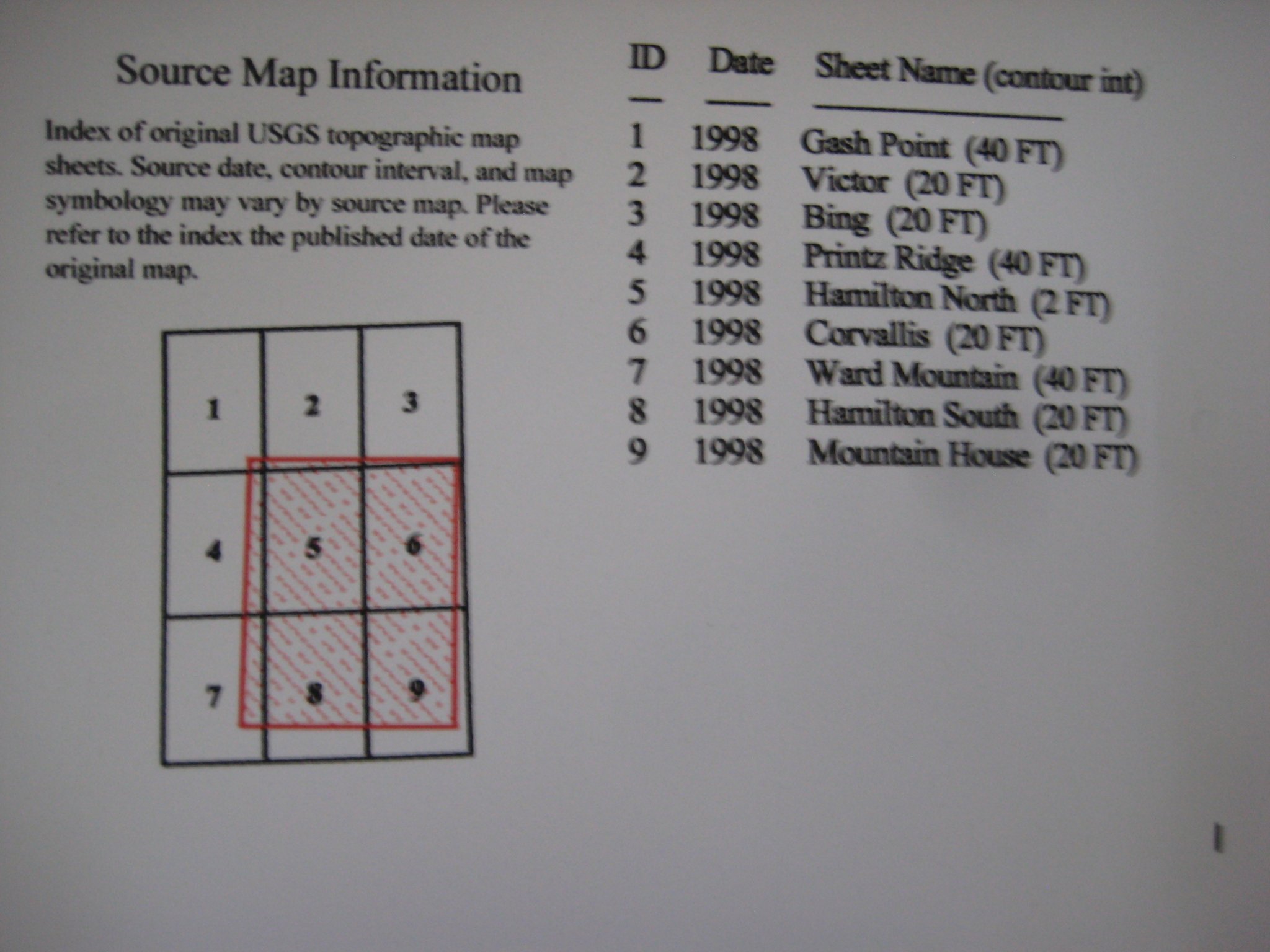

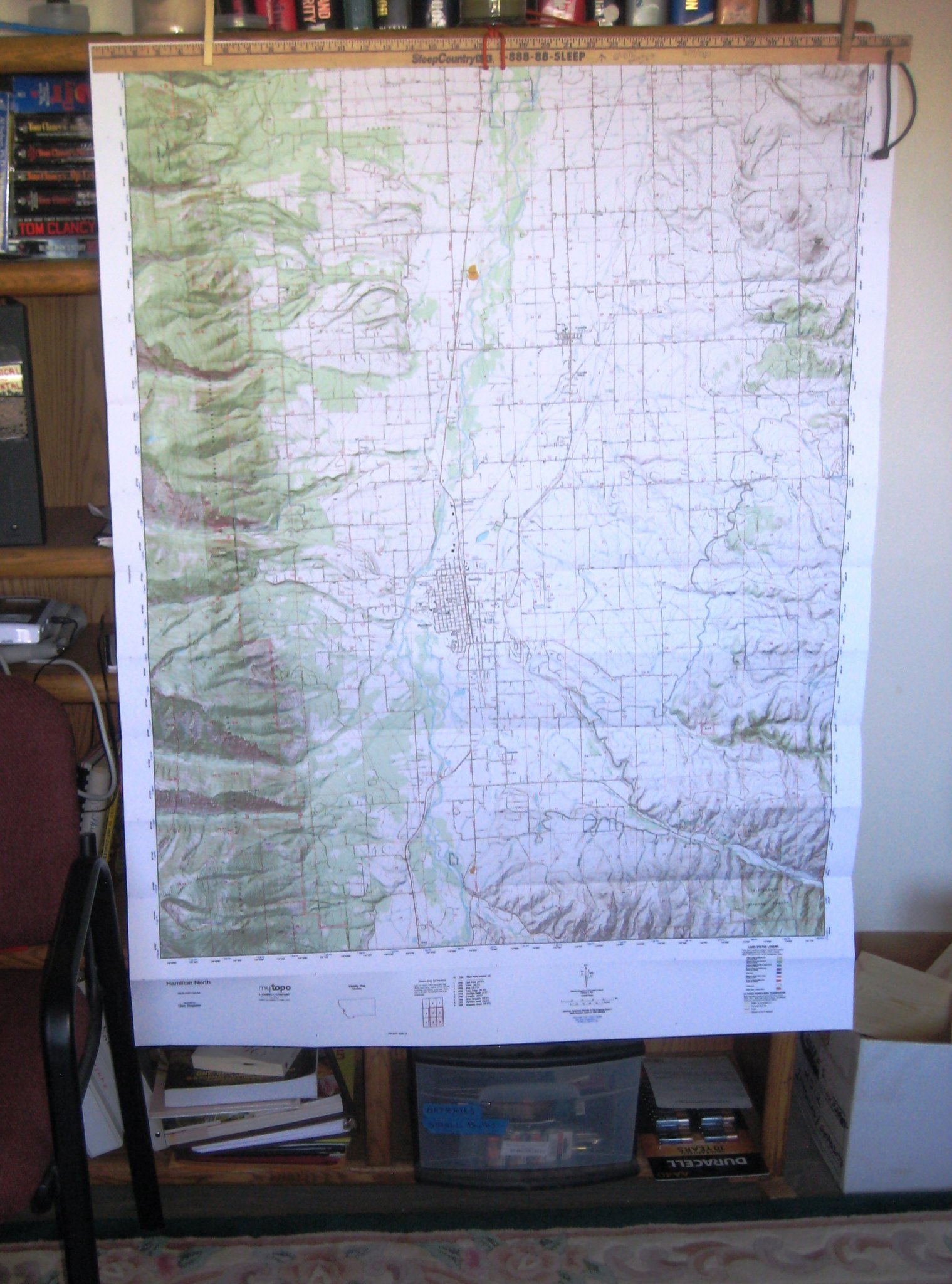

It's taken a while but I wanted to follow up and share some info.
First, I want to say "Thank You" for all of this information. It is priceless.
I have been around maps all of my life, but I was never a "Map Person". Dealing with this map maker showed I was behind the curve.
Map covers about 12 miles wide (East / West) and about 15 miles vertical (North / South).
If things go bad, I could cover that area on foot. Going any farther, I'd have to have a vehicle and swap to road maps.
Map is not laminated but it has a matte finish. Water drops bead up. I would protect it farther in the field. A heavy laminate would make it cumbersome.
Like trucks, boats and rifles... There is no perfect map.
Granted, I need to look closer at GPS's. At $600 the Garmin Montana 680t is not in my budget any time soon. Open to suggestions.
I'm not advertising for this outfit. I went with them because they were in Montana and not China.

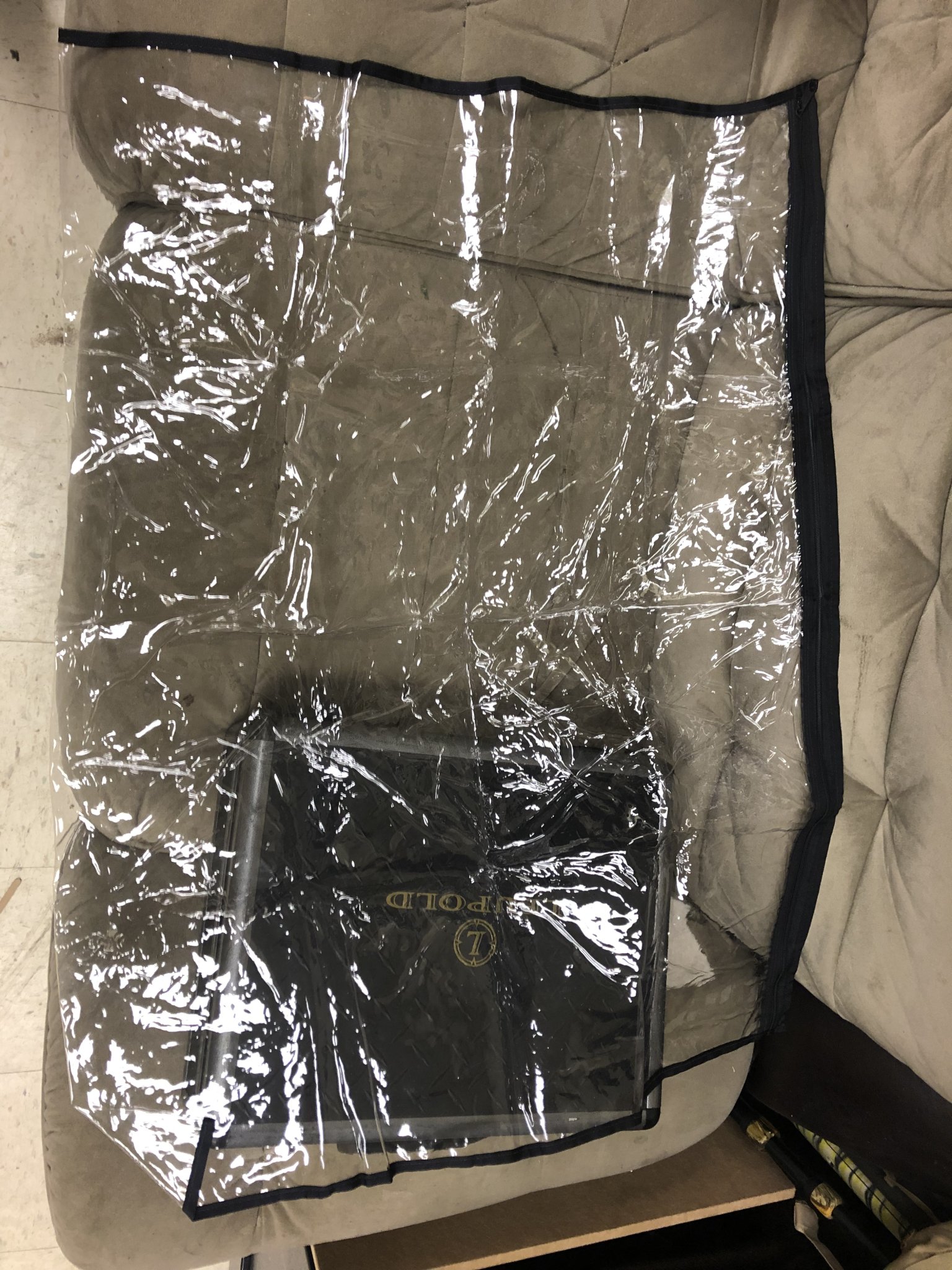

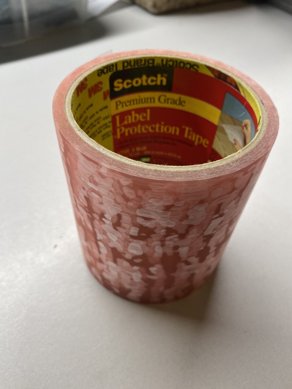

Back when I was in nav school, we used this stuff (see pics) to protect the maps (actually aviation charts) that got frequent, heavy use, with lots of markings (pencil, vis-a-vis, etc). I still use it for my elk area hunting maps which I make from printing out free to download USGS topo maps. They're not quite as large as what you're using, only 1:24K scale/7.5 minute size, but it's a durable option to protect and re-use paper maps.

Since there was some talk about digital maps being used in conjunction with paper maps, consider the hunting map app onXhunt. I am very very far from an expert but I use it hunting and you can download user defined offline maps, track your movements to save later, mark different types of waypoints, even see who owns what land. All sorts of hunting overlays.
Anyway, I’m sure this is all standard stuff and way off the mark, but there you have it.
Here is what I do for Sniper Adventure Challenge & practice:
1. Cal Topo [https://caltopo.com/] - really really great source for map data (used for SAR). Sign up for a paid account so you can print larger maps.
2. Print out your map to a georeferenced .pdf the size you want. Save the file.
3. Call a local blueprint place. Ask them to print your map on something waterproof like plastic or tyvek. Most of them already do this for sites or signage - and the cost is super low compared to other places.
The benefits are you have very high control over your map data, and can print it exactly the size you want. If you don't want extra lines all over the place like you get from MyTopo you don't have to have them. Just want the UTM grid lines, but want them on a 100M grid instead of 1000M grid, no problem. Want to make water sources or buildings or other landmarks - no problem. Want to print out Satellite imagery from yesterday - no problem....
