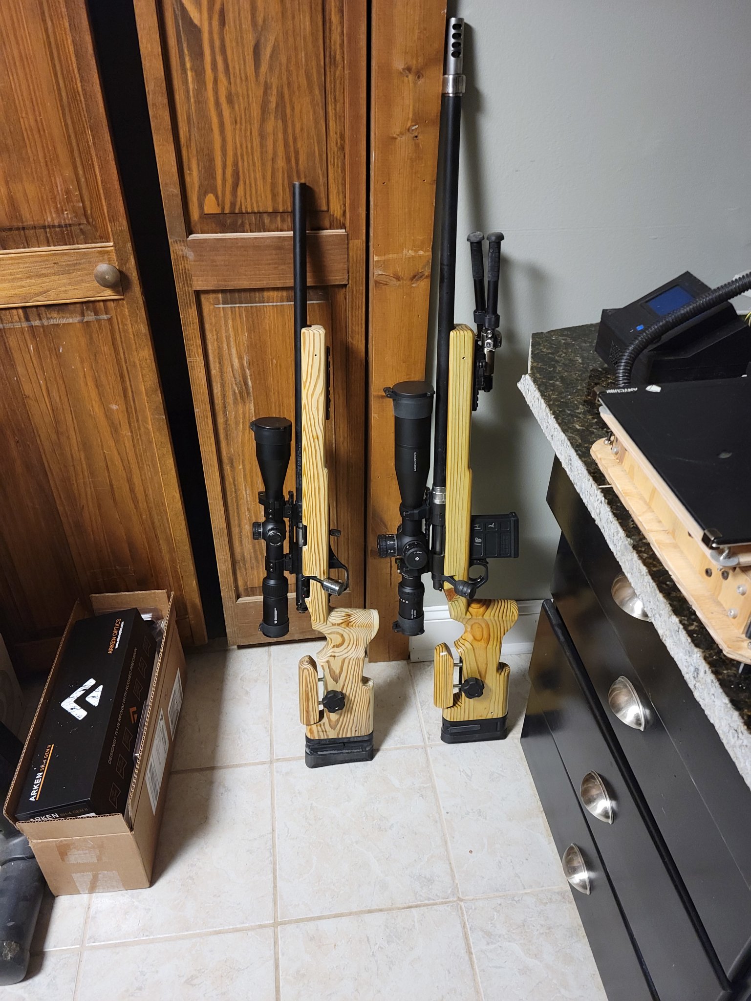

Completed my prototypes for my Rem 700 action and Savage MkII FV. Made the first ones in pine (obviously prototype) Making second set now (cnc) in ten year old aged cherry that is laminated in .38" slices. I'm trying to decide which direction to go on finish - Tru-Oil (linseed oil) or polyurethane and whether or not to use a stain at all since this is cherry (since cherry will darken over time).
Thoughts from the gallery?
The picture here shows the pine prototypes.
I’d recommend Timberluxe for those, but you won’t go wrong with tru-oil.
What glue did you use? I’ve never had fully cured glue joints delaminate using oil or water based polyurethane.
I don’t think stain would be necessary on those unless you want to make them more red.
Oil based poly ambers with time.
Wipe some mineral spirits on a spot and that should give you a pretty good idea of what the finished product will look like.

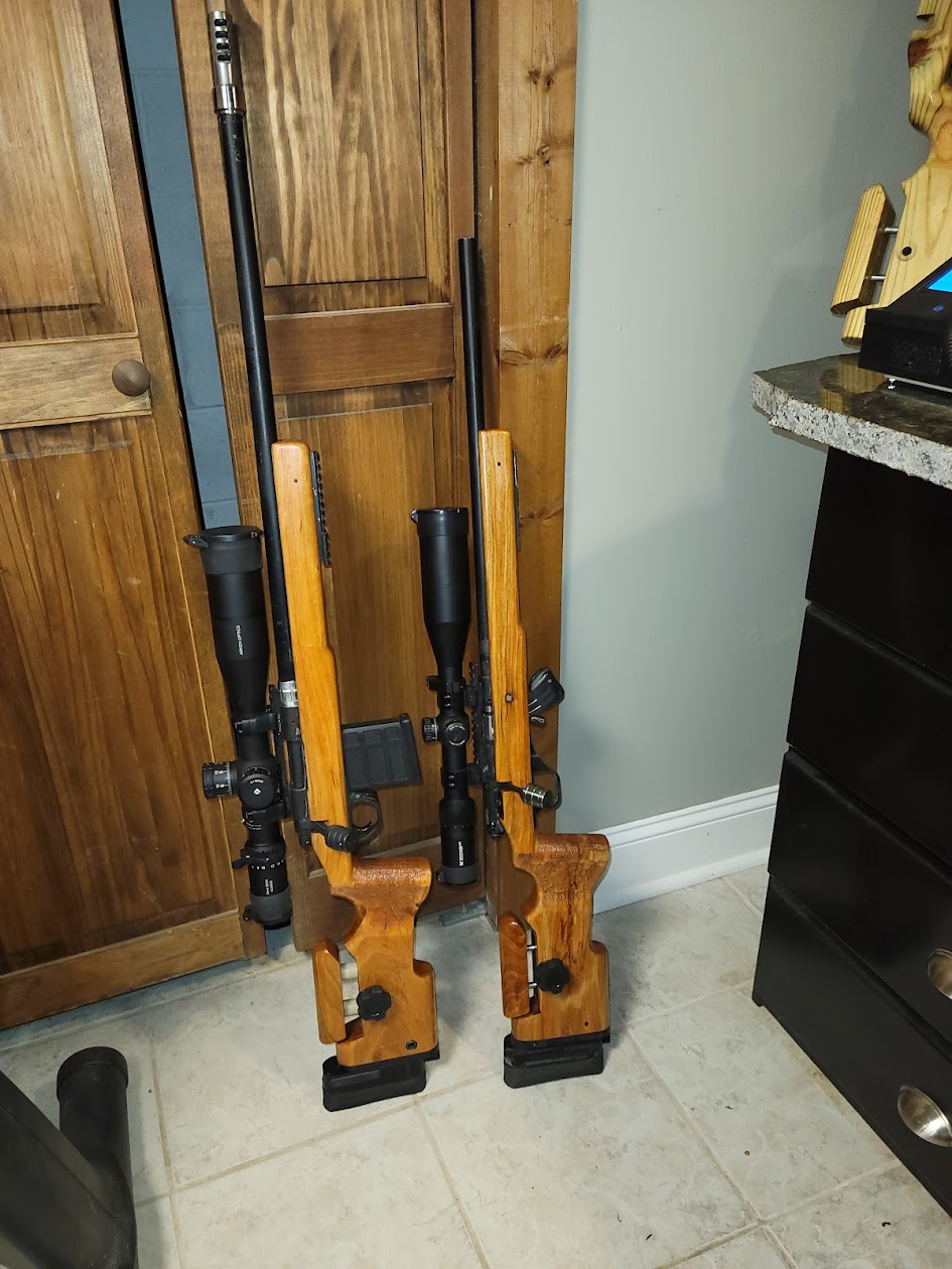

I used Tru-Oil. Probably 8 - 10 coats each, 400 sanding in between. Pretty happy with these. I'll see how they shoot on Saturday.

TiteBond 3 is what I used for laminating.
Laurel Mountain Permalyn. Its a polymerized oil, I believe, and while it can be sprayed on, it can also be sanded in as a "finish in the wood" hand finish like an oil but with none of the downsides of oil.
Tru Oil is also a polymerized oil, I believe.
Beautiful sticks! Great idea, well executed. Whether oil or poly, cherry will darken with time anyway. Don’t stain that nice wood.
Fwiw, I’ve never had poly cause delamination and that’s mostly what I use for projects.

Will you do one for the Howa action?
That is fucking HOT!
