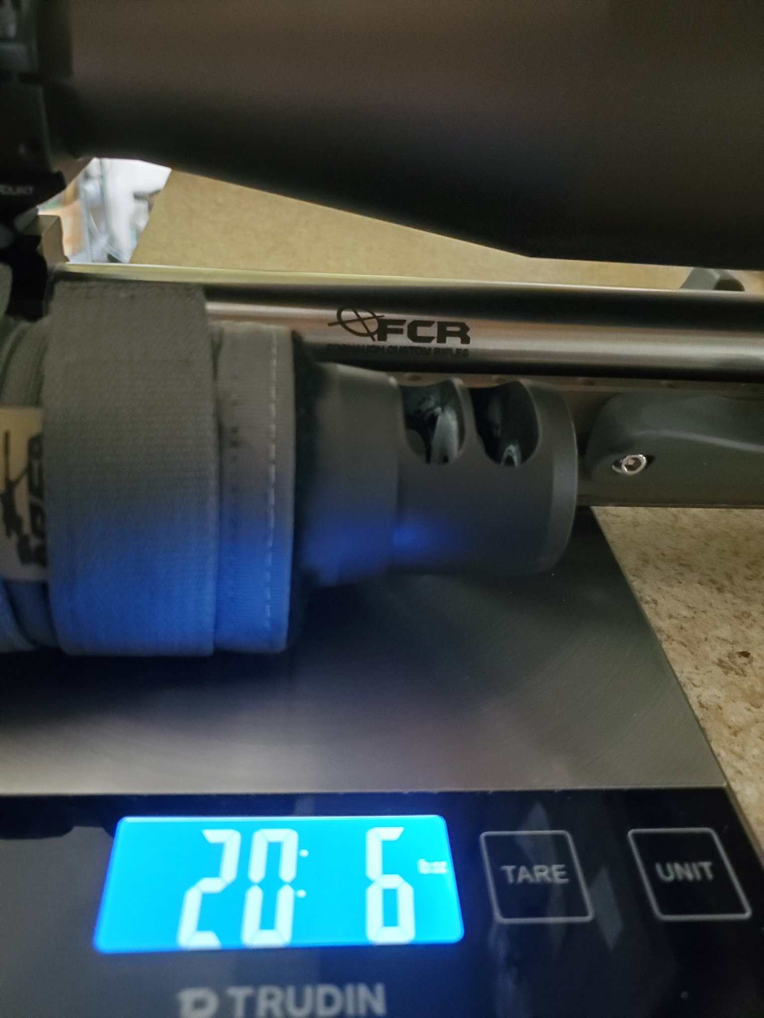

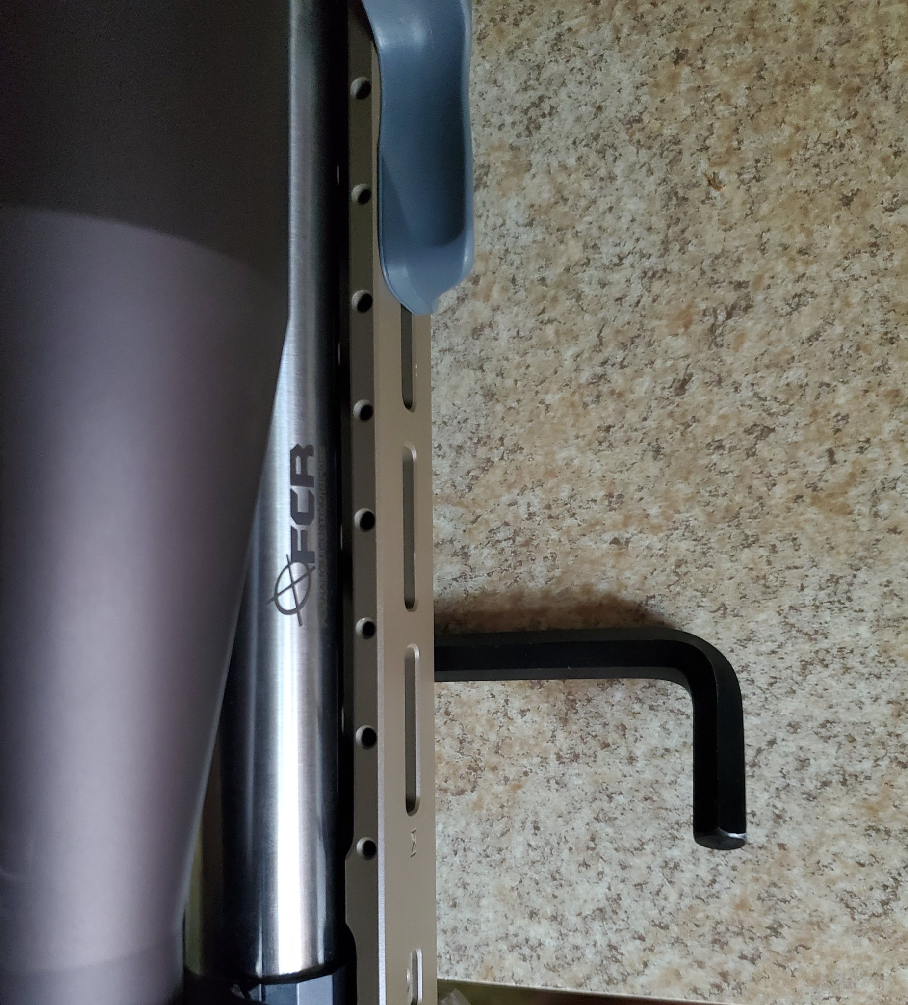

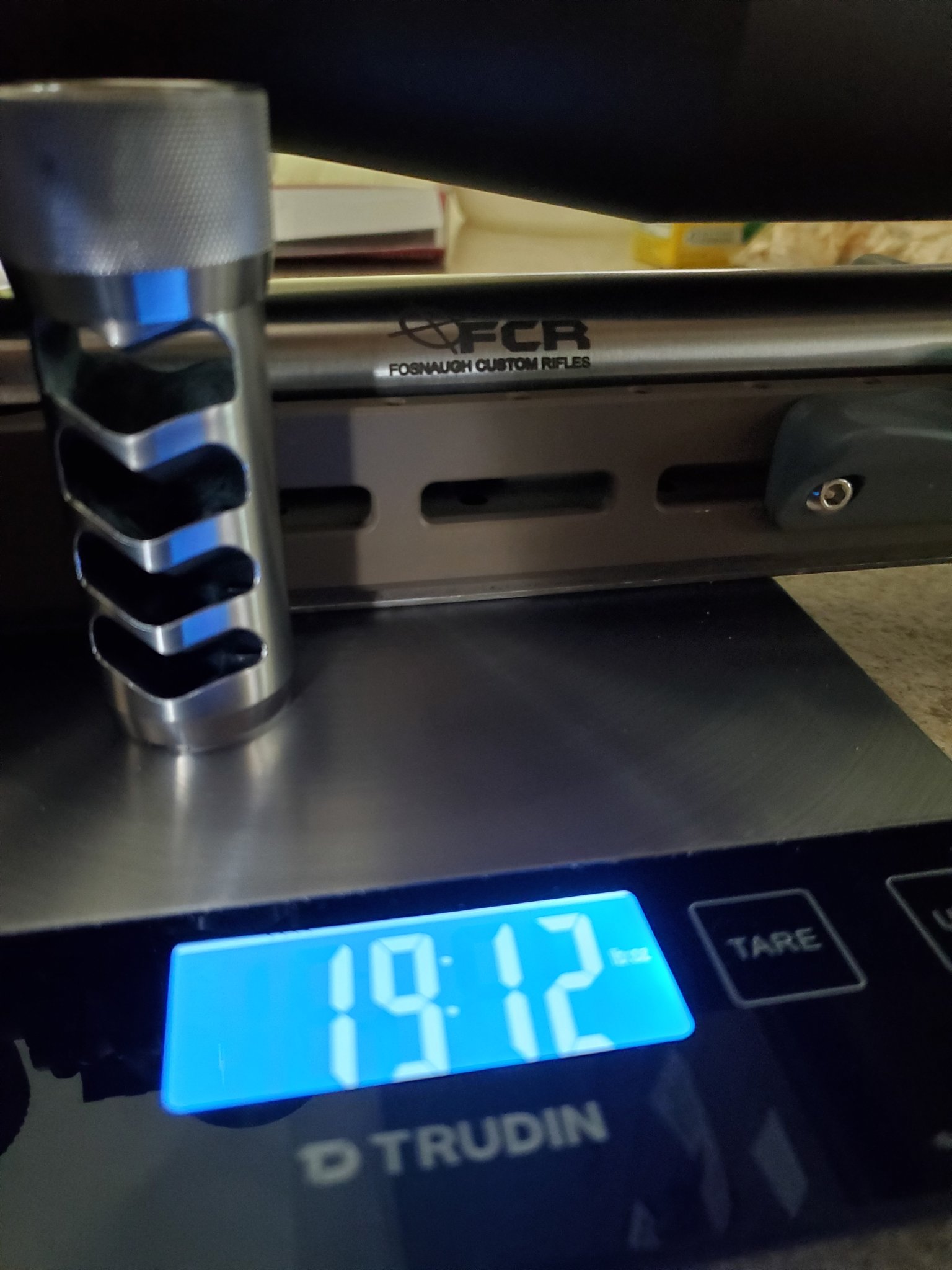

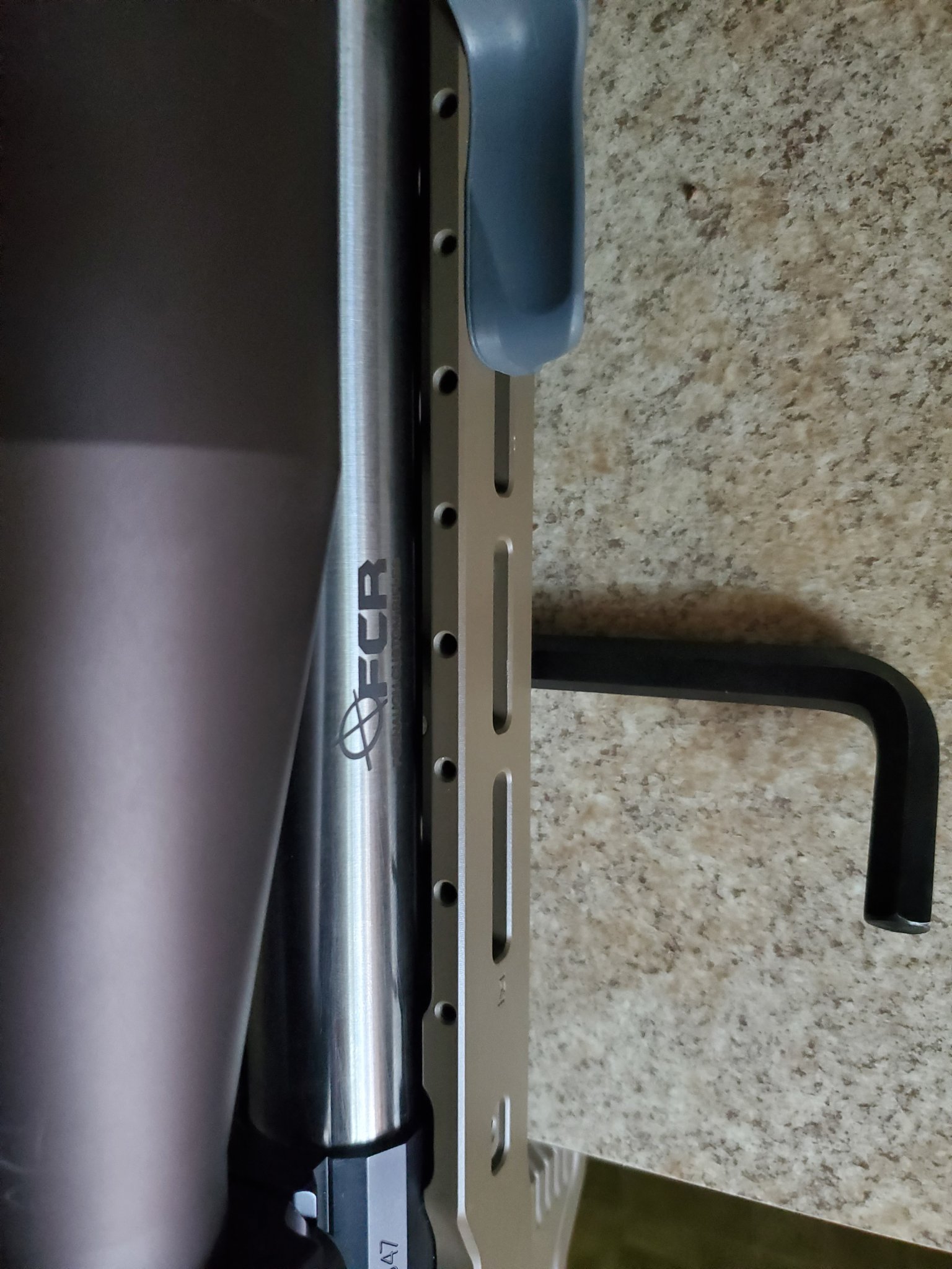

I just had a 6.5x47L chambered on a 1.2" straight, no taper, finished at 25". Love it. My goal was to have it balance out 4-4.5 inches in front of the mag well and not require weights >key point> while using a Maverick in the short match mode and a MDT AAC Elite chassis. Well, I found I could have gone 26" and if I do another, I probably will do that. it still may require one internal weight but I'd rather error on the light side.
hope that helps
Weight and balance points to follow.
