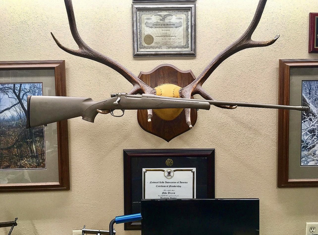

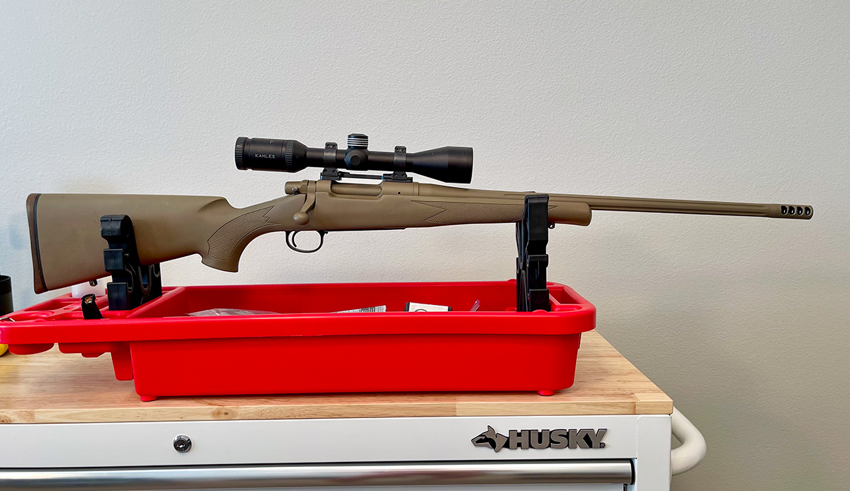

Hi guys.
I have a custom Model 7 I had built several years ago, and then rebuilt by legendary LR/Benchrest rifle builder Mike Bryant. I would like to convert this into a PRS rifle, but I am trying to decide if it's feasible or not. It's a switch barrel rifle and both barrels shoot in the .2's and .3's with handloads, and in the 4's with Hornady factory ammo, though these are three shot groups for hunting. Haven't tested with 5 or ten shot groups, but I have done multiple groups to where the barrels were very hot and accuracy seemed to remain pretty consistent, though better on the heavy barrel. I think either would be fine for ten shot strings.
The one issue is that this is the older model with only three scope base holes and currently has a Talley steel one piece base.
Here's what I have now:

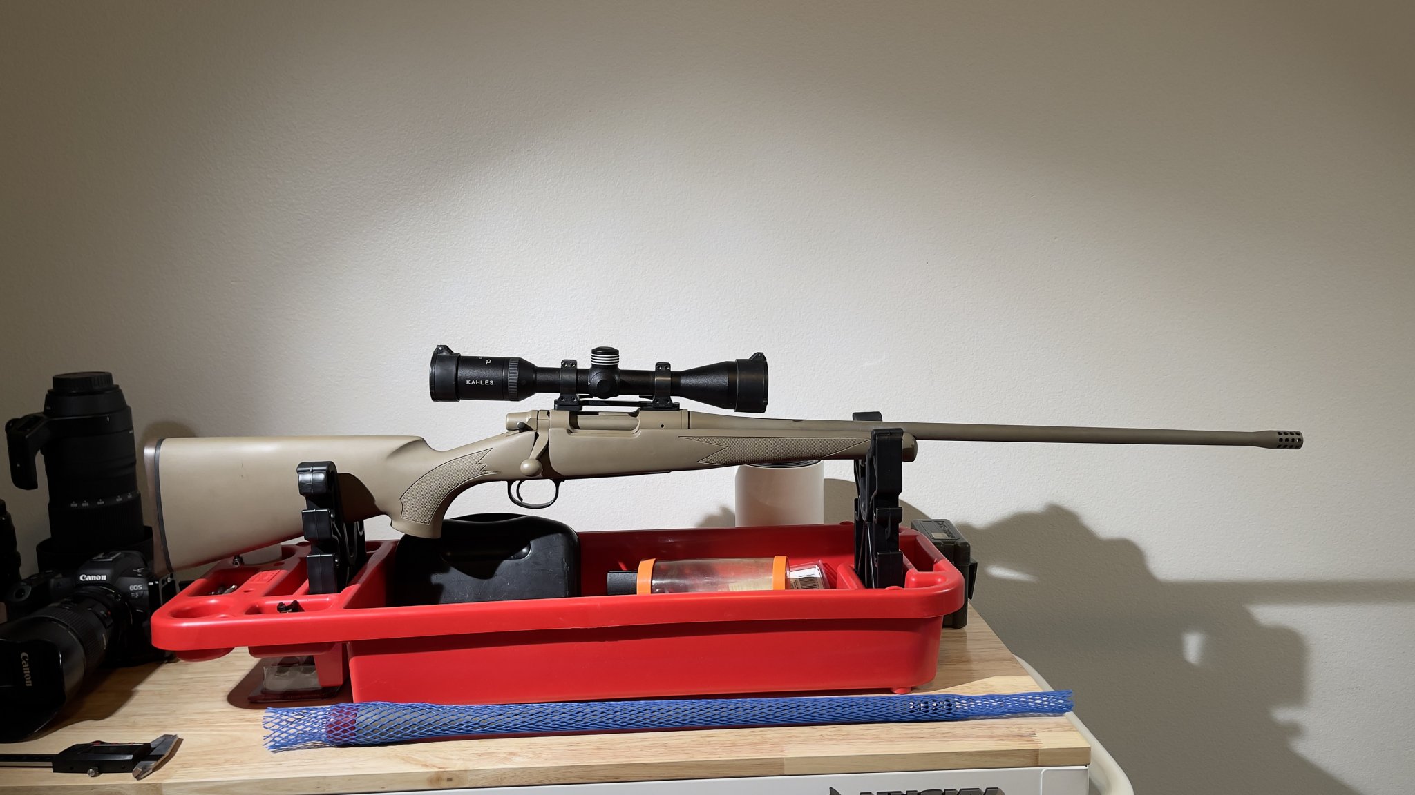

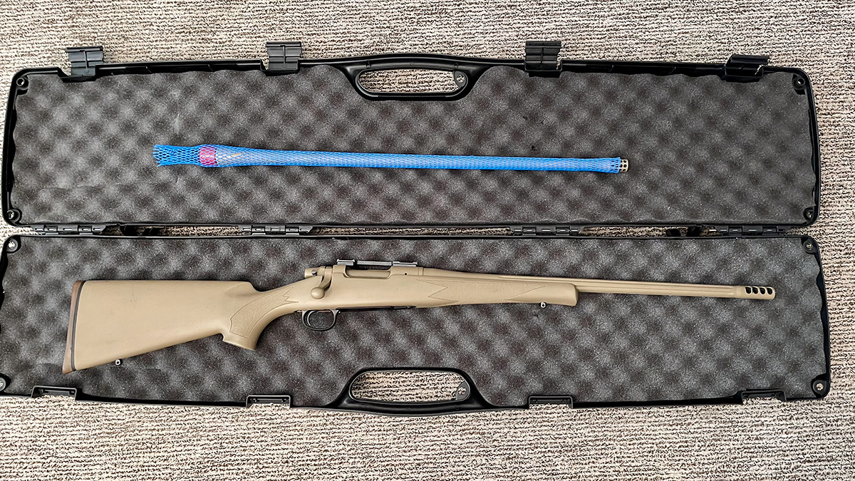

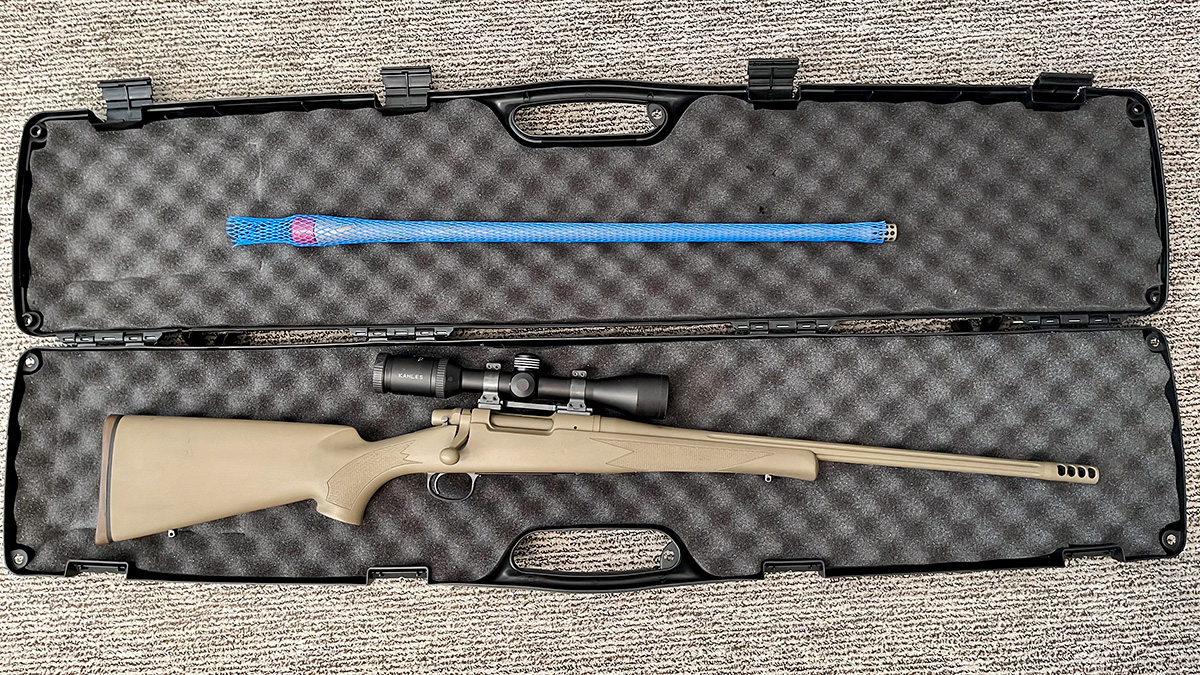

Blueprinted Remington Model 7 action with pinned Badger Ordinance Recoil Lug
Two Switch Barrels that are indexed to the action:
- New Bartlein heavy fluted barrel, 1:7.5" twist chambered in 243 Win. 20.25" plus brake
- Lilja #1 ultralight 24" barrel. 1:8 twist with Vais brake chambered in 6mm Creedmoor.
Reworked factory trigger set to 2.5 pounds. Might swap it but I have no problem shooting it accurately now.
Currently has a Pillar bedded, cerakoted factory schnabel end factory stock.
My thoughts are to switch to a chassis stock that takes AICS magazines (if I can find one), throw on 30mm Talley steel rings and my Nightforce 5.5-22 x 56mm scope and go play for a bit and see how I like it. Reasonable?
If it's not feasible, I would love to get some opinions of value. I might just move it somehow and then find or build a proper starter rifle.

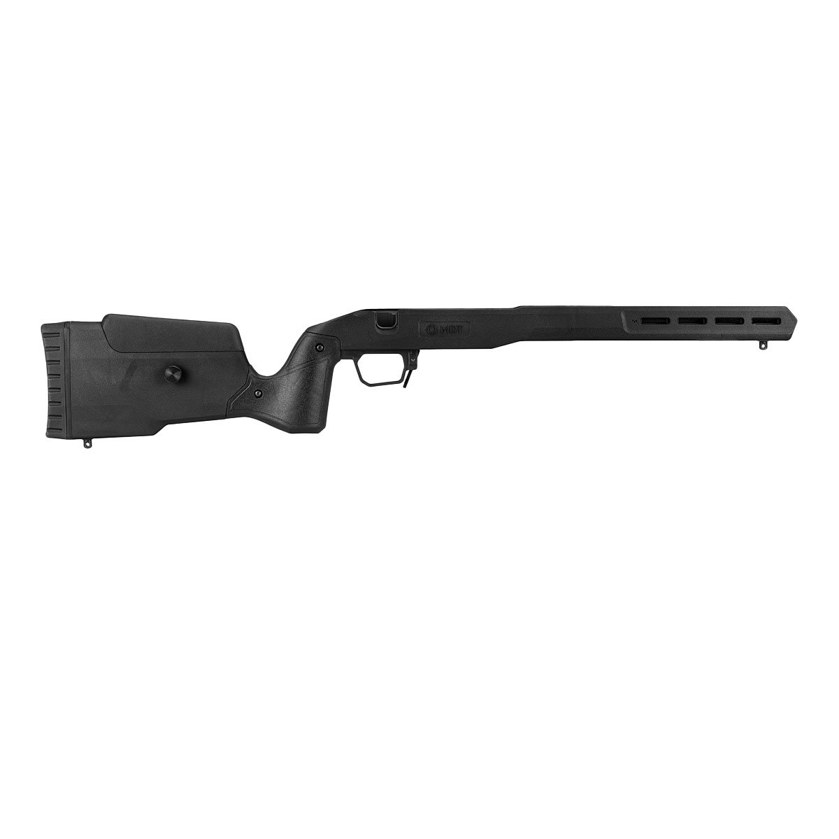

Without a detachable mag? It's currently a drop floor plate. From what I understand, I have to irreversibly alter the action feed rails to fit a detachable mag, so won't eb able to go back once I do. Also not sure if shooting a match for fun would be do-able with a drop floor plate.
I'm not certain it would fit, but legacy sports has a drop in for the 700 bdl, it is a ploymer unit, woth polymer magazines.
They actually work very well and don't require any modification. I'd shoot the heaviest bullets that will stabilize in the .243.

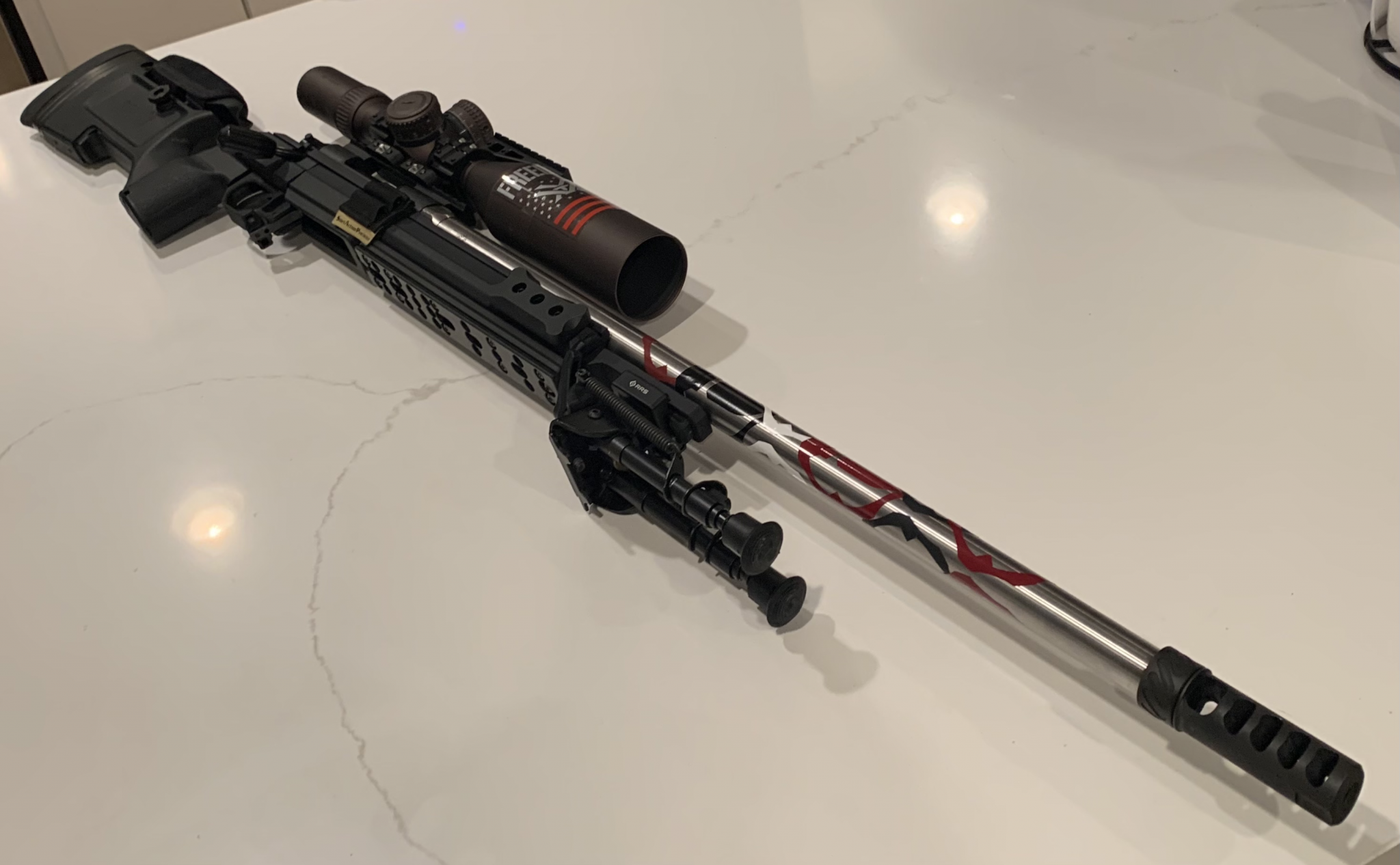

For me the biggest hurdle I had getting into prs was the equipment.
I started with a remington 700P.
It had a m5 dbm, so having enough rounds was covered. But at factory weight a rounded bottom of the stock and my average marksmanship skills. It was not ideal.
It was very tough to spot my misses. My buddy let me use his spare match rifle for 3 matches. I just paid for ammo. I got to use a impact action with a proof 6 dasher barrel in a foundation stock with all the weights in it. It had a gen 3 razor on it. My scores went up 50% at least.
I still have my 700P I've dumped countless hours in it. Hogging out the stock to add weight. Installing a arca rail. Getting the balance point perfect for barricades and gates.
I still use my dasher every match. I've been practicing with my 308 to save on barrel life of the dasher. It also is amazing going from a 20lb 308 to a 24lb dasher. There's zero recoil and I can spot every impact and miss.
Top picture was factory form. Bottom picture is 20-22lbs after I hogged out the whole stock to add lead weight. It's much better suited now. But now I'm going to either set back the barrel or put a truck axle on it. Because to load the 178's accurately they are 3 inches long. After the barrel gets figured out. I'll use it for prs matches to change things up.
But at the end of the day I'll use my dasher when it matters.
There's shooters out there that have the skill and experience to take that 308 in stock form and rock me on the range. My buddy could probably use your rifle in stock form and get higher scores then both of us combined.
I'd rather have fun at a match and not be able to bitch about my equipment being ideal..
Reactions: Riflman

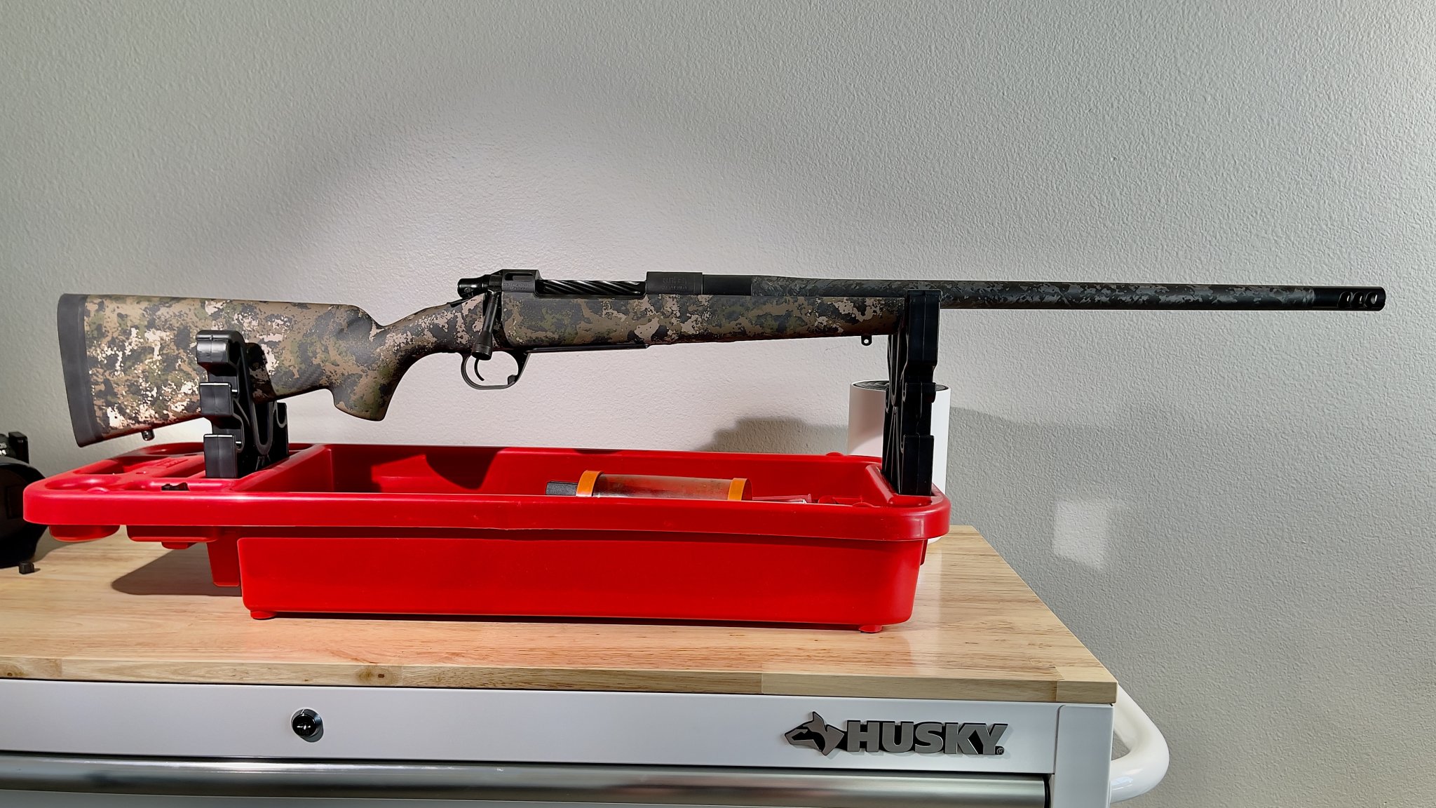

I have this too. Fast twist Lilja 1:8. Used to be a F-Class rifle with a single shot follower and the barrel was 29" in 243 ackley. Now just 243 Win and shortened. Very accurate. If I could get bottom metal for Mags I would use that and add an arca rail on the bottom. Has a Timney trigger set at 1.5 ounces.
Reactions: camocorvette

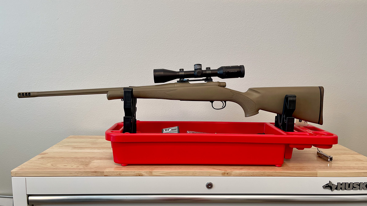

I'd use heavy 2800 fps bullets in the 243 Ackley to get a feel for a match. But yeah, I think a different rifle is a way better use of your time and $
Both of those rifles have heavy barrels chambered in 243 Winchester now. I wouldn’t use the Lilja #1 barrel that’s currently in 6mm creedmoor. But yeah both have no magazine option. I can add one to the Model 7, but not the Ruger M77. The M77 has a wide flat forearm I could easily add an arca rail too, and with 108 ELDs or another heavy match bullet should be as good as any other rifle for a few matches. But again, no mag option.
I do have a brand new ultralight rifle I had Mike Bryant build me that I might sell if I can get enough out of it. Then I’ll buy a dedicated PRS rifle and maybe an AR for coyotes. It has defiance AnTi, proof barrel in 300 Win, and is loaded up with all the best parts. His QC group was a .322 but I have too many custom guns. It took two years to source the parts and have it built and now I’m like, Meh. I like my custom 338 Win switch barrel. lol. Having an action like a defiance makes it a bit easier to get credits if I like the sport.
