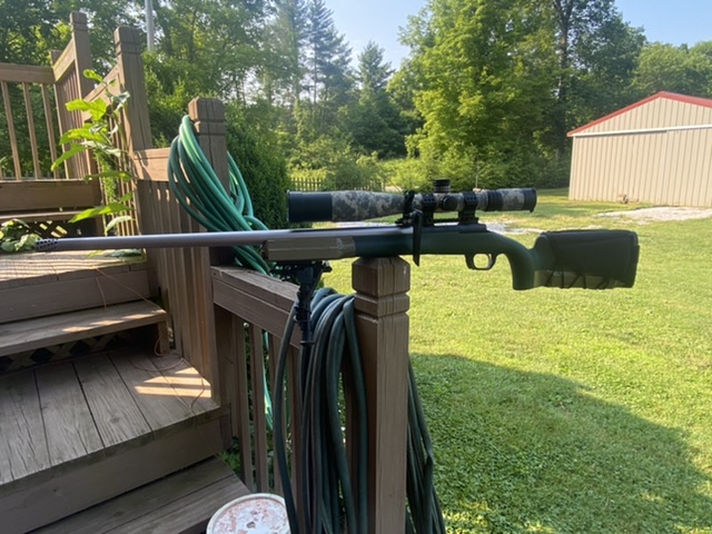

McMillan Z1/Z10
XLR Envy Pro
Thanks for the info guys... @b6graham , that is a lot of length to contend with.. haha.. have to step back a couple steps to get all that out of a barricade.. good looking stick though!!! thanks for sharing.. does the gun in pic on right have a sidewinder on full 1.25"?
yes. they're both 1.25" straight
the XLR is a long action origin. 32" 30 Sherman Magnum with 338SR
the McMillan is a TL3 31" 6.5 creed with sidewinder
Reactions: rydah and BrienM

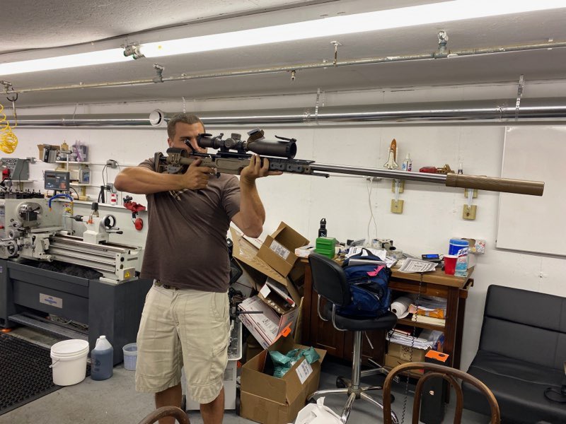

Wow, good thing you are young and seemingly strong. Me and my 68 y.o. bad back couldn't hold that 32" barreled chassis for long at all.
What's the total weight, if you know.
I'd get back into the gym but with a few stents in the ole' ticker I think I'm still going to wait a while.
Cheers
Cheers
the XLR is 27 as shown (all XLR weights, razor gen 2, TBAC 338SR)
the McMillan is 23 (arcalok full weighted rail and 2 1/4" brass buttpad spacers)
both very reasonable
Reactions: Baron23

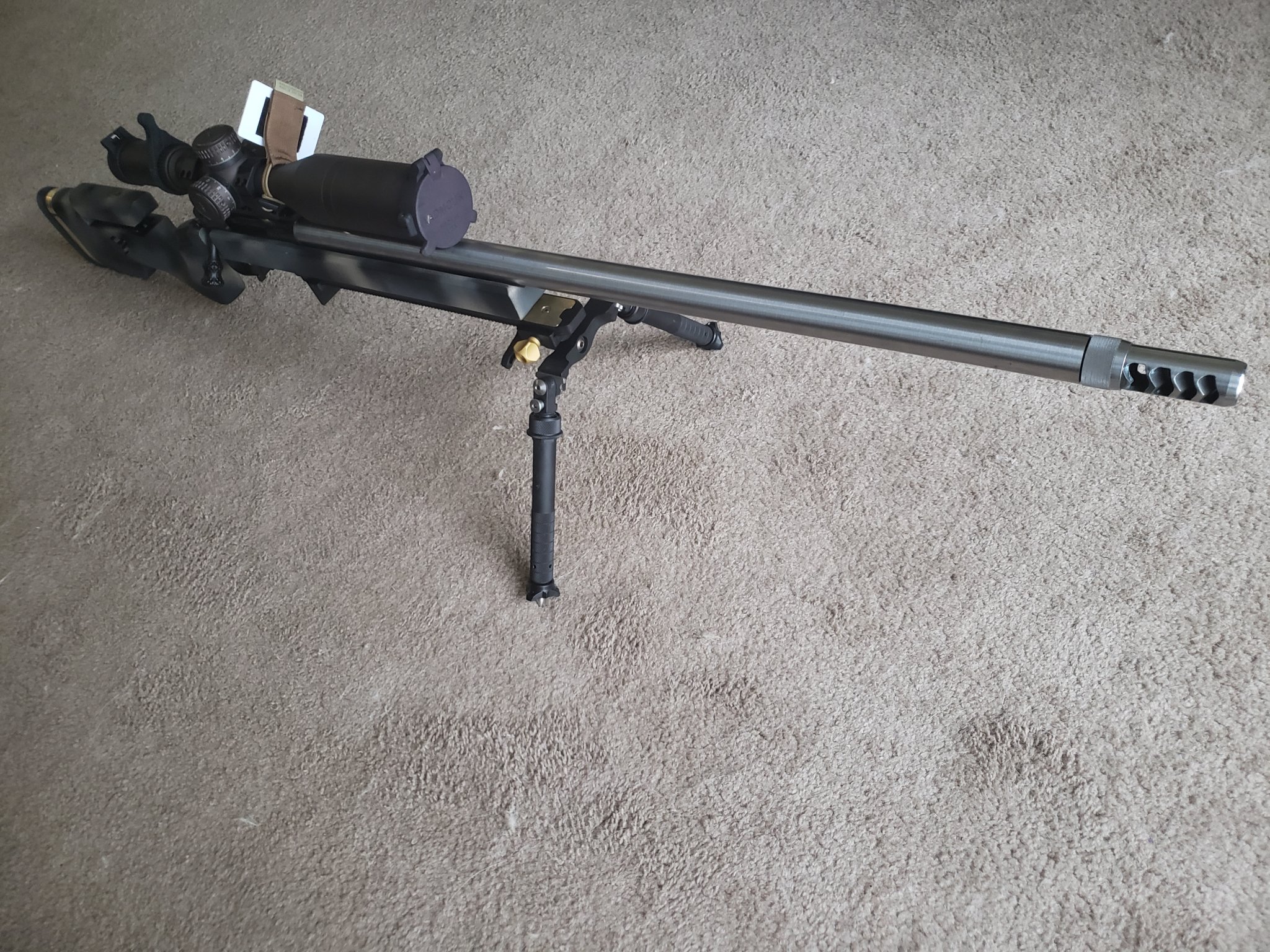

Mine is at 20.4# with traditional fiberglass stock but weight stuck all over it. Chassis seems much easier to bolt on weight. 1.25"barrel looks like easy way to get weight. I am a little fella though.. not sure I can handle that much weight.. I'll have to start lifting.. haha.. Thanks again guys...!

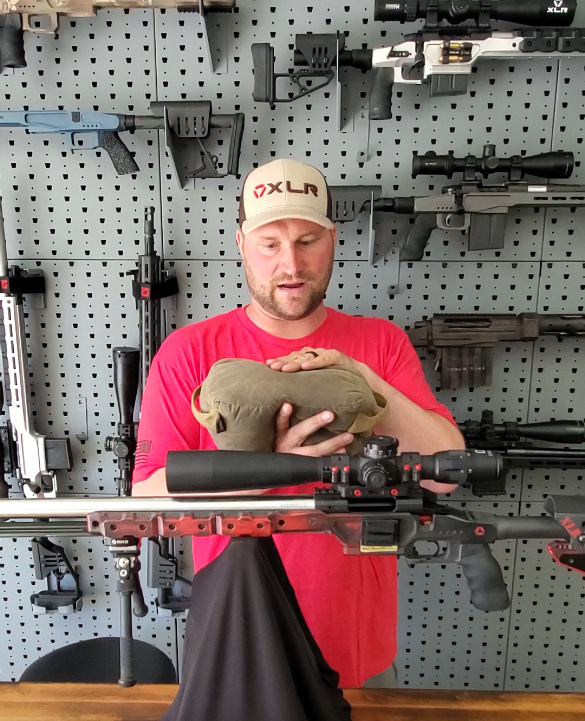

Balance can defiantly be a personal preference depending on the shooting discipline, and what bags, or front support is being used. For NRL / PRS style shooting where positional balance is very important we like to have our rifles balance 4 1/2" - 5" in front of the magwell. This is because majority of the front support bags we use are on average 10" long. This gets the balance center of the bag. This also allows more flexibility for when you might have a bipod on the rifle, or not have it. Some stages you might want to have it on, because the next position might require it. Others you might not need it, and might be restricted by either COF requirements, or space limit.
When we see rifles with a balance closer to the magwell it can be common for the shooter to get high impacts/misses.

Give us a call any time with questions on it!
Reactions: BrienM
When we see rifles with a balance closer to the magwell it can be common for the shooter to get high impacts/misses. View attachment 7398433
