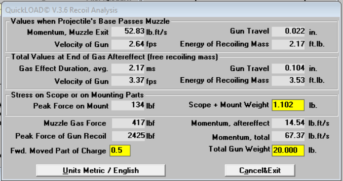

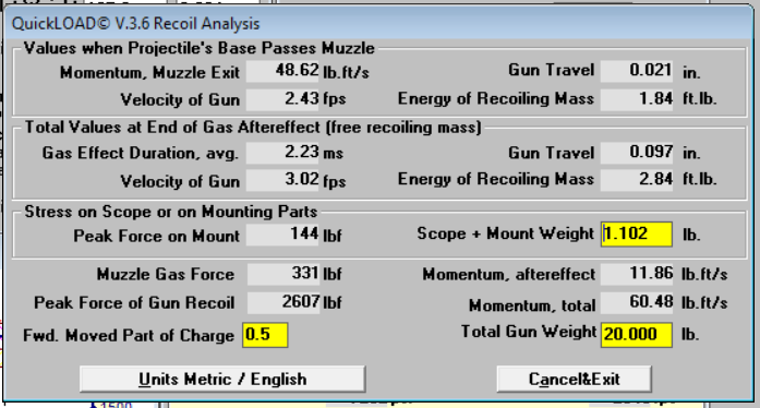

Yea, those BR's have way less recoil. Well, unless you're talking about peak force, then they actually have more if you push it to a decent velocity. And even going 150 fps slower it's only about 10% less total momentum. Literally adding an extra pound of weight to your rifle makes more difference. If you want to deal with your caliber being picky about actions and magazines and slower then maybe a BR may be worth it to you. If not, a 47 or creedmoor is not going to hold you back. They are all going to be plenty accurate if you use quality components and loading practices, and by plenty I mean able to win matches.
6x47 @ 3000 fps w/ 105 hybrids & RL16
BR @ 2850 w/ 105 hybrids & Varget
