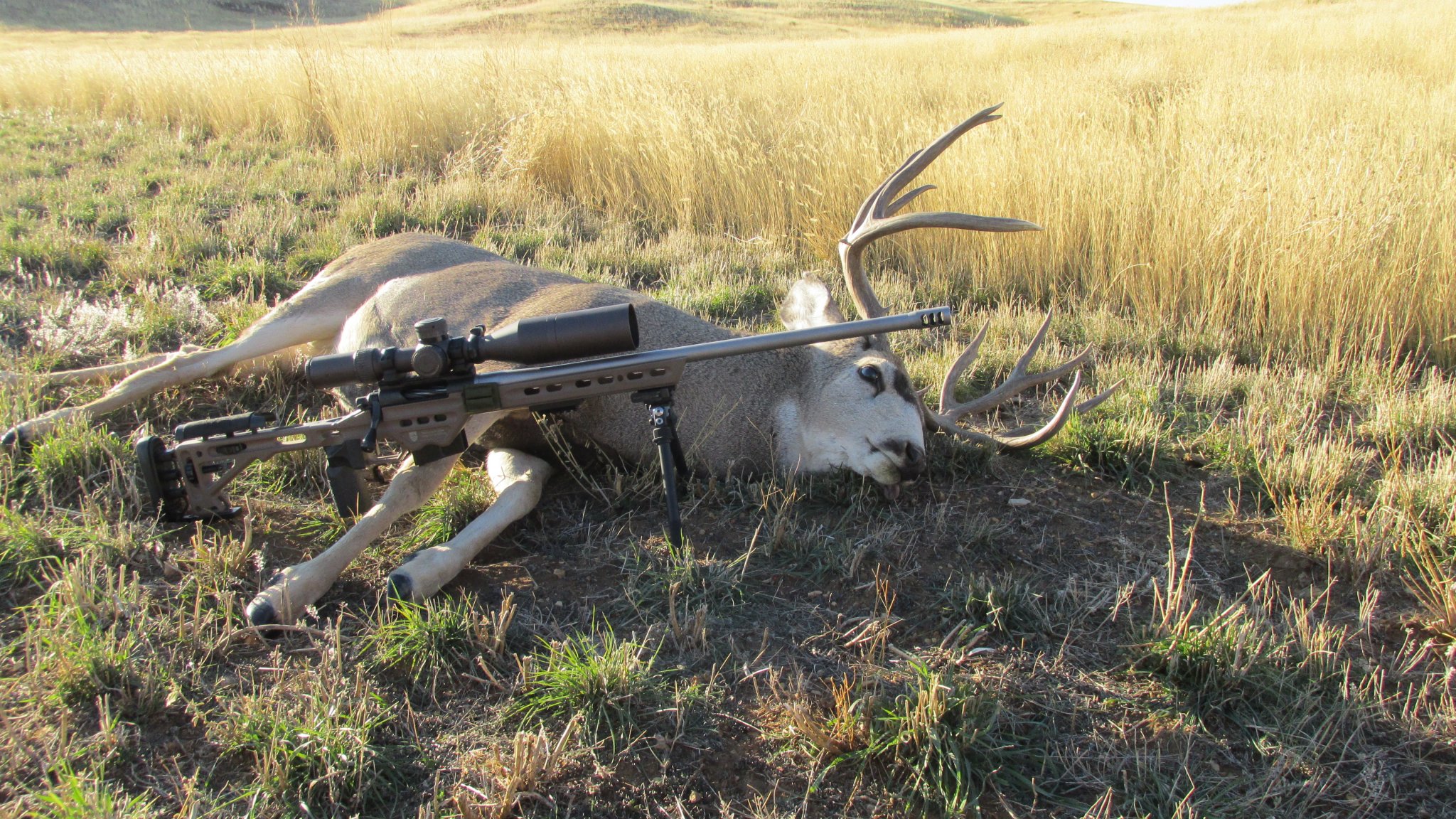

25" Remington varmint contour barrel, stiller action in a MPA competition chassis.
