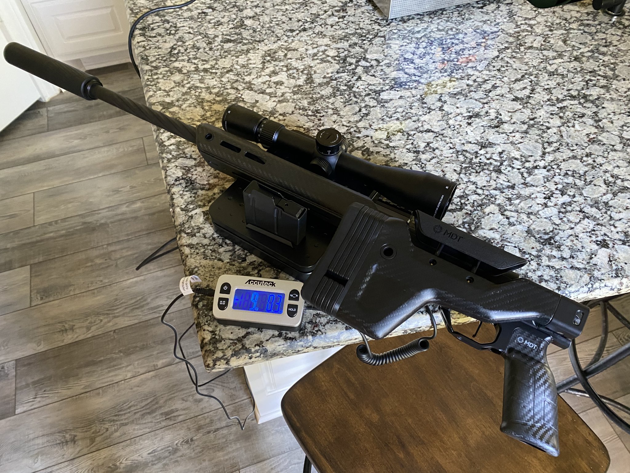

MDT HNT26 folder, Bartlein 3b (steel) 20” with a heavy 50deg twist flute, TBAC ultra7, Vortex 4.5-22 lht on the current build. So you’re somewhat correct (barrel isn’t MTU but 3b will handle strings of fire just fine), but even swapping on one of my ZCOs it’s still light.
Don’t have my rings in yet, but it will be 9lbs 5.9oz complete with 3rd magazine, scope and rings, and suppressor. I stuck it on a scale for you for proof (9lbs 0.3oz since display is hard to read). Ignore scope orientation, and keep in mind my rings will add 5.6oz. 10 round magazine will obviously add a little more weight but it’s still plenty handy.
I can see the display very well…that’s a nice rifle.
Is that chassis solid? Like not flexy?
It’s just as sturdy as my MPA chassis, just a heck of a lot lighter. Carbon fiber and magnesium are no joke, and carbon on all the handling points is a heck of a lot nicer in the cold.

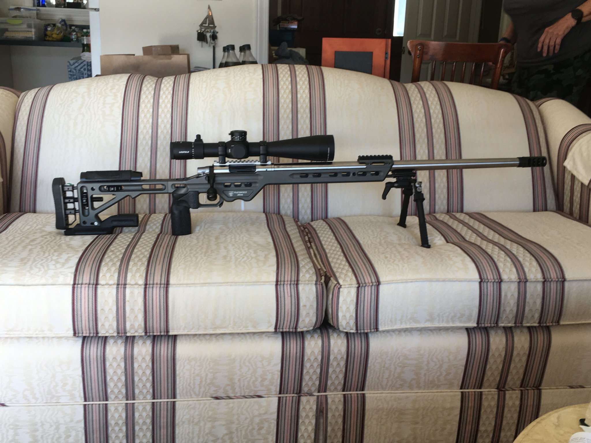

Don’t want to derail this thread too much, just wanted to point to the direction I took when I had the same realization: PRS wasn’t for me because you had to run a 20lb+ rifle to hang, and I had no use for one. Happy to chat about the rifle(s) in PM until I finish the build and post a thread.
Here’s where I’m currently at with my rig, I’m going to add a few bits yet but it’s shooting well.
