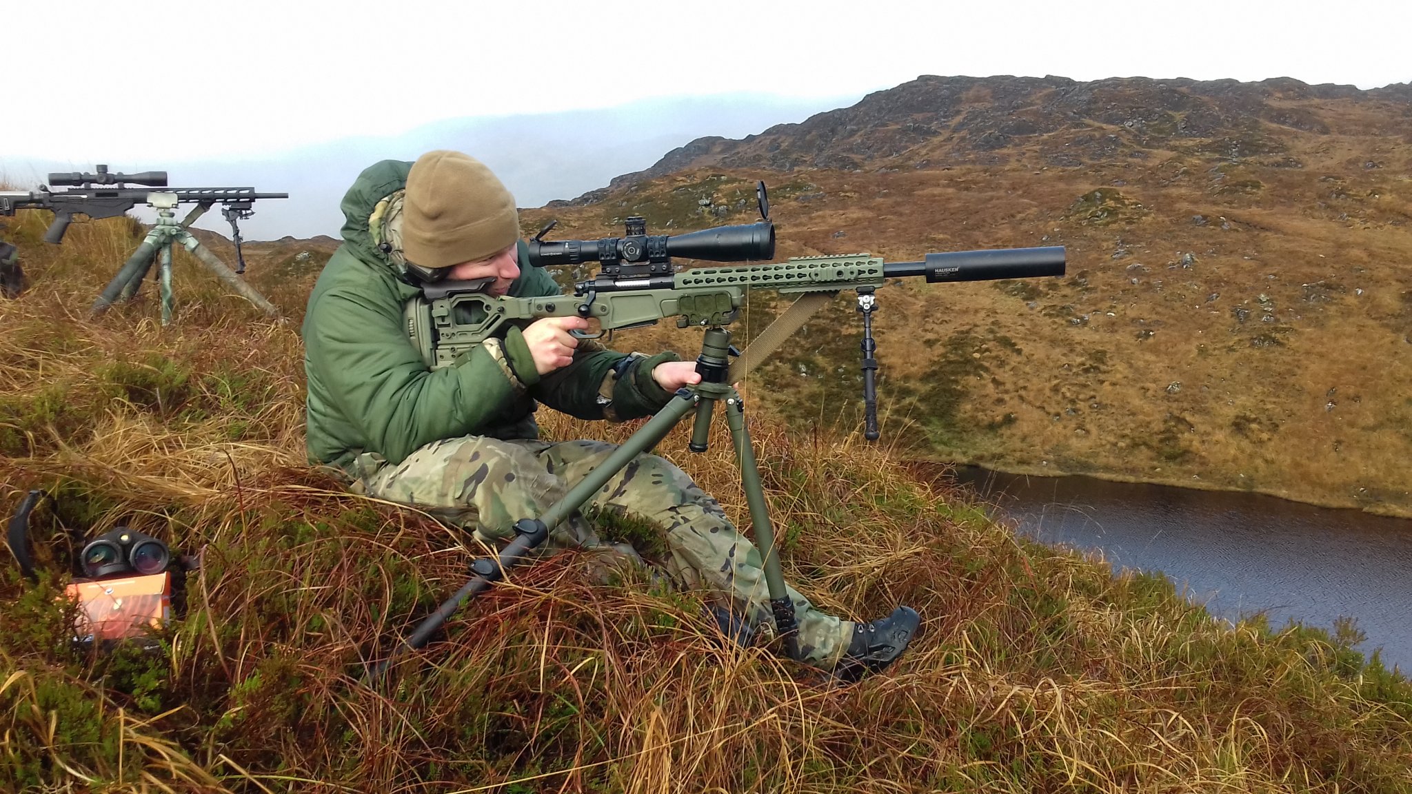

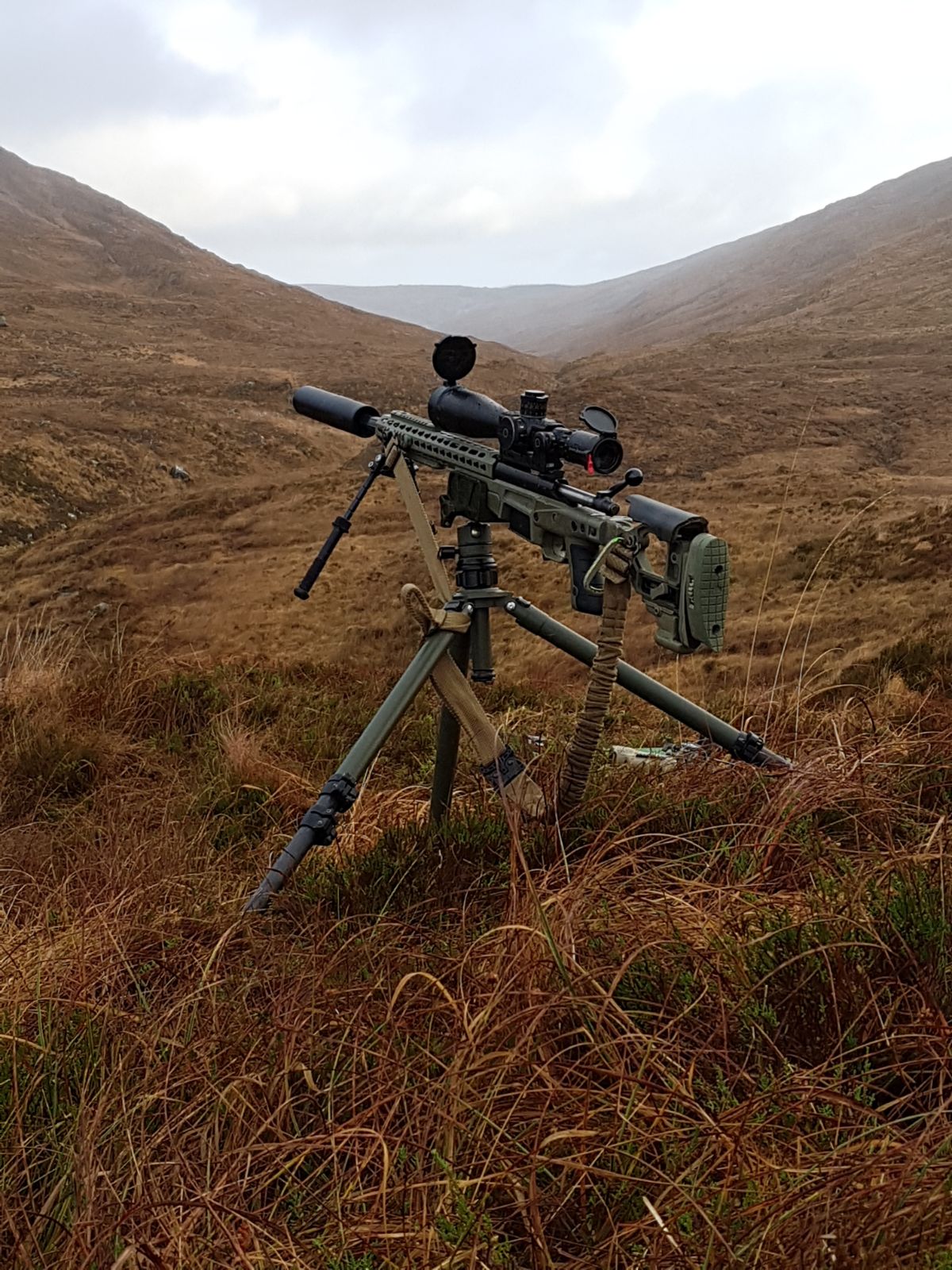

I went with a PRST and a Bhp 1 ballhead and a hogsaddle. Considering the pricepoint compared to other options I am more than happy with what it offers.
