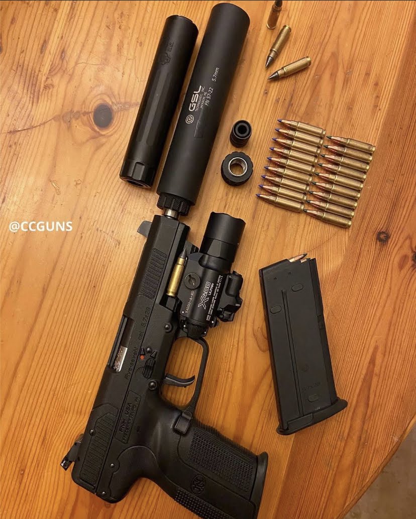

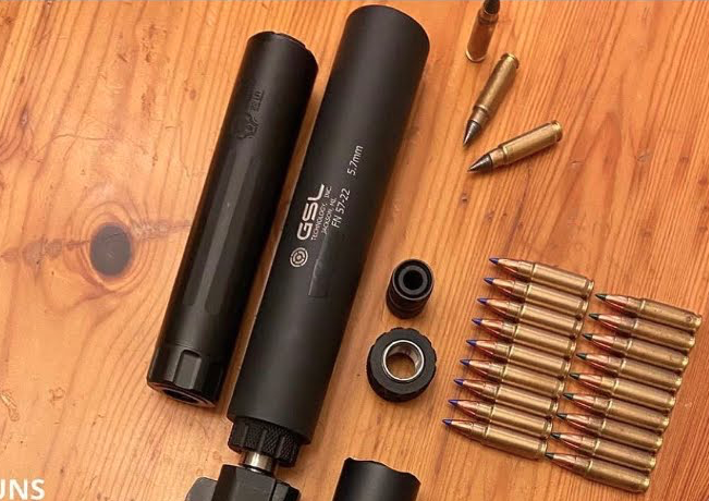

Dead Air Mask HD is about the toughest .22LR suppressor on the market. Would probably be the best route if you want a .22LR can for it.
But...
GSL Technologies makes an actual 5.7x28 suppressor that has more volume than a rimfire can, to properly suppress the 5.7 round.
Here's a pic from their website showing it right next to a DA Mask HD, so you can see the extra volume of the can.

There have been a few complaints about the GSL brake being out of spec causing baffle strikes, and also of the GSL P90 causing bqckpressure issues. Also I'm not a fan of paying $1200 for a 1990s can design just to use it only o a PS90
How is your stock (at the button for the receiver) holding up? That's kind of what I am Leaning towards as well
You must be talking about different GSL can than what I linked, because it's only $615...
Since the topic of this thread is the PS90 and not the Five-seveN pistol, I was talking about the GSL P90 suppressor which is the same as the Gemtech SP-90 suppressor for the P90 developed in the 1990s (just titanium instead of stainless). But the one you linked was also developed around that time, however it has much less volume than the P90 version. Either way, these are premium prices for 30 year old suppressor tech. The GSL/Gemtech P90 brake/comp/bi-lock adapter is also janky as there are numerous reports of alignment issues and baffle strikes from multiple adapters (sending them in to get another defective one etc).
