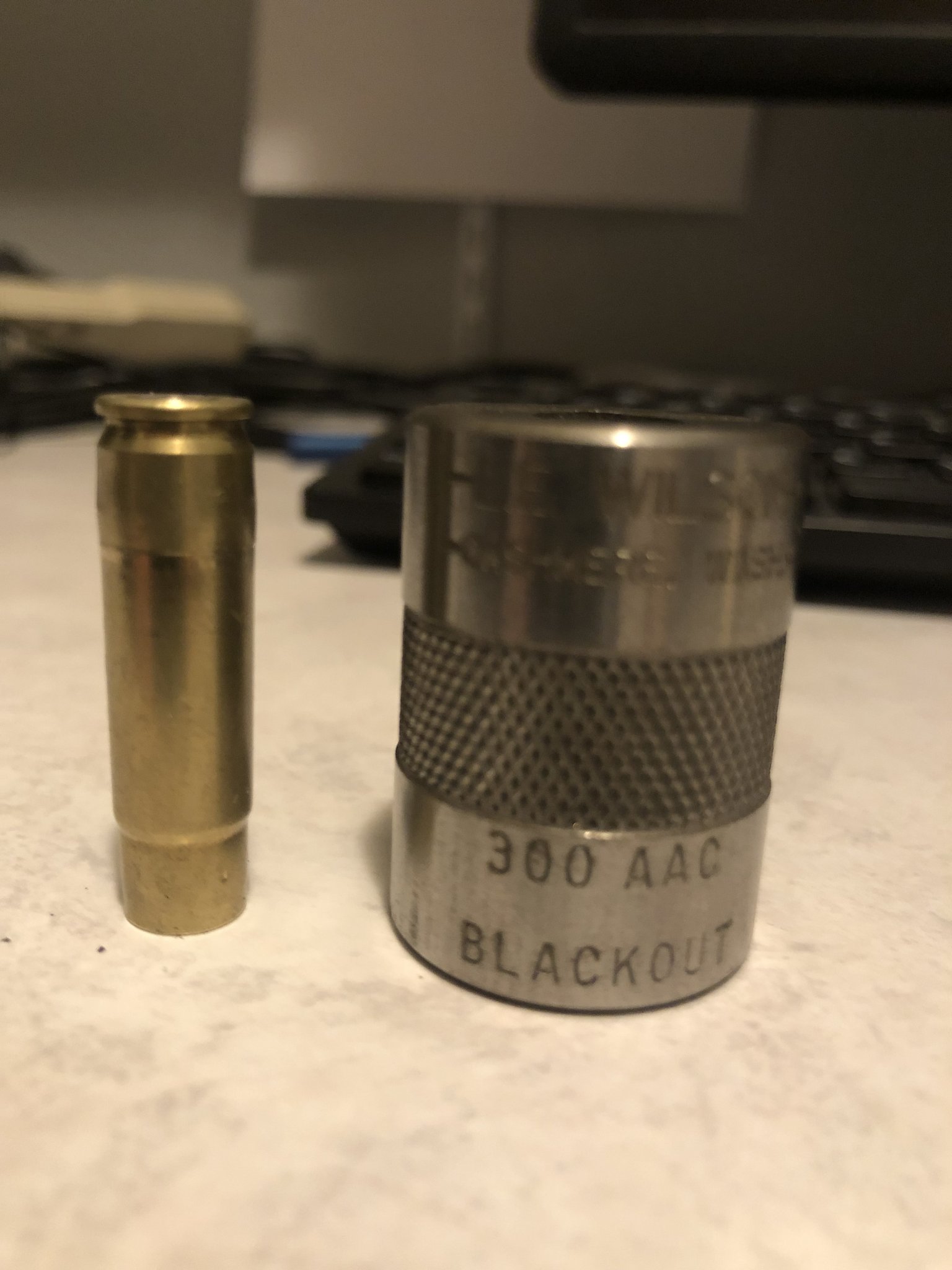

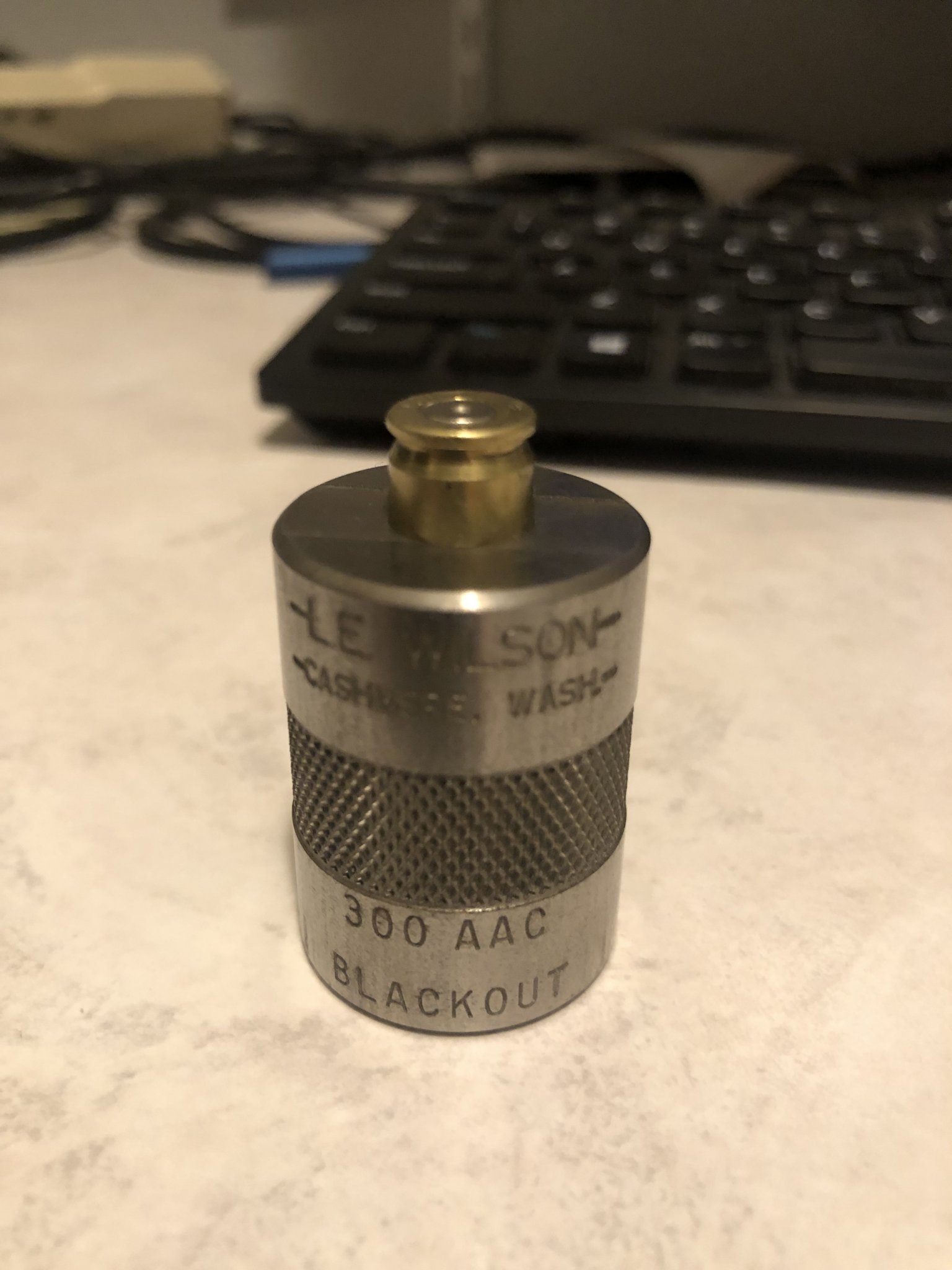

Could use some other opinions here please...

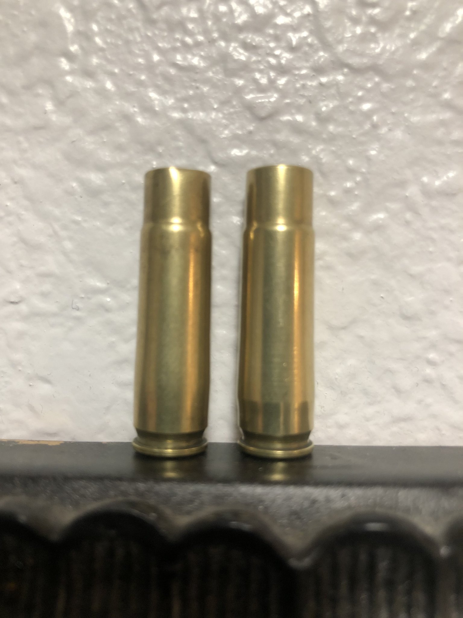

Against my better judgement I bought a PSA 300blk upper as my buddy swears by his. Already have a BCM that's been good but wanted a 1/8 twist for supers. Long story short, took it to the range yesterday and noticed something strange; the beginning signs of case head separations on EVERYTHING I shot out of it. (Some 90 rounds) Didn't matter if it was factory or my loads. MY BCM doesn't do this, I double checked, cases fit right back in my LE Wilson gauge after firing just fine. Not so witht he PSA. So what do you think? Out of spec chamber or what am I missing here?? Thanks for looking.
-Case on the left is what all look like after shot out of BCM, case on right is what all look like after firing through PSA
I'd think wildly over gassed for your recoil spring/buffer combo or possibly a bad chamber.

I'd say most-likely chamber is out of spec, but as was pointed out, wildly overgassed and incorrectly weighted buffers can also cause some similar/weird issues with AR's. But in this case, i'd put my money on a bad chamber. Have them swap in a new barrel (that they've physically checked the chamber on before install), and a new matching headspace bolt, and you should be good to go.

Just got back from the range. Ran this upper with the lower from my BCM 300blk. Ran it with the same bolt and then with the bolt the upper came with from PSA. 3 different kinds of factory ammo and then 3 different handloads. All had the same result; this chamber is out of spec. Pretty infuriating.
Thats what happens with a reamer that is held rigid and was not centered properly and ran in too deep. They really screwed the pooch on this one. Looks like the reamer was a little large in the web area as well. But that could be from reaming too deep.
Ask them for some brass you ruined. They are making brass and ammo now and i would ask them.
