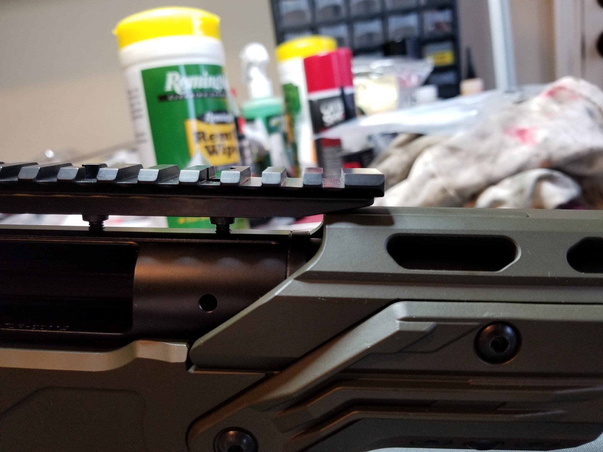

Second, the extended rail that comes with the Mausingfield action wants to occupy the same space as the barrel tube on the chassis (in my case, the Cadex Lite Competition):
You'll either need to shorten the rail or notch the barrel tube. I chose to shorten the rail.

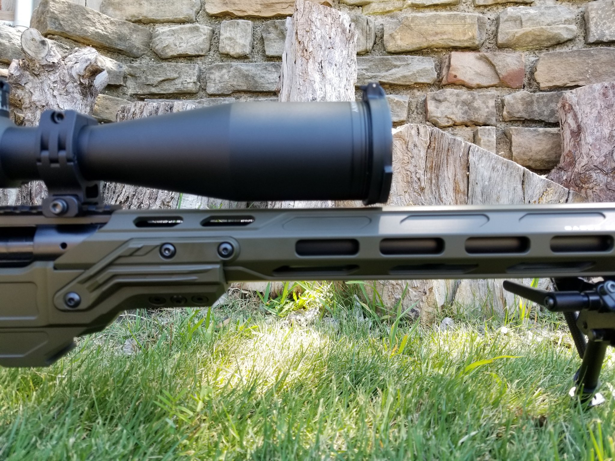

Third, I found that ARC "high" (32mm/1.26") rings will allow an optic with a 56mm objective to clear the barrel tube (assuming a 20 MOA base on the Mausingfield). It doesn't clear by much, but it's enough:

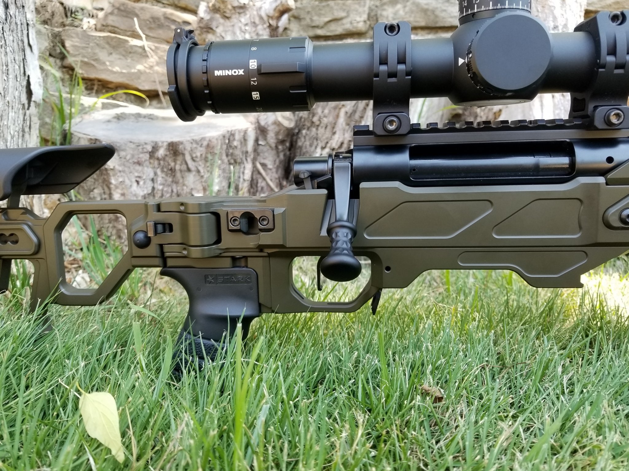

Fourth, the Cadex chassis offer a bolt handle cutout that accommodates a back-swept bolt handle, which the Mausingfield presently (again, May, 2018) does not offer. Fortunately, the cutout is large enough that the straight bolt handle clears everything without a problem:
Other than the findings mentioned above, there's nothing to report, which is to say that everything fits and bolts together as you'd hope/expect. The stock, when folded, clears/captures the bolt handle with plenty of clearance.

I just recieved my barreled action from LRI today. Long action mausingfield, they cut off the picatinny rail even with the recoil lug, and cerekoted, to clear the tube on the cadex field competition chassis. 30 inch bartlien heavy varmint barrel, bix'n andy tacsport pro 2 stage, 338 lapua cip magazine, everthing fits chassis perfectly.

Because a new rail is $150, while getting the included rail shortened and Cerakoted was $80. As for the JAE, it only took ~6 weeks to get my Cadex chassis, and on top of that, it folds. :)

Is yours a long or short action. I think they only make one length for the longs. It was only 50 dollars to cut off and cerekote, and certainly faster than getting another one, if they make 2 sizes for longs.
