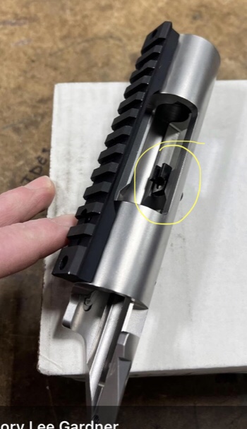

I had picked up a PT &G 40x from them last month. I'm curious if anyone else is having a ejecting issues with theirs. The bolt body does not seem to lock up when it is shut on a live round. It still seems to roll around quite a bit and I believe it cants enough sometimes that the ejectors can't grab the round. I have tried several different types of ammo. Can anyone send me a picture of the bottom of their bolt a close up please.

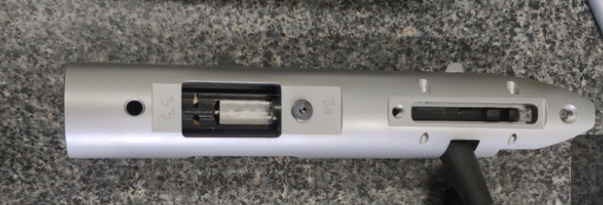

Ok , not my pics and I don’t own one of these ,,,,, yet , but , does your action have the ,,,,,,, bolt guide ? I guess you would call it ???, on a single shot it’s longer and goes all the way to the barrel /breech face usually called a loading tray
Pictures in this thread and people to ask that own them
