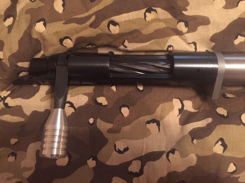

Just went into my FFL to start the CA wait on my PTG overstock blueprinted action combo. These actions were available for $399 with a "mystery" complete bolt that you only were allowed to spec the bolt face on, no other features. I paid an extra $30 for a 223 bolt face bolt. The bolt ended up being a blued straight handle, with a round knurled knob, a Sako style extractor, factory style bolt shroud and I wasn't able to pull the firing pin to check and see if it was fluted or standard.
The bolt fit the action on the tight side for sure, I don't think it would make a good candidate for cerakote. The face of the action either wasn't squared, or they put some cold blue on it to seal it up a bit, and I'm leaning towards not squared. The lugs APPEAR like they may have a little work done to them, and as talked about in the Scout thread, the threads, raceway and base screws were untouched. Overall for $429 it appears to be a pretty good deal. I'll be using it with a BugNut Rock Creek Sendero contour 20" 1-8x barrel in 223 as a reasonable priced training rifle. I'll pull the trigger and put it on eBay for a $20 recoup on the initial investment

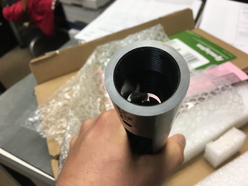

It is a blued receiver and not the matte finished SPS, the face and lugs appear to have been trued and blued, there is absolutely no play in the bolt as it travels the raceway, it has a M16 extractor, the bolt knob is loosely installed which is good because I intend to replace it, also has PTG enhanced firing pin, and it has an Xmark trigger, that will get tossed as well.

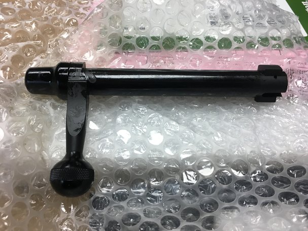

Finally got to pick mine up. Straight handle, aftermarket shroud it looks like. Sako extractor. It is a tight bolt/action fit, I was planning to cerakote it but now I think Ill just leave the bolt body alone and do just the knob/shrould and exterior of the receiver
. [IMG2=JSON]{"data-align":"none","data-size":"full","height":"617","width":"823","src":"http:\/\/i.imgur.com\/EZxGl4a.jpg?1"}[/IMG2]
Ball knob should be easily replaceable but I think Ill give it a whirl first to see if I dont mind it once I get to using it. [IMG2=JSON]{"data-align":"none","data-size":"full","height":"714","width":"536","src":"http:\/\/i.imgur.com\/TrzIzgx.jpg"}[/IMG2]

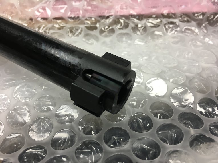

I dont have any calipers on me here at work to measure but it looks to my naked eye like a small firing pin so my concerns that drove me to 6xc instead of dasher may be for naught.
Edit: my calipers measured the pin at .075 so its the large and not the small. Just looked smaller sitting in my office. [IMG2=JSON]{"data-align":"none","data-size":"full","height":"649","width":"632","src":"http:\/\/i.imgur.com\/v4pdQYK.jpg"}[/IMG2]
Mine doesnt show any raw material like the OP so they either didnt true it or threw some blue on it as hypothesized above but I would say they didnt true a thing on it. Looks identical to the exterior of the action
EDIT: On accurate shooter Dave Kiff of PTG said that they will reblue them after truing so Ill take his word that that is what happened. [IMG2=JSON]{"data-align":"none","data-size":"full","height":"636","width":"644","src":"http:\/\/i.imgur.com\/OytpywW.jpg"}[/IMG2]

Congrats on getting a fluted bolt body. I am with you, even though they are saying they squared the face and cleaned up the raceway, im not seeing it. I have 3 coming in right now, even if they weren't touched up, with a PTG bolt and rail for $420 you couldn't beat it.
I had forgot that the fluted was extra to ensure you got it. I am pumped about that now, I was in the mind set that it would be more likely than not being an aftermarket bolt so I sort of expected it but in your first post it's not. Agreed, upgraded extractor, flutes, threaded bolt handle, hard to beat.
I do do wish that they had left them in the raw if they actually did touch them up though just for my own confidence. It is hella tight and the bluing on the bolt is already rubbing off a tad more than I expected.
Throw some grease on those lugs and just run it. It will wear where it needs to wear and smooth up. I just got my SPR BugNut 223 barrel tracking number, can't wait to get it here and put the first one together.
